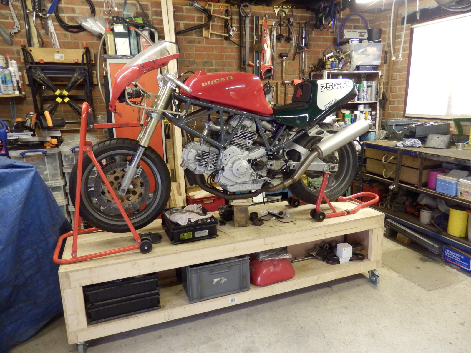

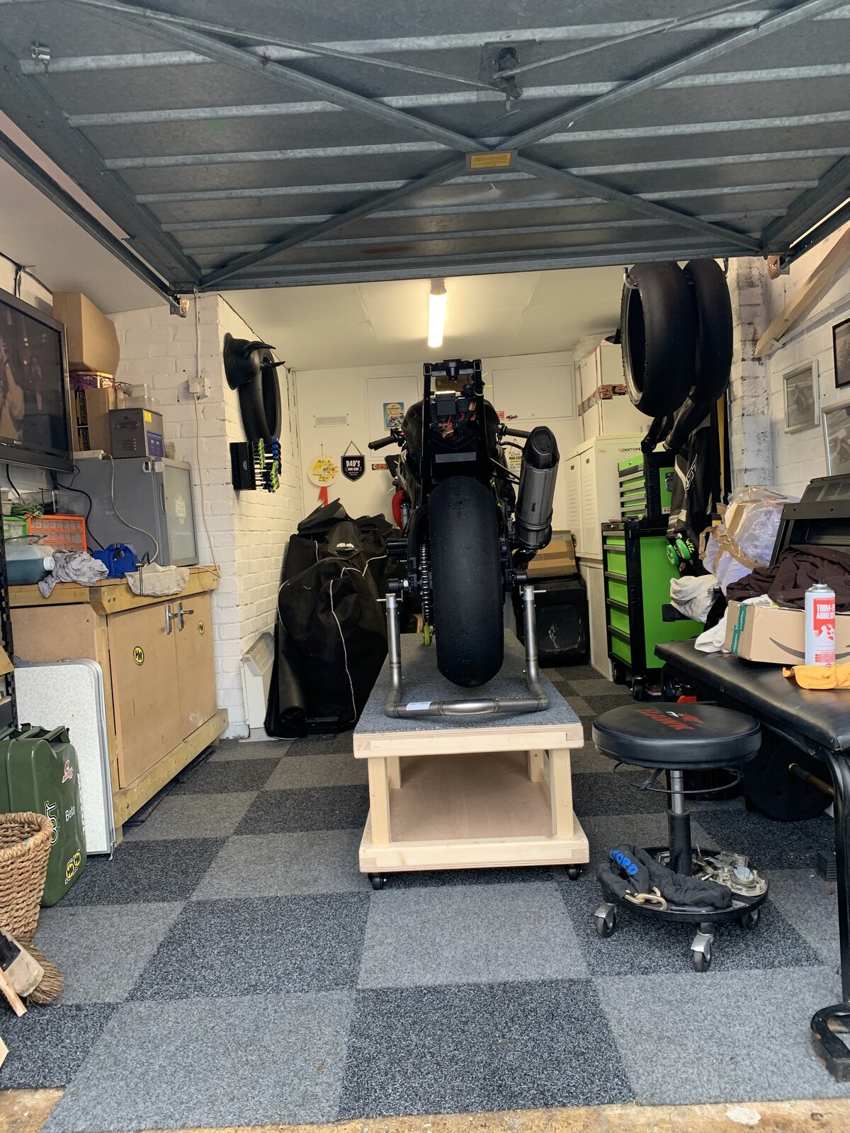

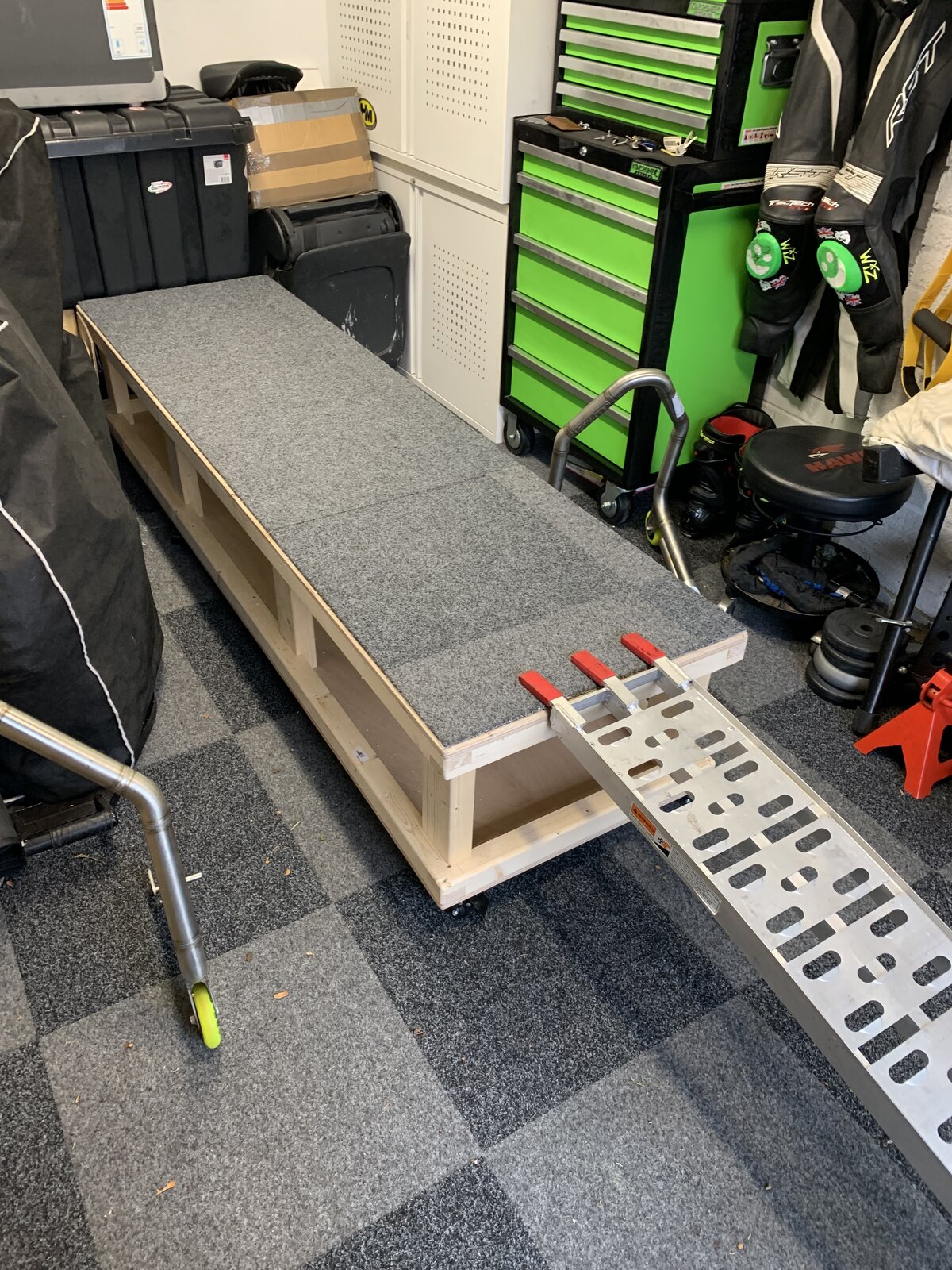

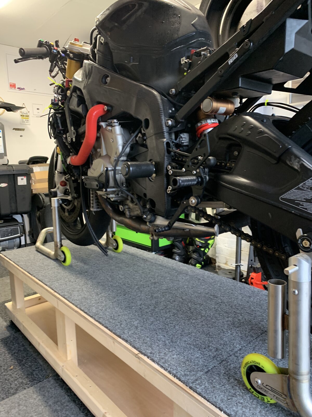

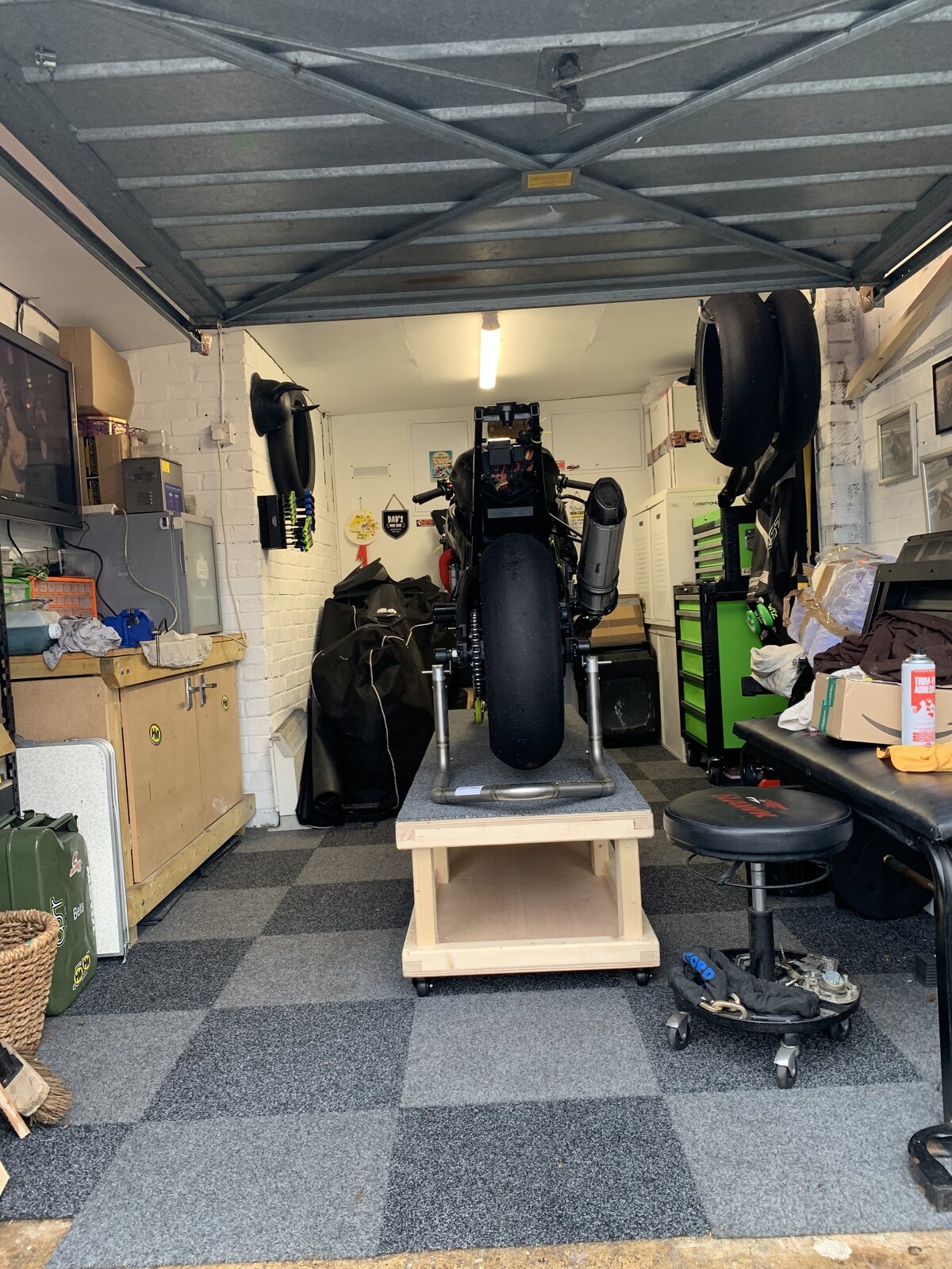

  1. I used to use something similar I built years ago.
    The advantage is the huge amount of storage underneath, but I couldn’t now be without my lift bench.
    It’s so much easier to put a bike on and off, The adjustable height is useful, and I also use it for other projects like when I’m building sets for Lady Nasher’s school plays.
    And if I’m really stuck for space I can move it over to the other half of my garage and park my Discovery over it.
    I do however still have the Wooden one in storage should I need it.

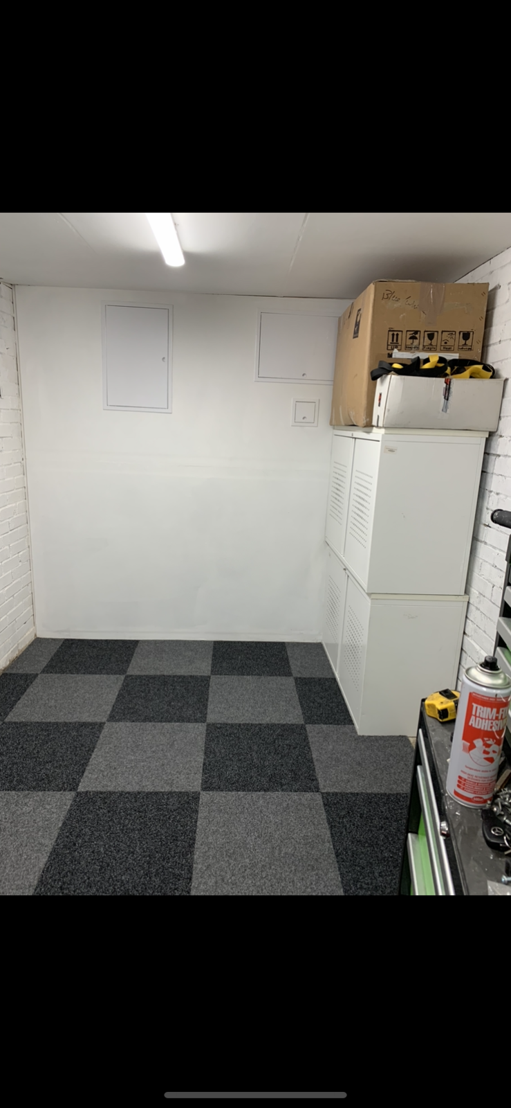

    I’ve had a message form another member on here regarding my posts about lighting and power sockets. I Assume they don’t want to ‘get involved’ in public.
    I’ll mention here that of course you can’t just go adding additional lighting and sockets without doing it properly.
    I’ve installed a separate consumer unit in my garage, fed from a separate breaker in the house consumer unit.
    It has separate fuses for the Lighting Circuit, Power Ring Main, My Lathe/Mill, Plus a separate Breaker for the sockets I use for welding.

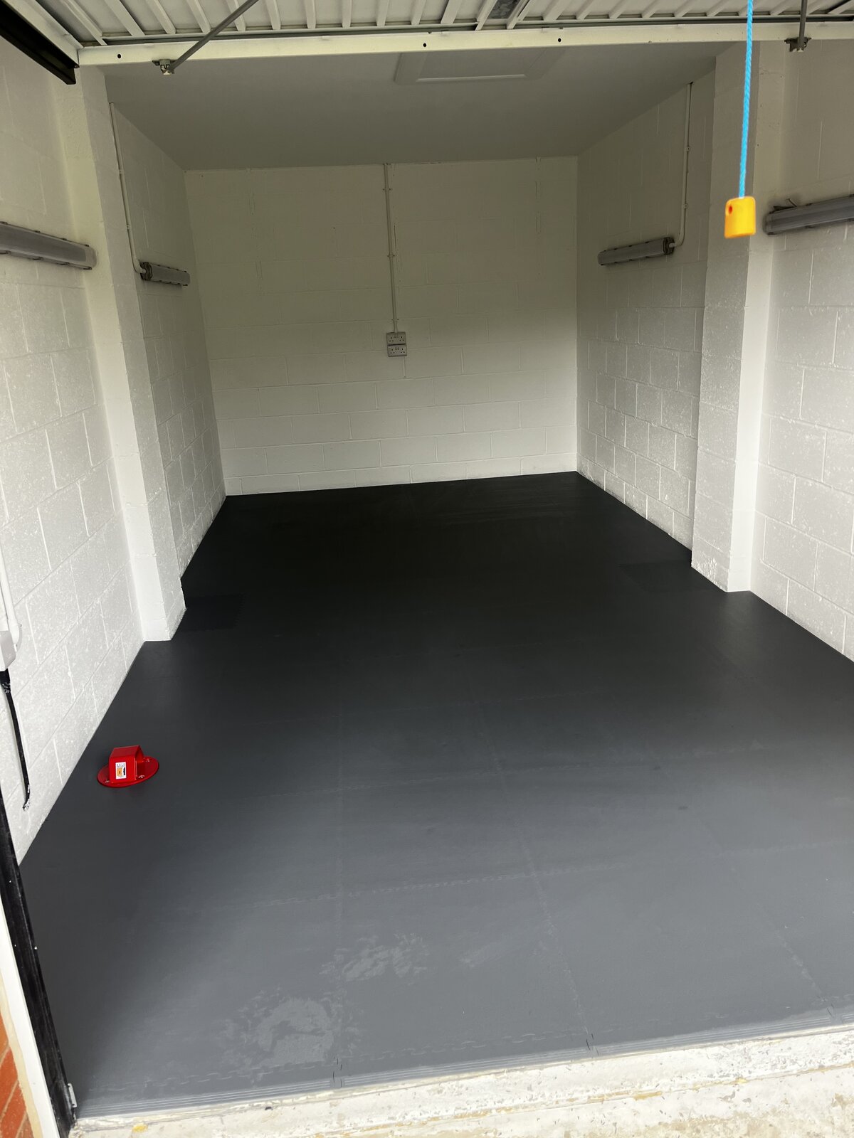

  2. I’ve gone with Duramat flooring which I’m really happy with. It was a bit of a pain to fit but I think it was me that was the problem lol.

  3. The other good thing about a lift bench of course is that you can be creative when doing things like completely removing the front end.
    Lift it a bit, support it, then drop it a little to support the weight.

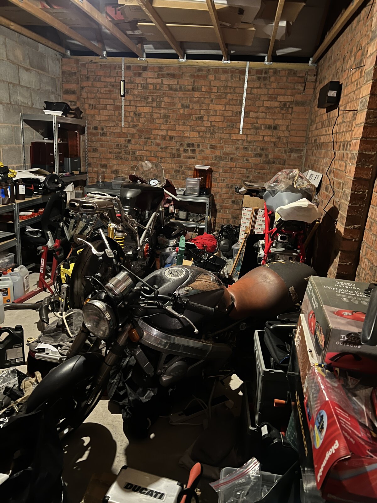

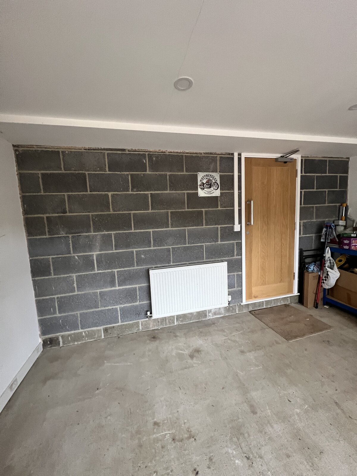

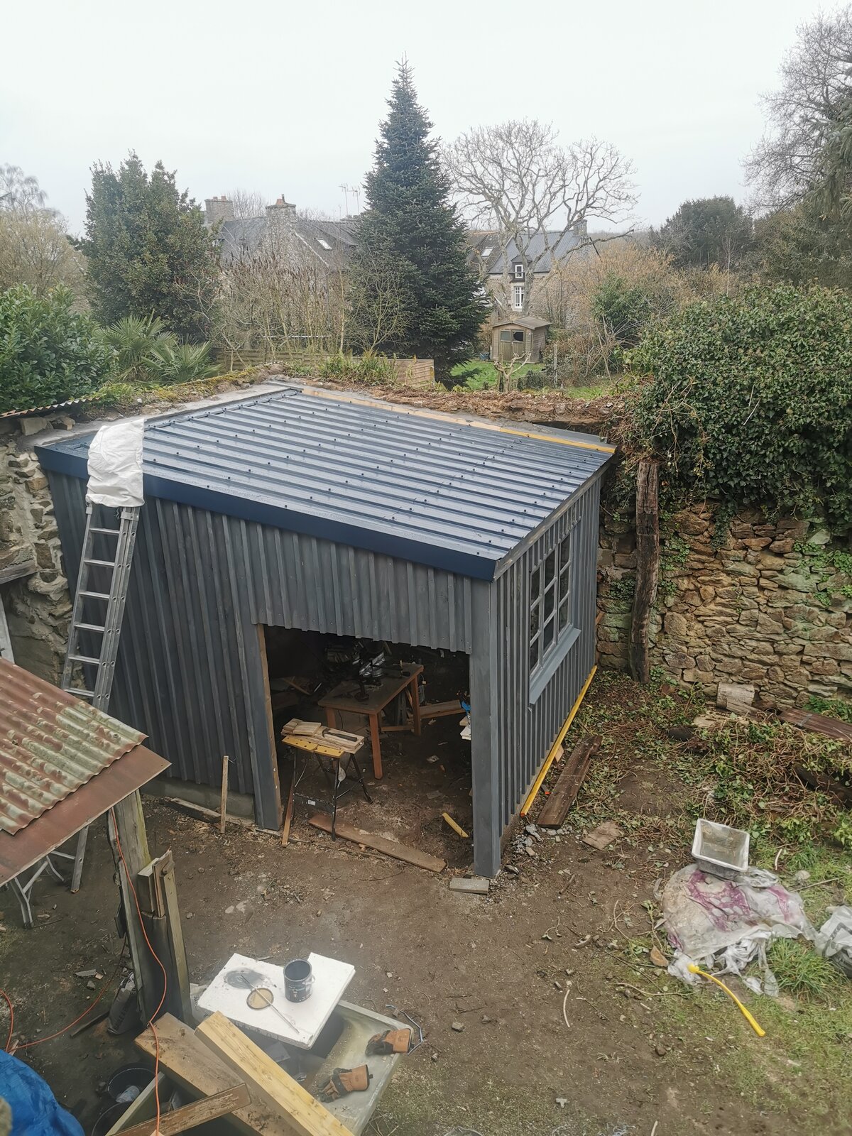

  5. I hate these threads - I'm always perfectly content with my garage until I look at them and then collapse with garage envy.

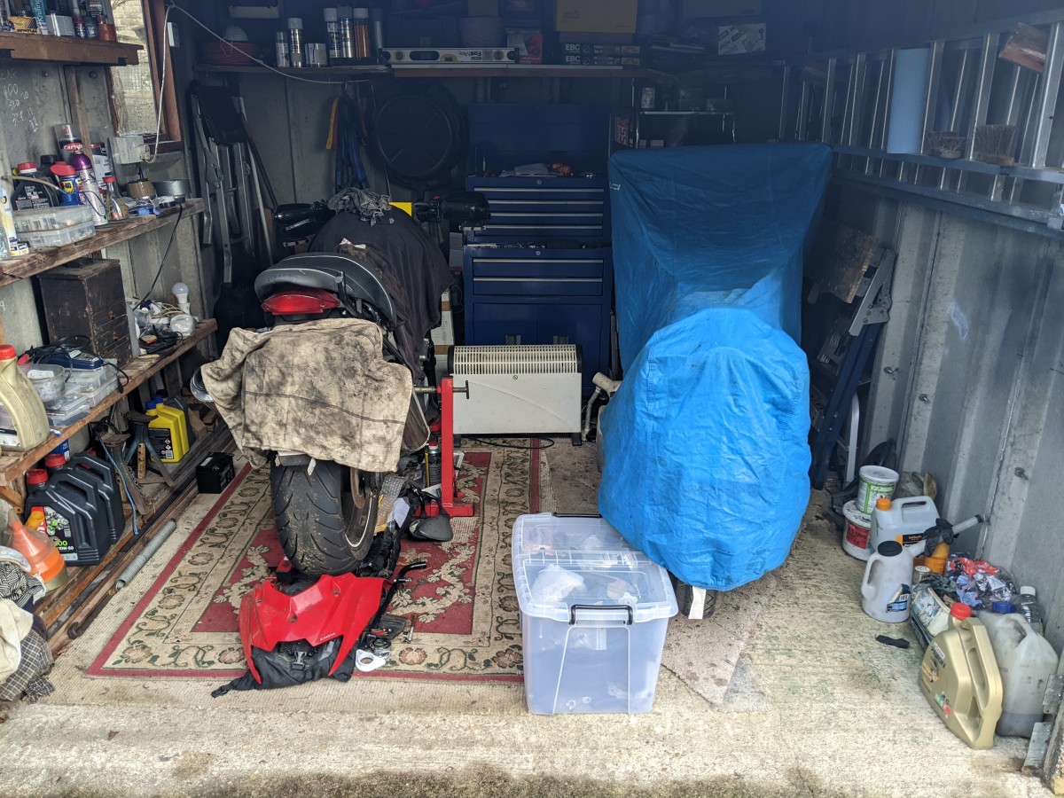

  9. Id love to have a garage again. My bike lives in a lean too and shares the space with a leaking roof...

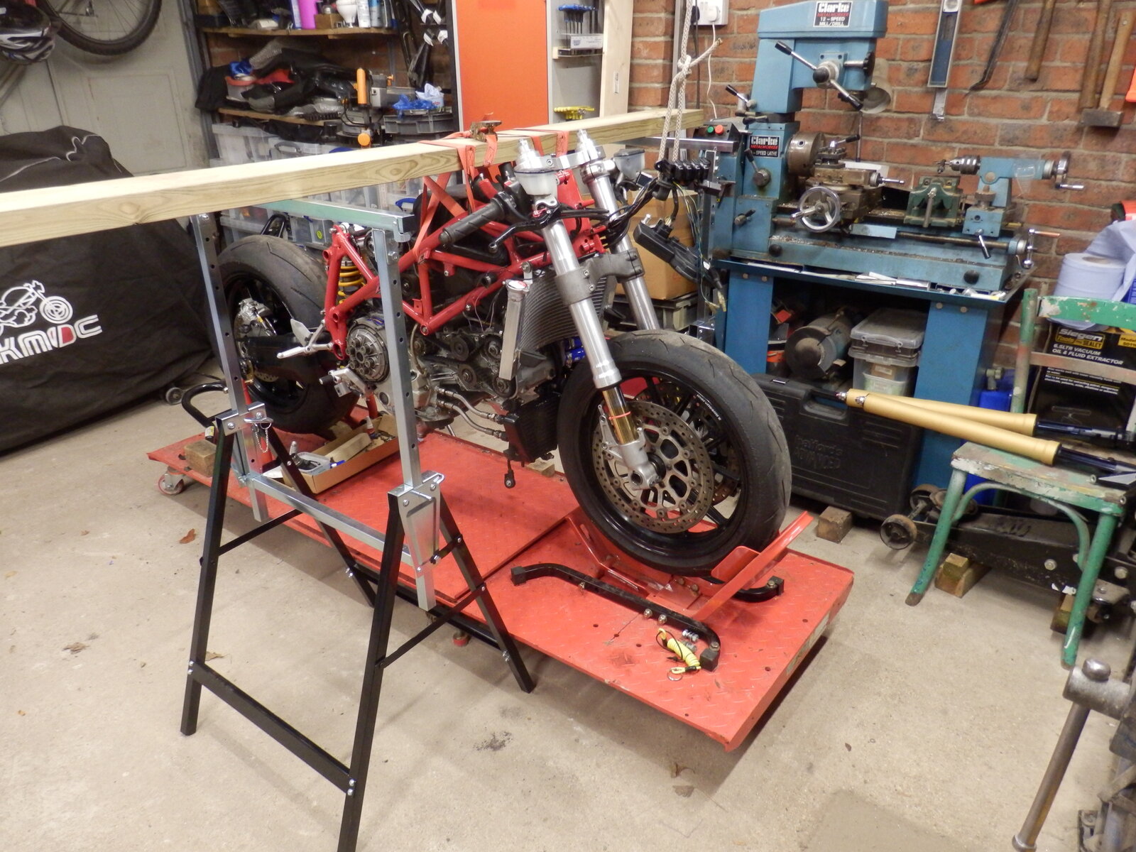

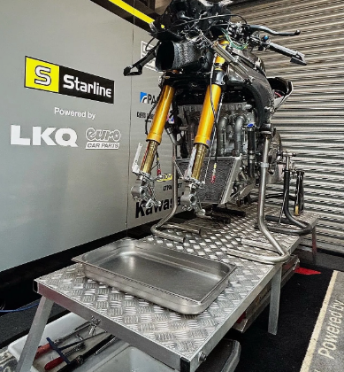

    from alikat on ebay. interested i the supports other than the rear one - what do they connect to?
  13. Hi. Not sure I know what you mean but you can use either use a headstock front stand or a normal front paddock stand for under the fork leg bottoms. Hope this helps

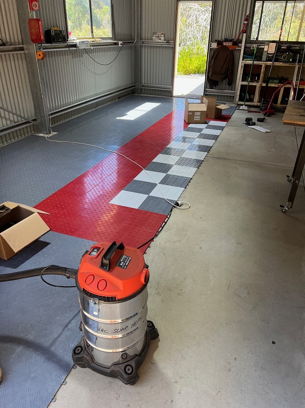

  15. We relocated just over 2 years ago and the reasonable sized shed looked pretty good at first glance....until you parked a couple of cars in it. All my bike crap (and more) was piled on shelves between cars and lining the walls which made for some interesting limbo-type moves getting in/out of the vehicles, with my work area a narrow strip at the end. You always grabbed 2 beers from the fridge 'cos you'd finished the first by the time you completed the obstacle course getting back to the door.
    We finally sorted some new accommodation for the veehickles and I could run amok with the old shed.
    I had the shits with the slightest dribble of anything bar water staining the concrete so went for solid plastic floor tiles. The concrete slab has a slight amount of efflorescence in Winter, so trace amounts of moisture, which limits options:
    My good lady very much enjoyed belting/locking the tiles together, with my name muttered more than once under her breath. It's quick stuff to lay, only the trimming in takes much time, we knocked out the double garage in a day and a half. Worst part was moving all my crap around to clear the floor.
    Doorways/edges can be easily/nicely trimmed:
    And when you've finished trimming in around the framework etc it looks fairly decent:
    No, I haven't really got this much room, but the space was soooo nice for the week it lasted.

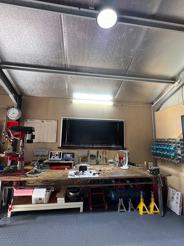

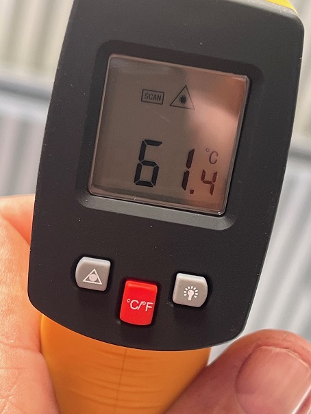

    The ball-sack was fair swimming in our Western Australian Summer (low-mid 30's degC in the Southwest)) with this sort of heat radiating off the unlined roof and North wall, but some radiant insulation (that bubble wrap/alfoil stuff) was fitted which made a BIG difference. That was improved again lining the North wall with 19mm chipboard flooring, it's as cheap as anything else (down here, anyway) and is stronger than most so you can hang shit off it even with minimal supporting frame-work. The North facing window heat was knocked out with a $25 venetian blind picked up in a 50% off sale.
    The repurposed ancient outdoor table, topped with offcut flooring is proof you get exactly what you pay for (cost $0): it's so ugly....but it does the job. The lighting is better than it looks from the over compensated photo, with the cheapest Chinese LED hi-bay lights I could find that met my requirements = $25AUD each. There are a heap of online lighting calculators (lumens/sqm) and it doesn't cost much for a pretty decent result.

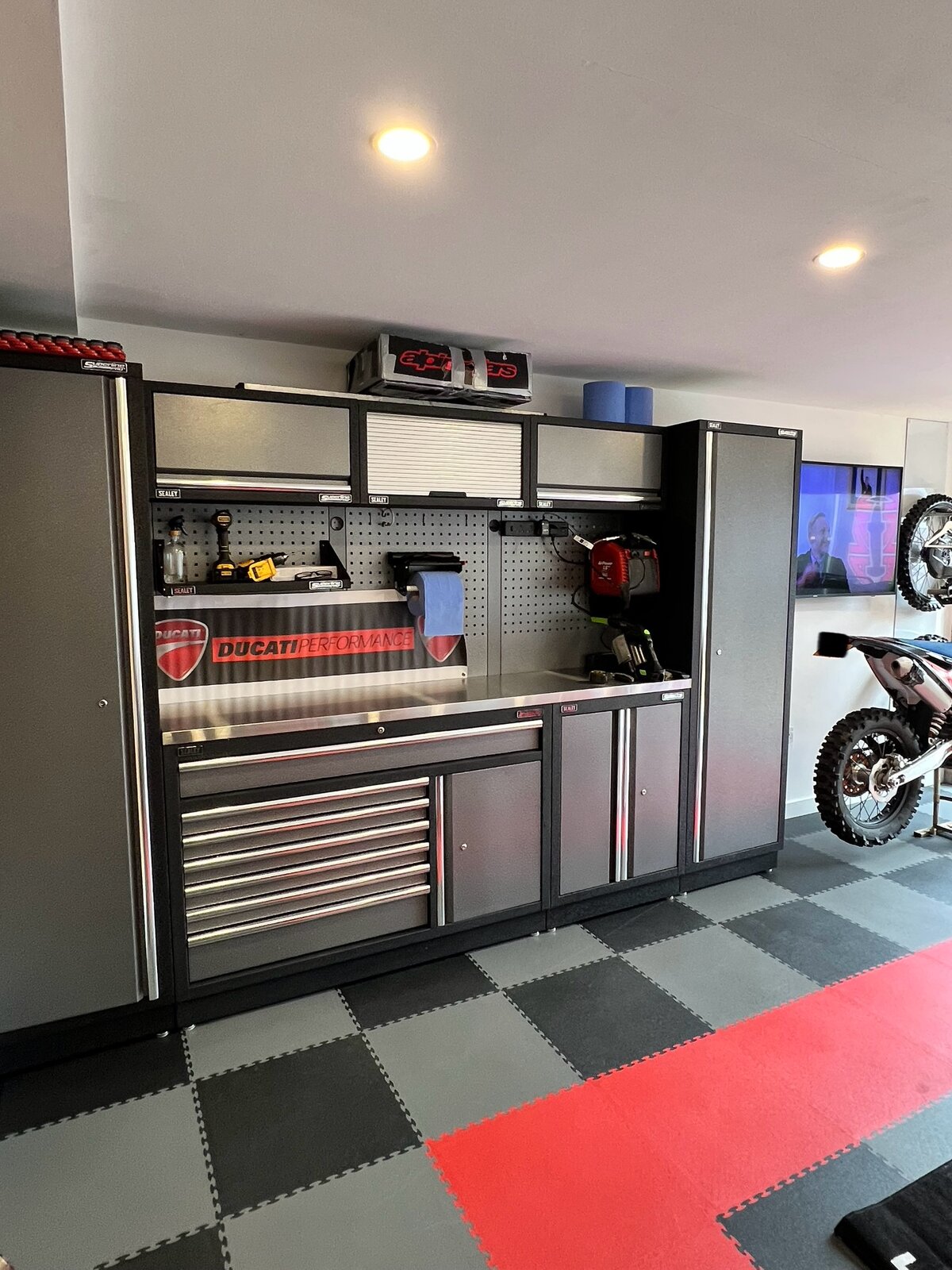

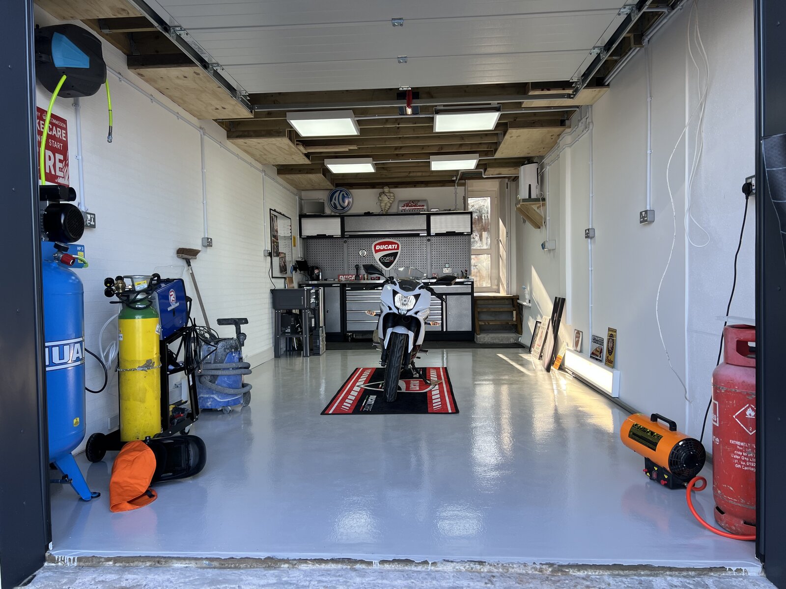

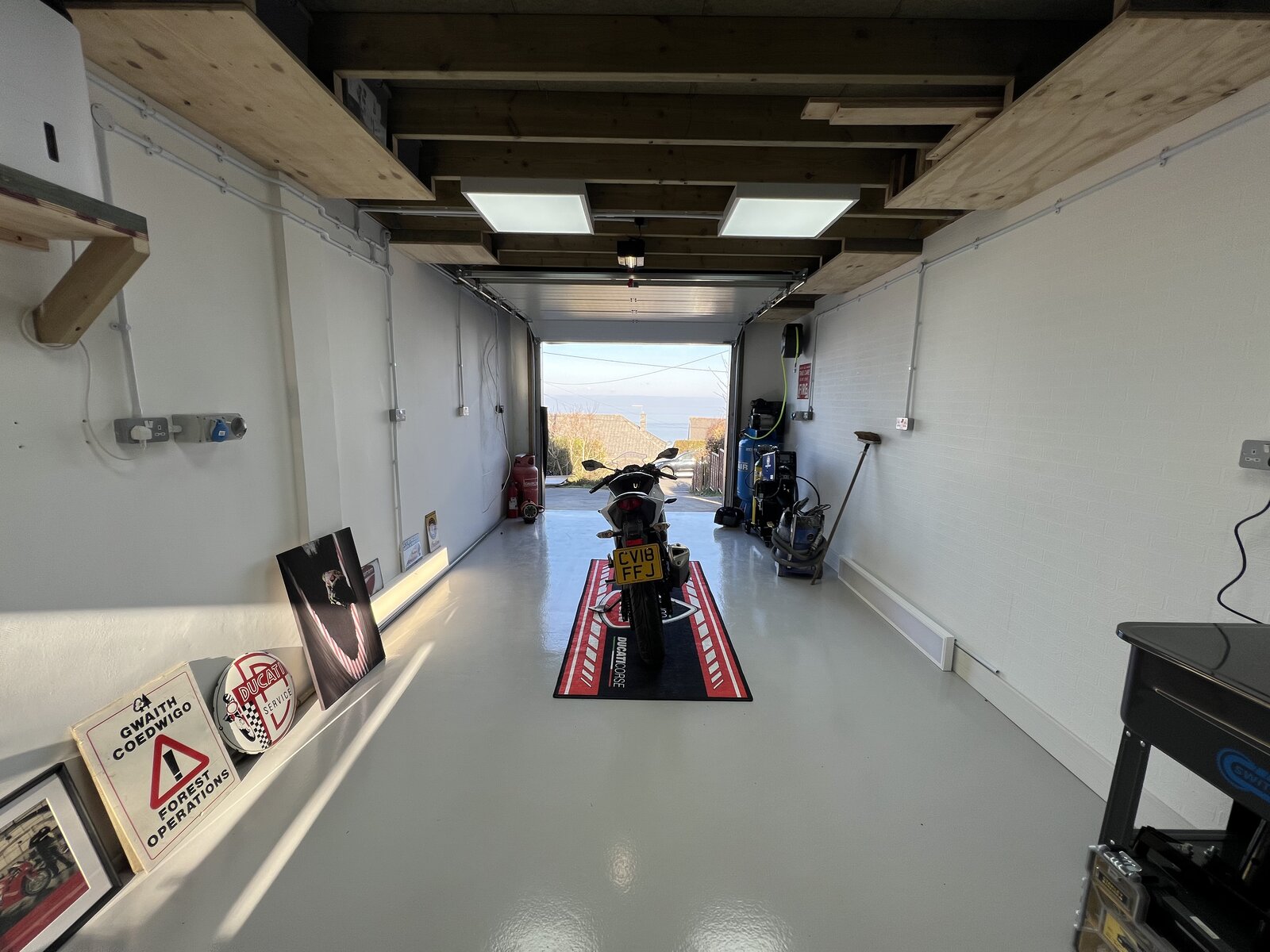

  16. Ive nearly finished mine and used Sealey pro modular units, they are expensive but hope they'll last until I die!!
    Power only just connected and still bit of fettling to do.
    I had priorities:
    1 Warmth - built with sips.
    2 Light
    3 Storage
    4 Space as much as I could - went to land boundary ended up 7.5m x 3.5m.
    Didn't just build this, there is a huge loft storage space above and new utility room up the stairs. I do like the resin floor - that was worth it.
    Retirement here we come !!!
    IMG_8740.jpeg IMG_8739.jpeg PS ignore the Kwacker its my sons bike.....

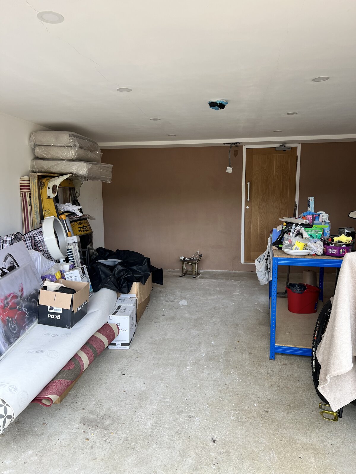

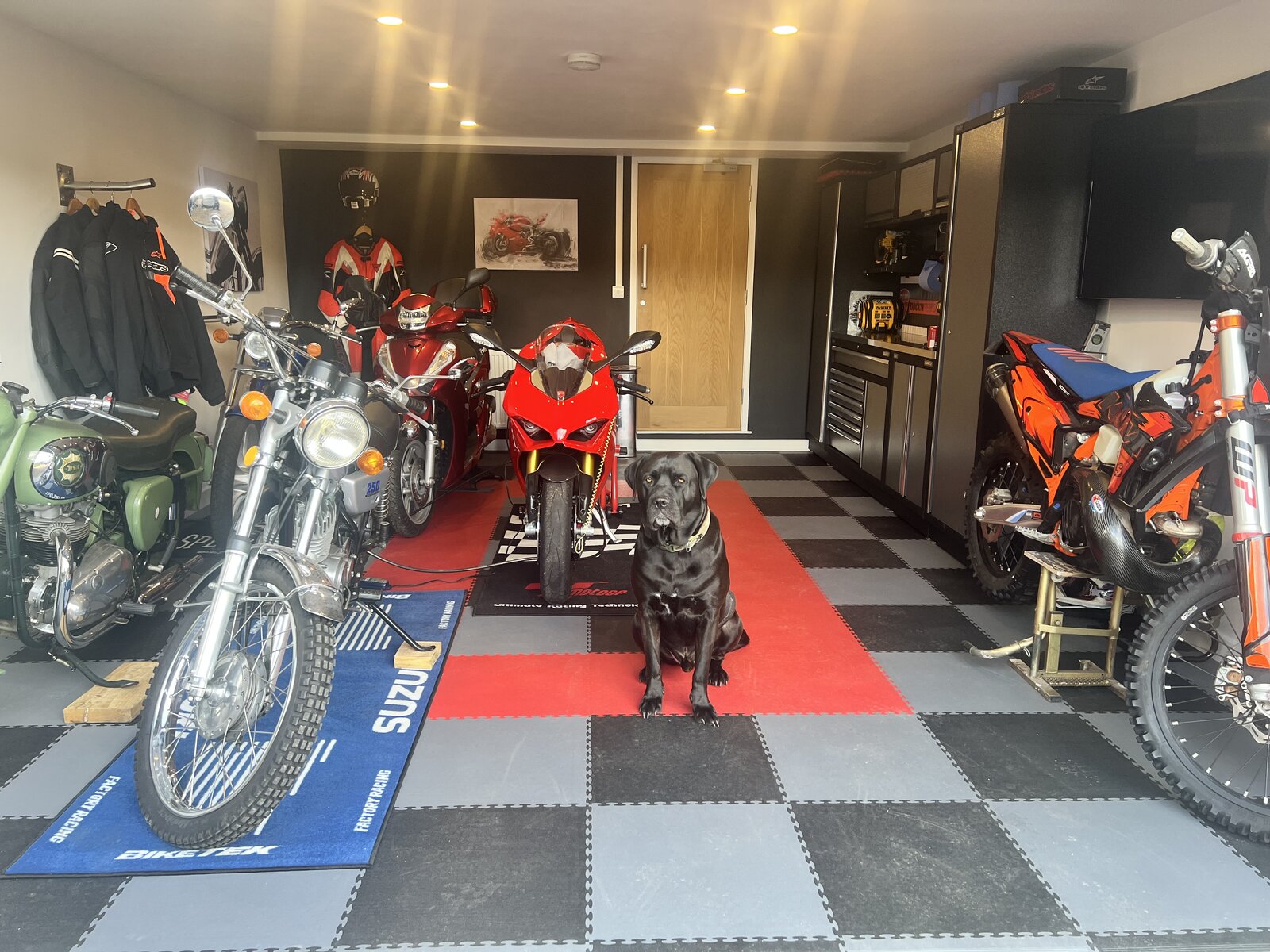

  18. Just want to say a big thank you guys - got my a*se into gear & I’ve finally started & finished (well almost) my garage refurbishment ! I’m pretty made up with the result
    New bike security system is killer
    Overhearing the wife mentioning to her friends that this garage would make a suitable yoga space was also a great motivator
