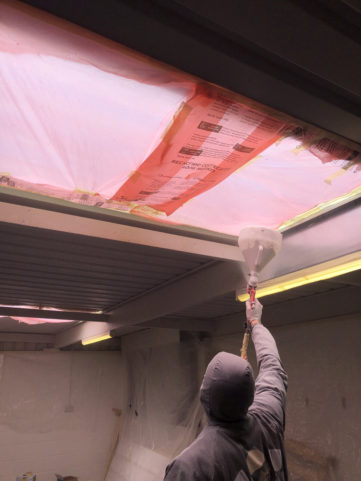

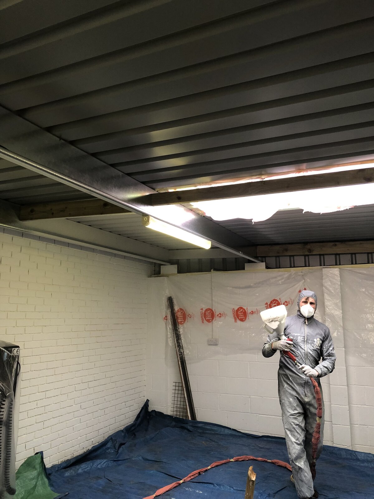

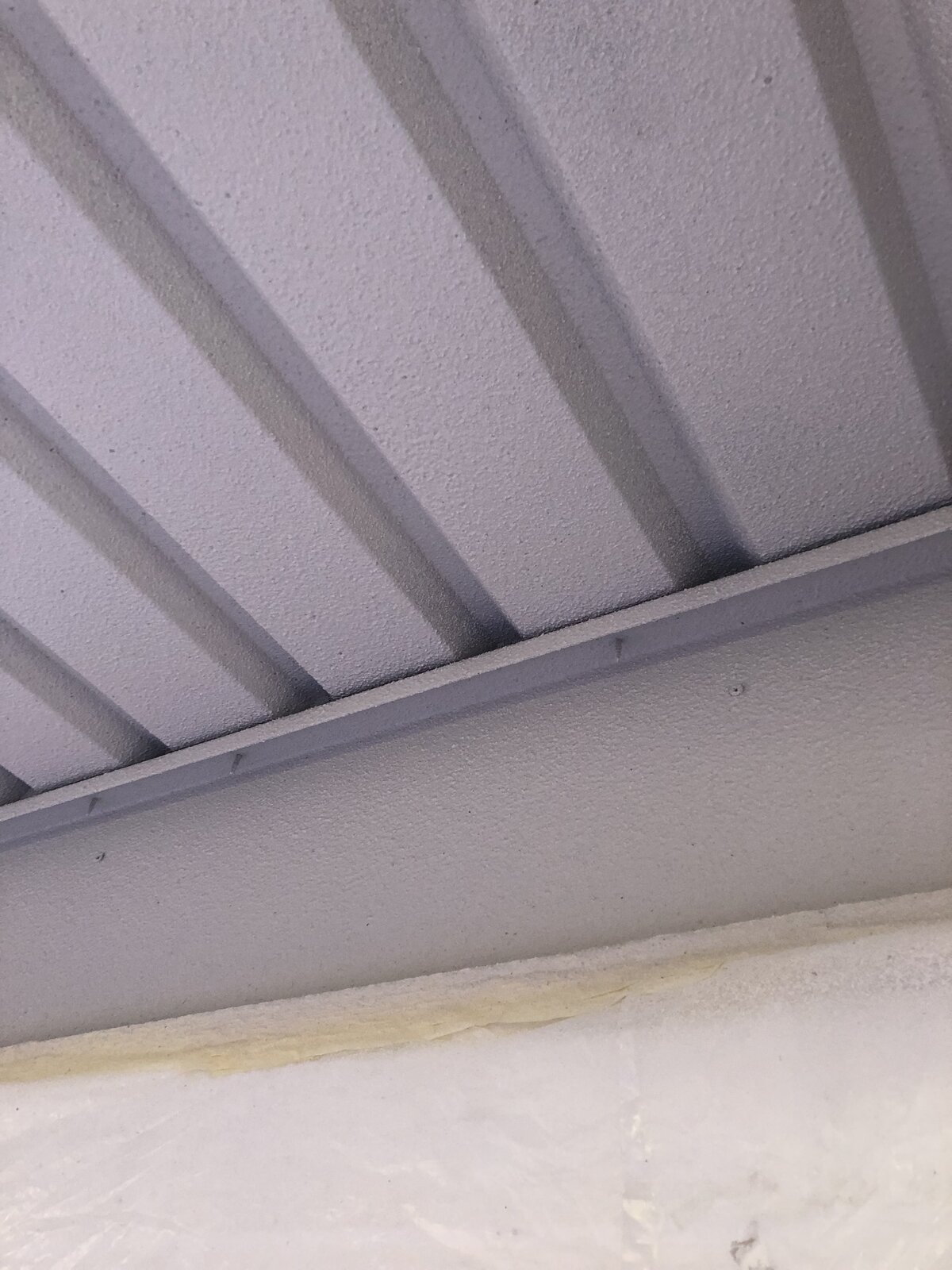

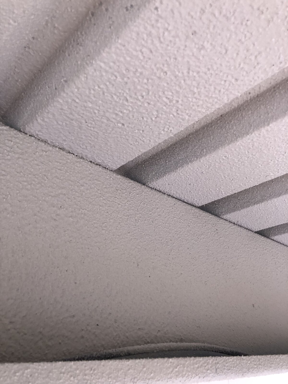

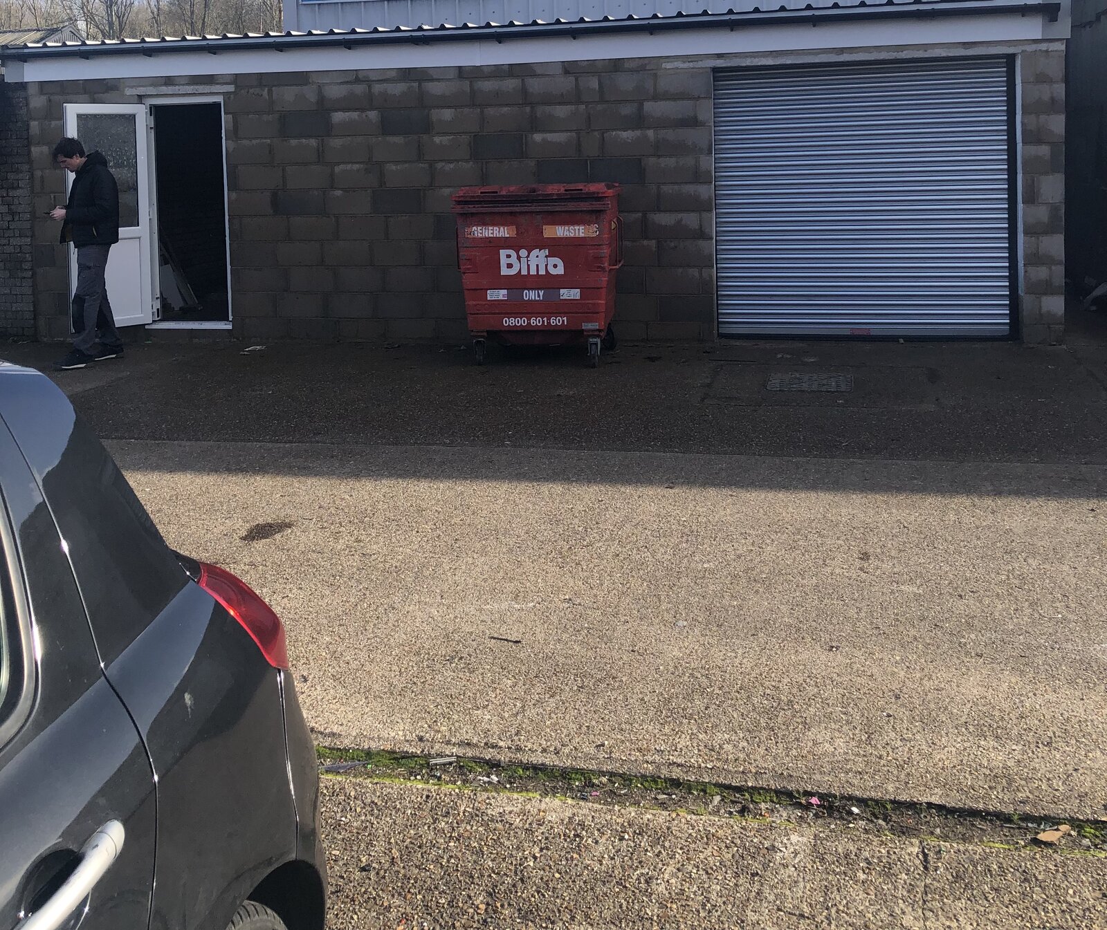

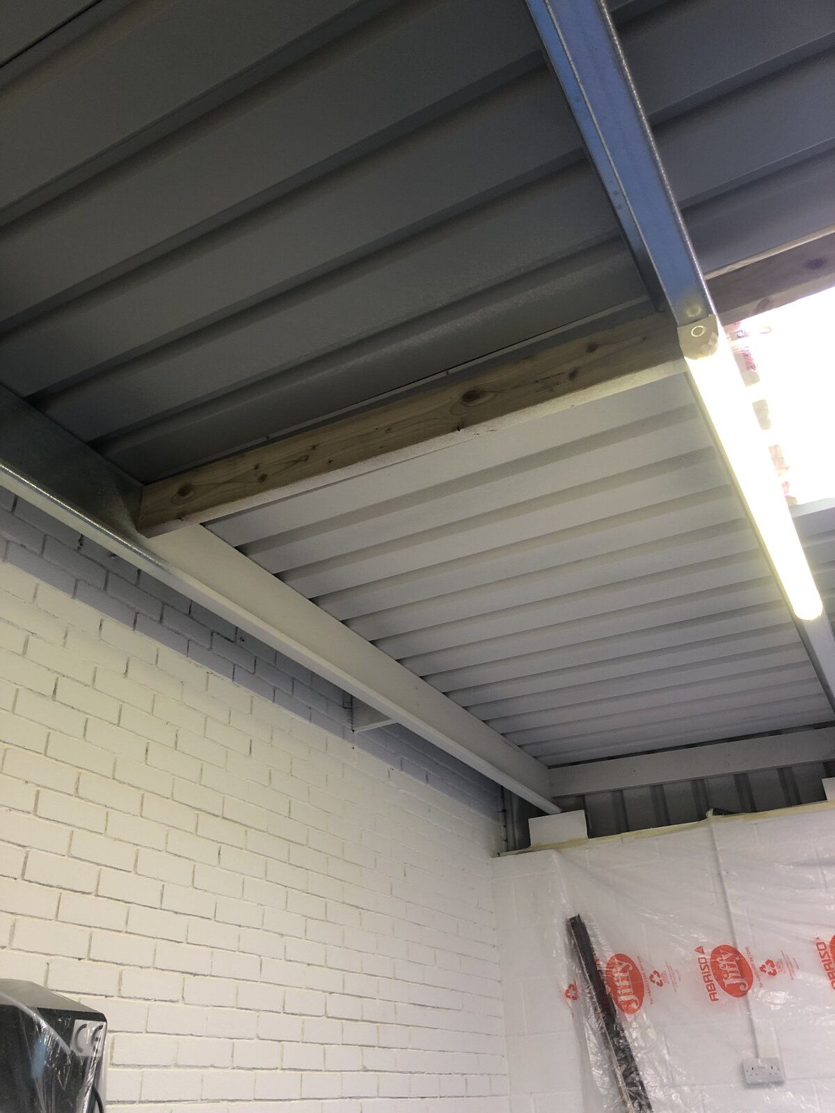

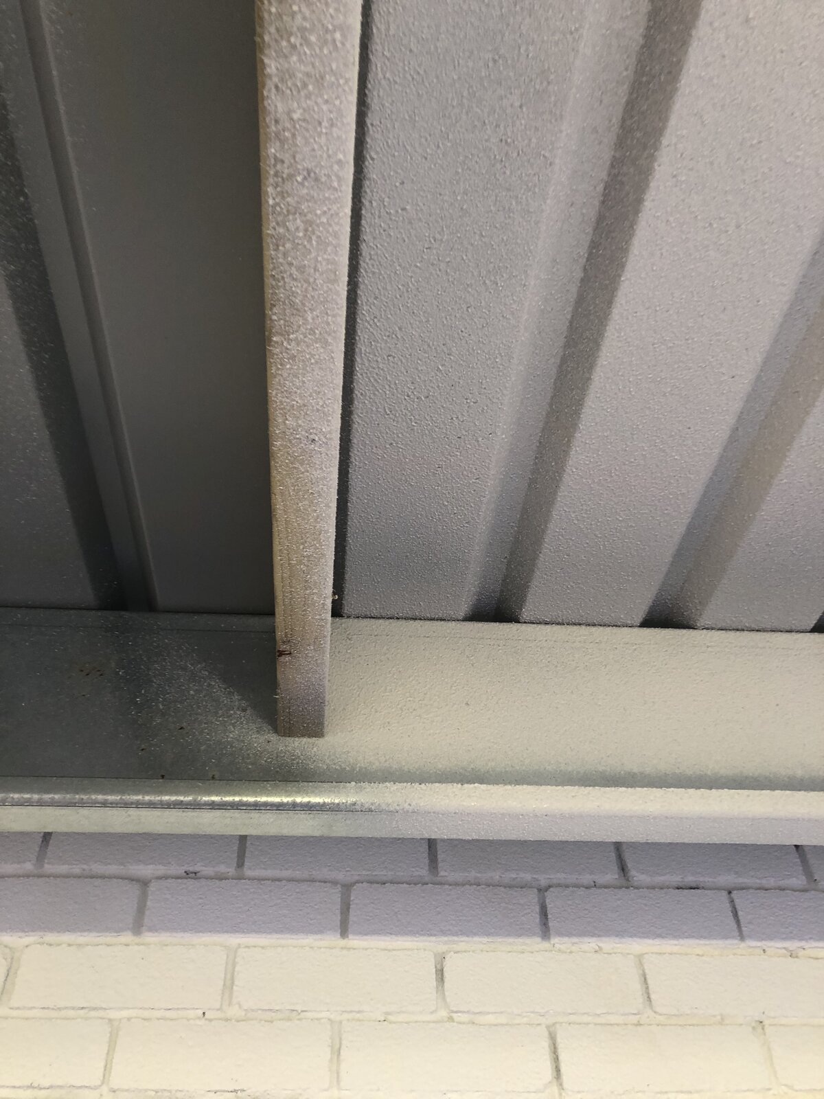

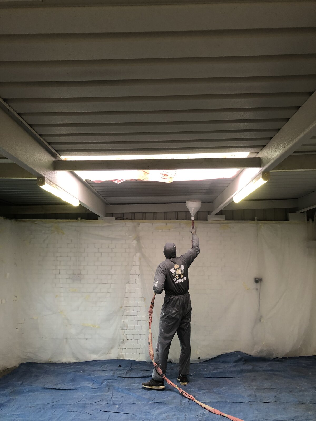

  11. To keep the cost down if building large and less complicated try and think more industrial materials, roof and side cladding (insulated panels) very quick and easy to fit if your ok using hand tools and get a firm to fit a roller shutter door, it also depends on the look if next to your house,
    My son and i did this on our industrial unit last year added 500 sq,ft Roof purlins are 9.5 meters long and we sprayed the roof and purlins in an anti condensation paint which acts like micro sponges and soaks up the condensation and releases it slowly when the temperature warms up not had any problems with any dripping off the roof (only a few drops of the clear window light sheets)
