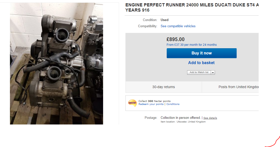

    I had a quick look on ebay just now and found this:
  5. I did see that for sale, but it's an ST4 rather than st4s, I'm guessing Id need to change other things like ECU to get it to work?
  6. That was just for illustration and there is a video available of the engine running.
    I haven't checked but are the engines different between the ST4 and ST4s? Isn't it just the suspension?
  7. Just checked Wiki and the engines are different. The ST4 has got the 916 engine whereas the 's' has the 996 engine.
  8. They are indeed. And it's sods law that the one I've got is the harder to find! Lol
  9. Swap over the throttle bodies and crank sensor and an ST4 engine should work OK in an ST4s although the fueling could be a little out as the ECU is mapped for the bigger engine.
