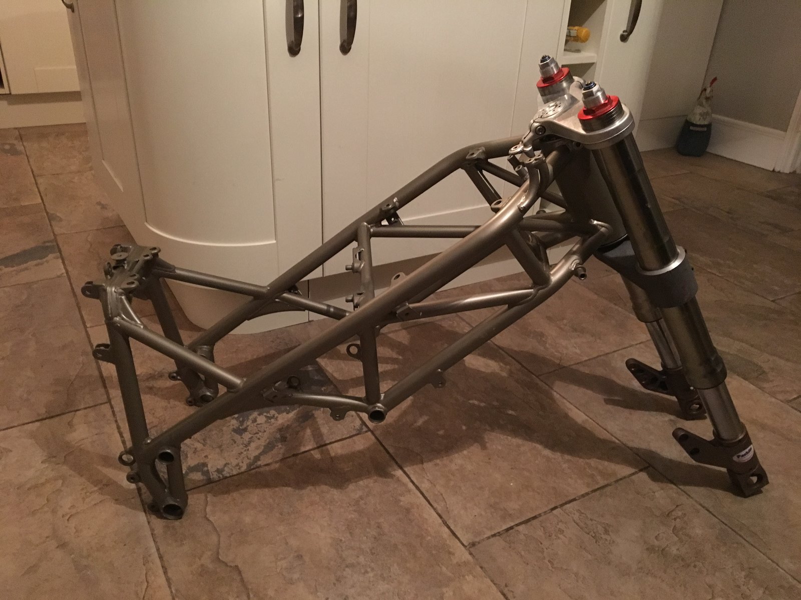

  17. Hi Tim, It so happens that I bought Dan's bike and am in the process of stripping it right down. Will your kind offer of the ST4 gearbox apply for me? If so I'll collect asap. Let me know your address, if OK.
    The bike is exactly as Dan described it, and it's going to be a long expensive repair, but...… I knew that!
    Dan, you bike is still lovely and has found a loving home with me.
    Regards,
    ST
  18. Excellent, hope you manage to get it fixed up and back on the road! I'd appreciate it if you could keep me updated when you strip it down and find out what actually went with it!
    Good luck!
  19. Sure!
    So far: drained the oil and it is MILKY, I wondered if there was water in the oil. A scary thought, but it'll be in pieces too soon for any rust to appear.
    ST
