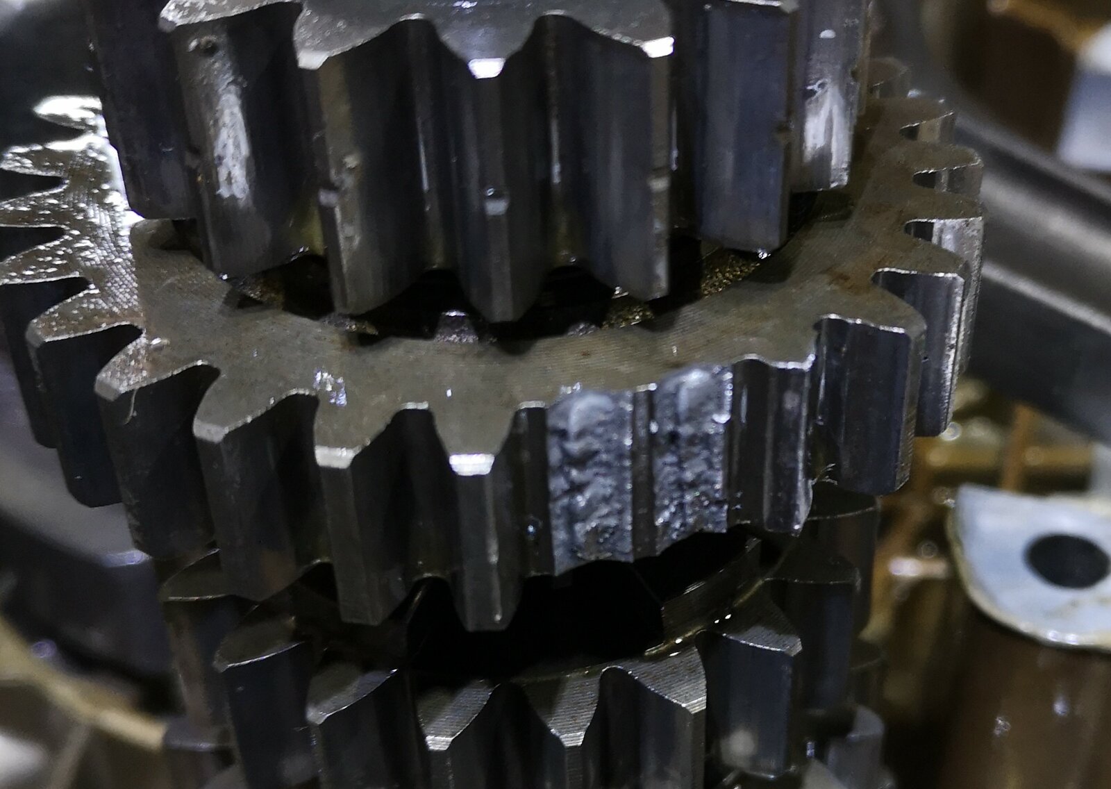

  5. Here's a picture of the broken teeth, its no wonder you had some serious noise.
    Now I need a gearset!
  6. Here's a picture of the broken teeth, its no wonder you had some serious noise.

    Thanks for your patience. Take a look a one of the gears, missing teeth!!!
    ST
  7. That would do it! Was that the only damage?

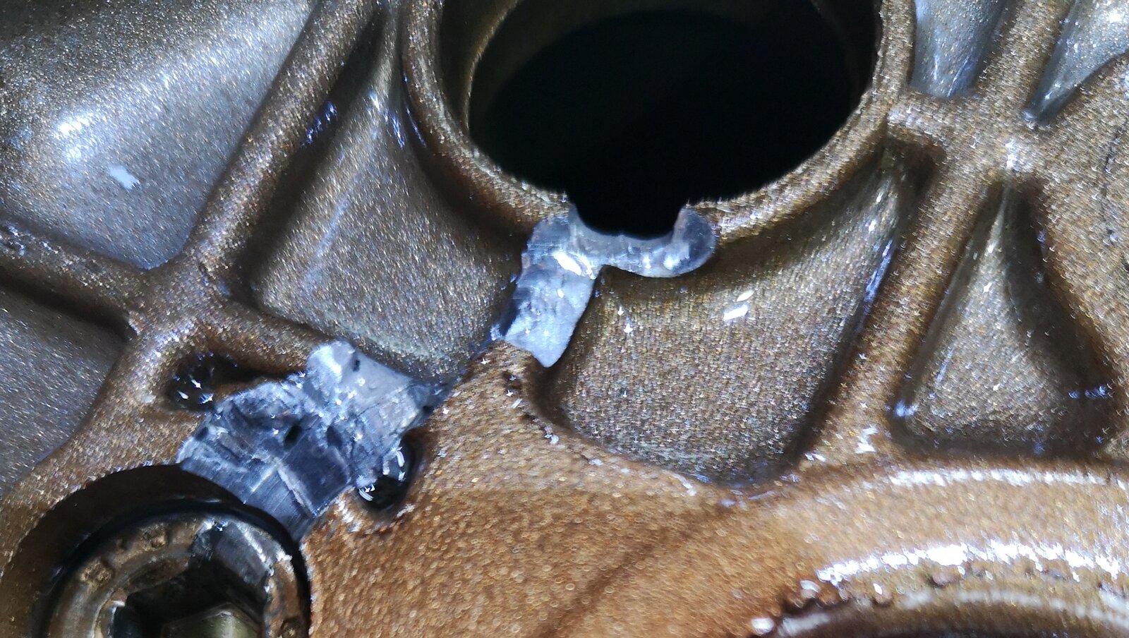

  10. Hey Dansrockin, I think the missed gear, which caused the damage was actually due to something else. i.e. NOT your driving.
    There was a huge scrape of metal due to someone trying to tighten the timing shaft incorrectly, which I think was ignored. Thus the problem was waiting to happen. Added a picture for you! Pretty sad, but on the bright side I have a great bike, I'm learning a lot and Summer is around the corner...……
