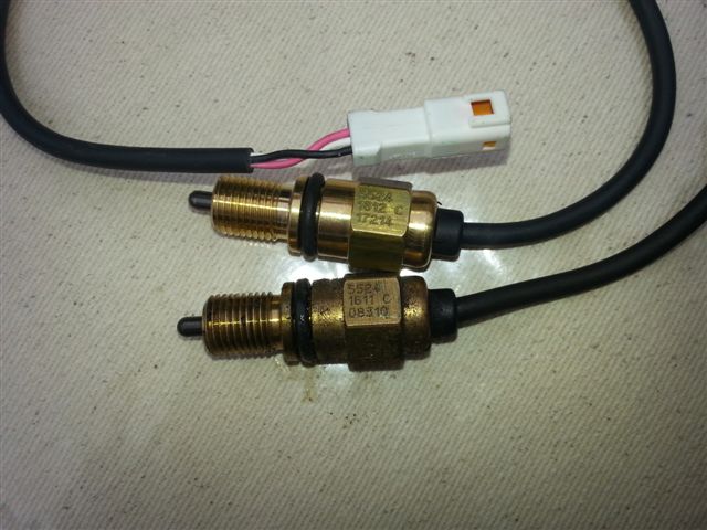

  1. Finally the gear sensor has arrived part number 55241512C.

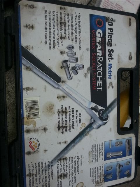

    Note: You need a special socket set or an Fuel injector type socket, as the sensor is effectively a bolt with a wire coming out of the top.
    We used a GEARRatchet by Vortex sourced from Halfords.
    You need to disconnect the sensor under the riders seat and cut the cable tie under the side panel, to get the wire/connector down to the sensor. By passing the socket over the wire and then the wrench so that it hangs in front of the swinging arm. Then undo from under the bike.
    Not easy and almost certainly very difficult if not impossible with most other socket sets.
    Operating the sensor out in the air - total travel on the nipple is 6mm.:Bookworm:
    Fully extended is First Gear, 2-3mm depressed is Neutral with the remaining 3mm of travel gives gears 2,3,4 and 5. Fully depressed is 6th gear.:Doctor:
    There is a tiny amount of wear, almost a polish on the old sensor nipple.
    Given that 3mm of travel is required for a 1-Neutral indication change this is not the cause of the miss-indication issue.
    IMHO either the old switch is breaking down with heat (as the fault only occurs when the engine is warm) or the other part is worn (I really hope not).
    12Nm of torque to put it back in, with a little oil on the o-ring.
    Static test...all ok.

  2. Ok....so last Wednesday I go down to get new sensor fitted at the same time 7500 service due which is another story one worth reading which I shall be posting under separate listing. Gears seem fine now anyway so sensor is was....however after getting back home and checking service what a rip off.
  3. Test ride to Newlands confirms that this orignal sensor was the fault.
    Replacing the sensor solved the problem.
    No adjustment or dealer support required.
  4. Great write up Aircon, I have a new sensor to fit shortly, looked for that gear ratchet on Halfords website but can't find anything - what size is it, I will just get an injector socket to do the job? Cheers

  8. Went to Halfords to get an open sided socket to fit new sensor......they had every size but 17mm! Went home ground a slot into a deep socket and offered it up, it fouled the swing arm, ground it down and got it in then extension piece fouled swing arm!! Dropped shock from front mount and still no joy, I'll be back to the grinder tonight to shorten the socket.
    Nothing's ever easy is it?!

  15. All done...eventually!
    New sensor played fine straight away, no need to go through the re-set procedure :cool:
