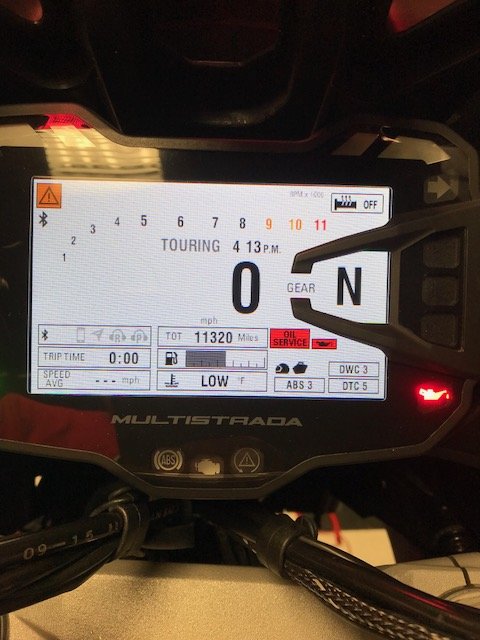

1200 DVT Generic Orange Warning (!) Lamp - Any Ideas?

    I have the same warning light since last night after a long ride.
    It sometimes goes away and then returns when I ride 110km and beyond.

  8. Mine came on yesterday while riding to my dealer to have the Brembo brake recall service done on my '17 1200S Touring. Turns out it's the headlight module throwing errors. New module ordered under warranty. I'm told this bike has 5 separate computers controlling everything on it! I'm thinking an extended warranty is in my future!
