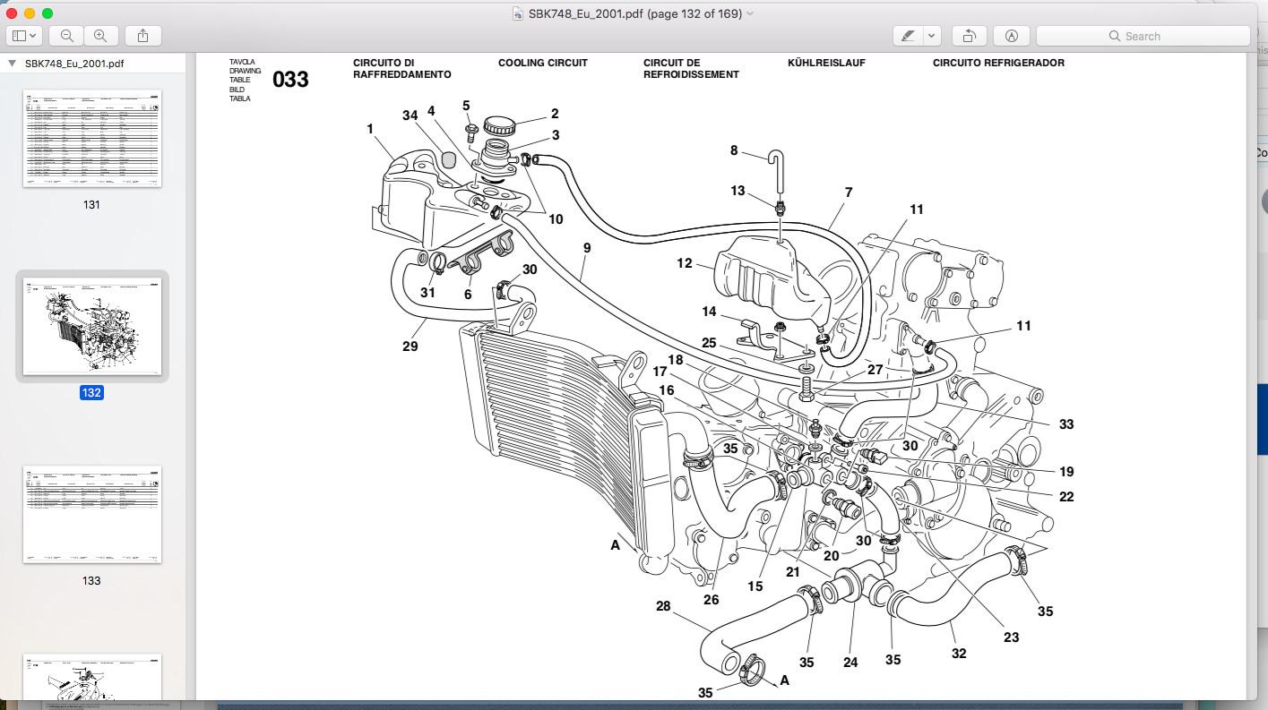

  14. It might be that the gauge is accurate up to say 100c but then goes doolally; worth checking out anyway. My 748 sin pieces at the moment so I can't trace the wires back but your temp gauge will be connected to one of parts 18/19/20 on the attached diagram. Which ever one it is I'd lay money on that it's a relatively cheap part and readily available. If it were me I'd purchase a new replacement one, swap it over, and see what the temp gauge reads afterwards.

  18. 748/916/996 have three temp sensors
    If you look at the bike from the left the there are 2 horizontal ones pointing at you 19&20 on the diagram The rear most 19 is for the ECU the front one 20 is for the fans. The vertical one not numbered on the diagram below the bolt number 27 is for the temp guage
