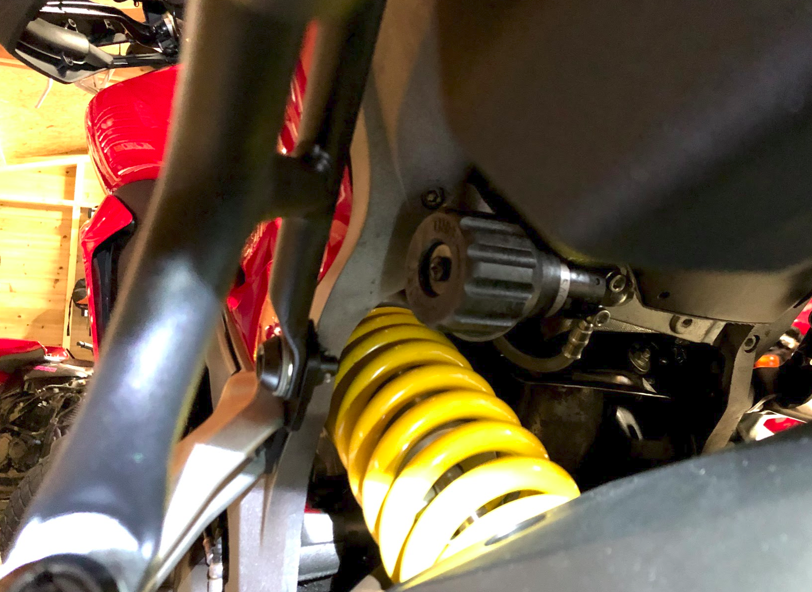

  3. that's for the 950 and doesn't fit, i've made something similar
  4. It might be for the 950 but I can confirm that it fits perfectly (2015 MTS 1200 with manual suspension - so expect it also to work with the Pikes Peak manual adjuster but cannot confirm that 100%. I'd be surprised if the mounting was different on the PP but granted it is Ohlins on that bike). Invisible solution unless you know it's there and moves the preload adjuster fully clear of the pannier rack. :)
    That's the preload set to max, BTW... it comes about 1/2" further out when set to min.

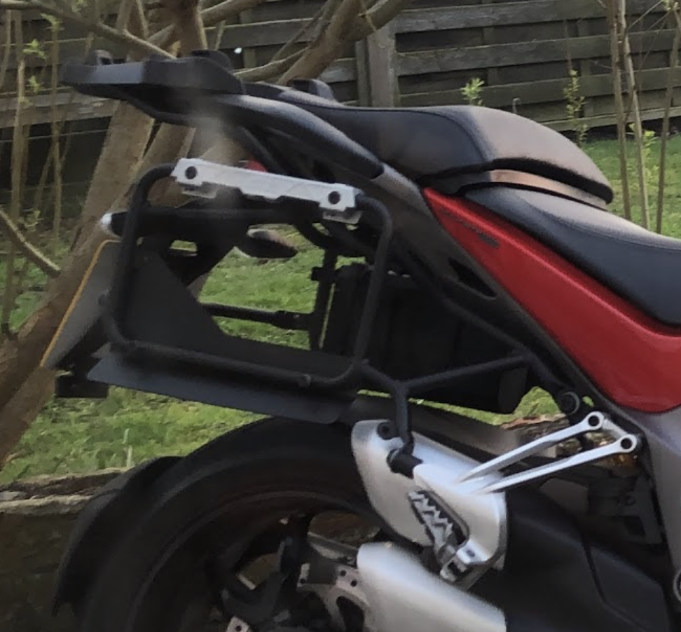

  5. Also added the Givi toolbox to the LH pannier frame. Handy little thing and looks neat, tucked under there.

  10. hi, just seen this and wondered if this was on a 1200s as Givi only list a tool box fitting kit for the enduro model ?
    I wondered if you had any clearance issues with the single sided swingarm on the S ?

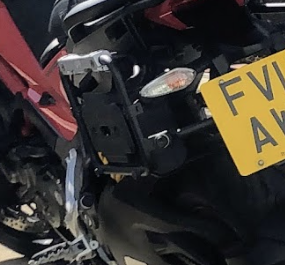

  11. It looks like the indicators could well be in the way
  12. I have a base not an S but there’re no clearance issue. Fits perfectly. You need the fitting kit for the pannier frames you have. The enduro frames are by Touratech.
  13. Recent pic of it all laden. No indicator clearance issues or any clearance issues. Good kit.

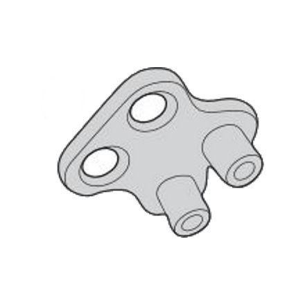

  15. I originally got the universal tool box mount and that was no good. It mounted it in a way that conflicted with the indicators. So worth getting the correct mount, rather than doing what I did and just going for the one that'd be delivered first... :D
  16. By clearance issues I just meant access to the tool box. The standard indicators are quite large.
  17. Yeah, that's really quite adequate to get into the toolbox. The lid just pops right off and I have plenty of room to slide my stuff in and out of it. :)

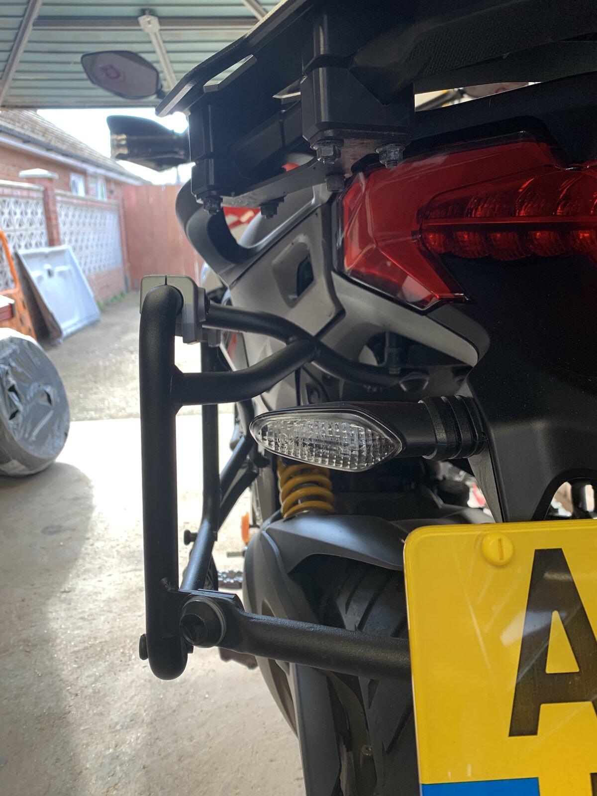

  18. Picture is a bit crap but the best I think I have, you can see there's good clearance.
