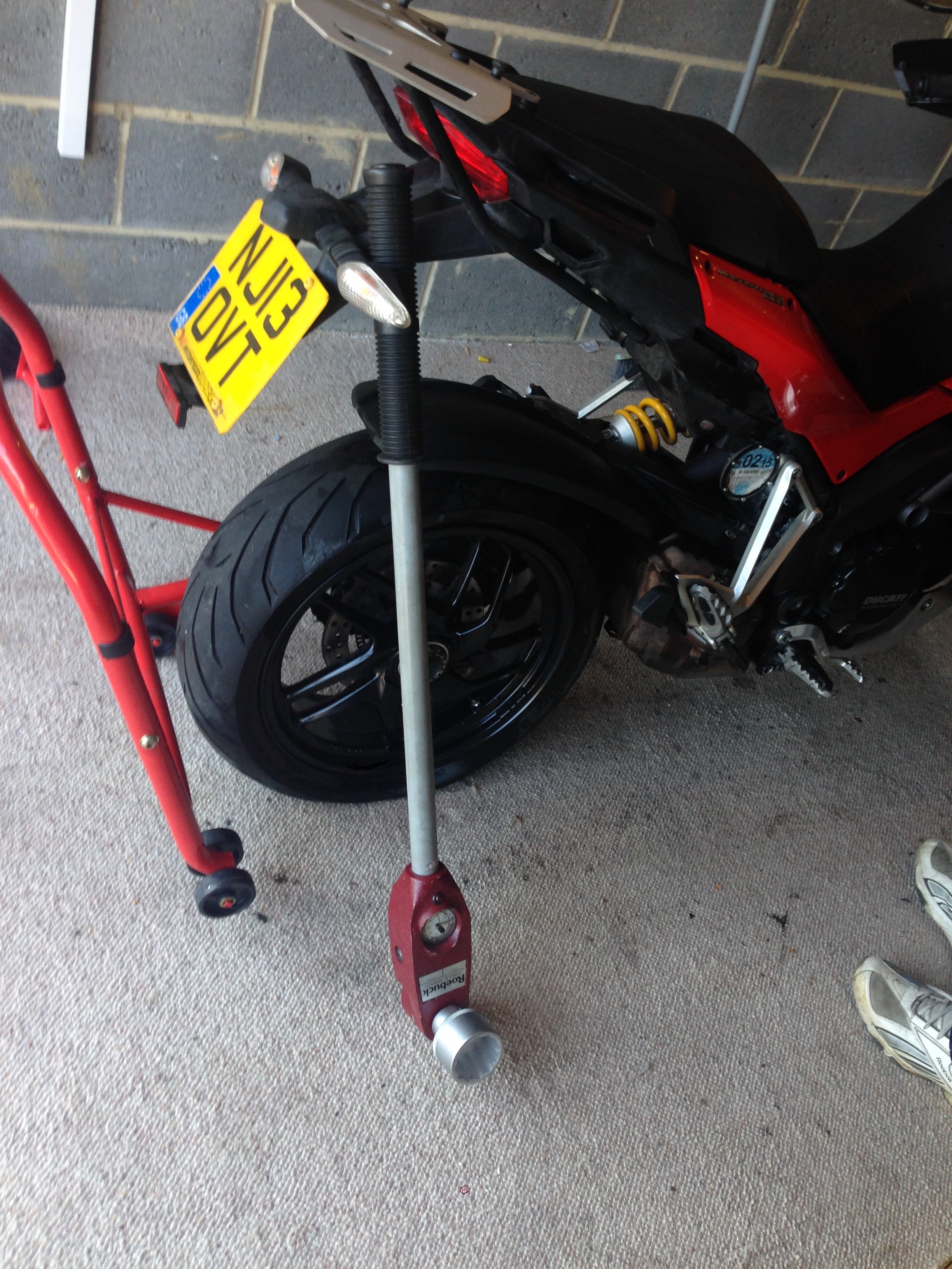

  9. In a proper panic on Friday when I needed to take the wheel off due to a puncture after reading this, seriously don't know what all the fuss is about now. 1 little spanner and 2 seconds later, off it comes :upyeah:
  10. Tsk, scruffy trainers.
    Still, proper torque wrench that.
  11. No calibration sticker....

  15. This thread completely baffles me!! I've just had a new set of tyres put on my 2012 S Touring, my 2nd Multistrada, and the third time I've had to remove the rear wheel from one.
    Missus sits on bike, applies front & rear brakes, bike is also in first gear. I put my Oberon wheel nut socket, attached to an 18" breaker bar, onto the wheel nut, apply steadily increasing force to the bar, wheel nut comes undone. OK, I'm 20 stone, and, admittedly the wheel nut is reasonably tight, but not, IMO, excessively so. I would have thought that anyone over 12 stone, with maybe a 2' extension on a breaker bar like mine, could remove the nut without too much trouble.
    I'm tending to think that the problem is more to do with poor technique than overtight wheel nuts. I'm an engineer so have been used to undoing bloody tight nuts all my working life. Perhaps those struggling most would be well advised to let someone with more experience (and more lard) have a crack. Bouncing on the end of a scaffold pole, losing your rag with it is never going to do anything but damage the nut. Steady, progressive force is the only answer. And as for the thought of using an impact wrench, well that sends shivers down my spine. I can't begin to imagine the damage one of those animal tools would potentially do to the wheel nut.
