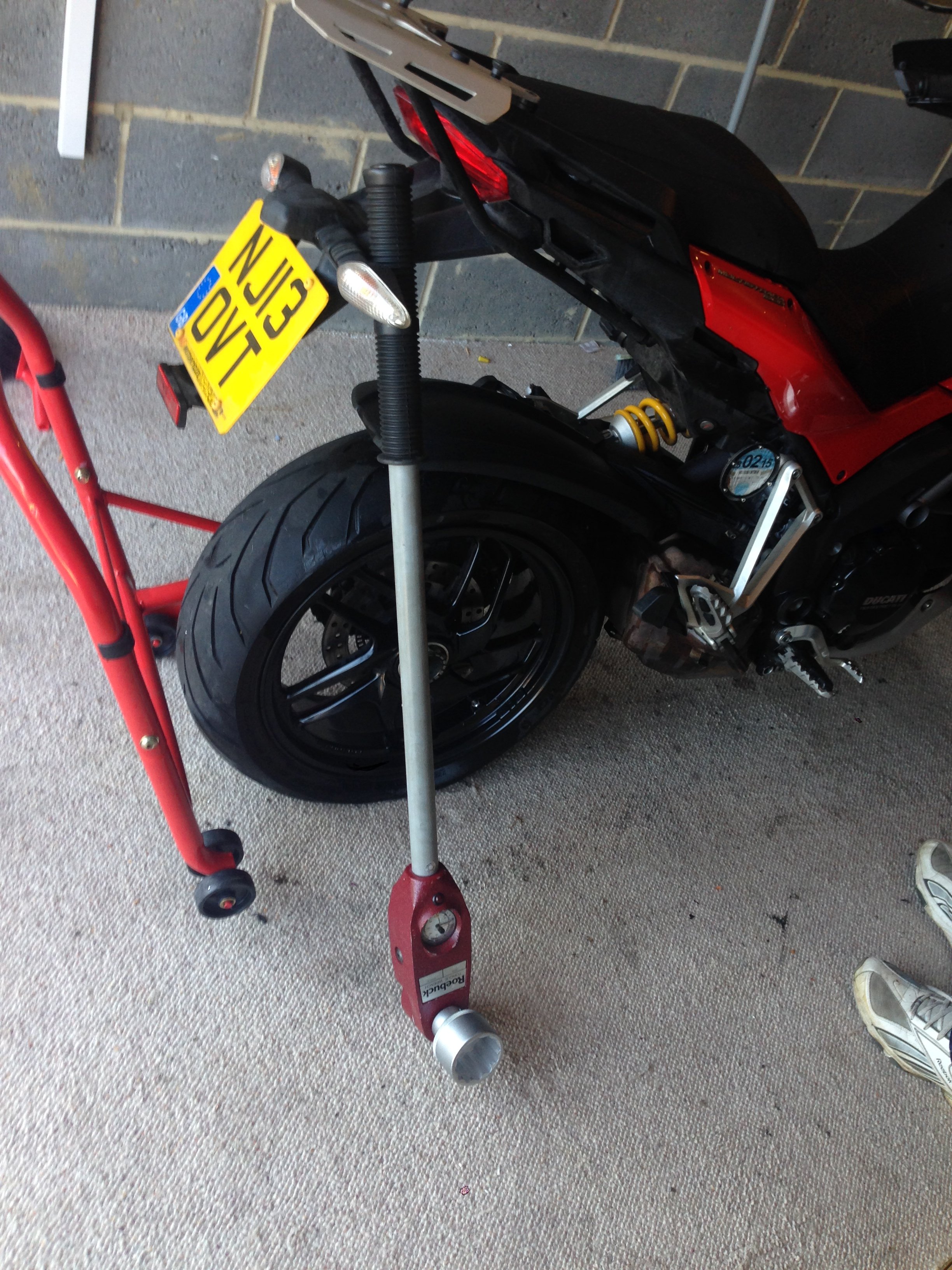

  2. Anyone around West London today with a 12 point 55mm 3/4 drive socket and +1000mm long breaker bar fancy helping a fellow biker out?
  5. I've got a 55mm 12 point and an impact gun your welcome to borrow but I'm unable to deliver, your welcome to pop out to Berkshire to collect with no rush to return.
  6. Cider with Rosé - good title for a book that... :)
  7. He's all torque, that one...
  8. Is it 1/2 drive?
    I've a 1000mm 3/4 bar now, but no suitable socket.
    I don't want to use a 1/2 drive socket as there is every likelihood I'll break it.
  9. Are you still struggling with this? I have a 55 mm 12 point socket with 3/4 inch drive, and I have a 3/4 inch bar/handle to go with it. If you are really desperate, I could drop it down to Hatton Cross for you. Let me know. Pete

    With our 1000mm bar, three heavier than average guys and Pete's socket she came loose.:Bag:

  17. Regarding the socket size is it best to go with a 3/4 inch , or is it just the odd one which is a pig to get off?
  18. If the nut does up & comes undone with the prescribed torque setting, you can get away with 1/2 inch. Just. But if a nut gets seized somehow, which they occasionally do, it has got to be 3/4 inch drive. The half inch square can just snap off. So you really need a 3/4 drive socket, so you can be sure to be OK whatever happens.
  19. Thanks Pete for that .
  20. Just catching up with this post, reading the manual for refitting it states use grease b which is shell retinax hdx2 a lithium/calcium based grease with molybdenum disulphide, smear on thread and base of nut with 230Nm torque. Also states use retinax on front wheel axle thread. Apologies if this is covered in previous posts.
