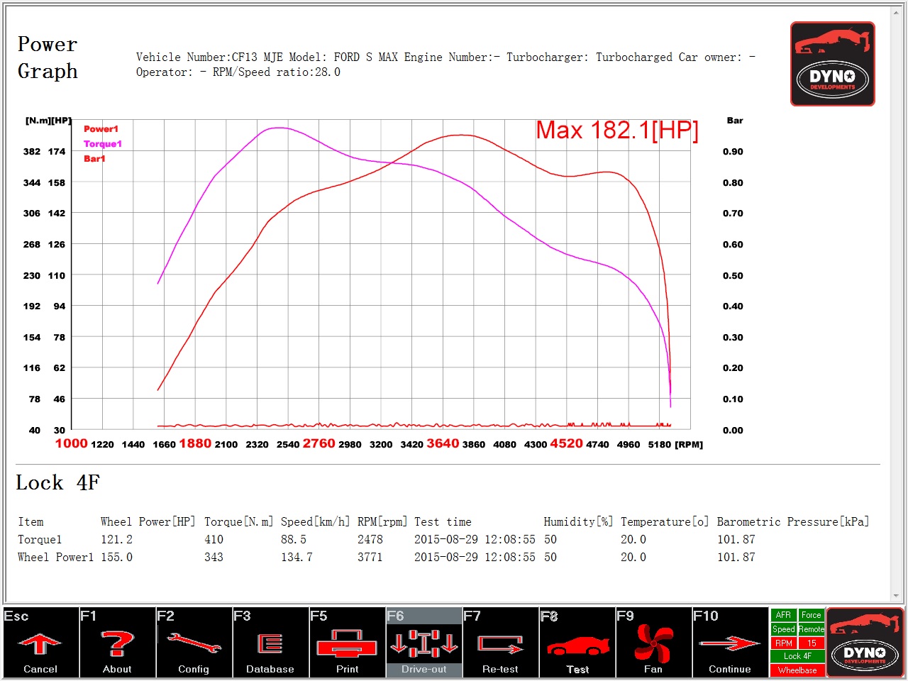

  18. Welcome to the world of eu regulation....Ducati have to sell it that way to you....they have to make it euro compliant....cjs (for example who are close to me in Bristol will map it correctly) Delete the flapper valve, remove the o2 sensors, reduce the engine braking, add 500rpm to the redline. Heres the dyno run from my second hyper....
    Notice the bottom end....that there is your throttle snatchiness - and then take a look after....a smooth curve....heres another one...our smax....same thing applies...
    An absolute torque monster now in second...uses less fuel, egr valve closed...so doesn't clog the engine up and it just sailed through the mot - emissions nice and low...I made a point of asking the MOT bloke.
    Dyno work is the way to go without a doubt...Notice the power increase on both....
