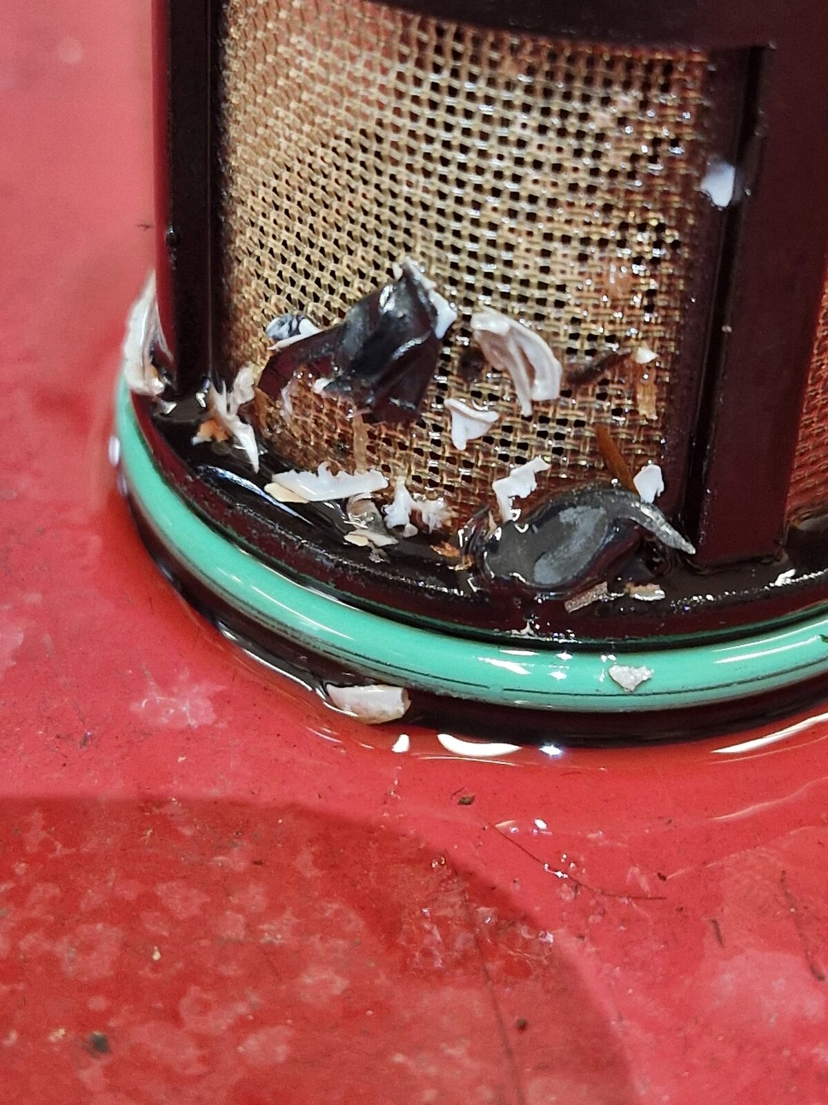

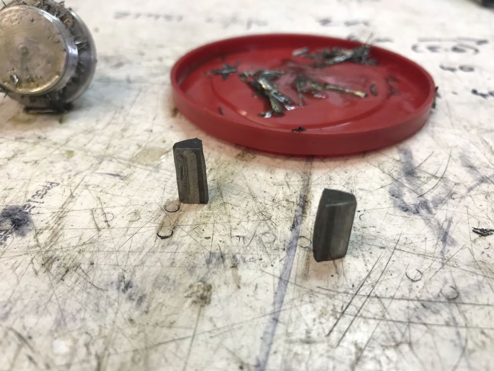

    Here's what I found in the oil;
    And here's the gears;
    I got a good, used gearbox set for not much money and swapped it myself. A bit daunting if it's not your thing but not that difficult really and I dread to think what a Ducati dealer would have charged me.

    When my 6th gear lost some teeth, my first thought was that the sprocket had lost teeth or the chain some rollers as it was snatching and not just in 6th gear, it was also struggling to pull away in first, presumably because the gears weren't meshing/spinning properly on the shafts?
    I even suspected the clutch basket was somehow slipping until I saw the 'hedgehog' on the sump magnet and then I knew something was wrong internally.

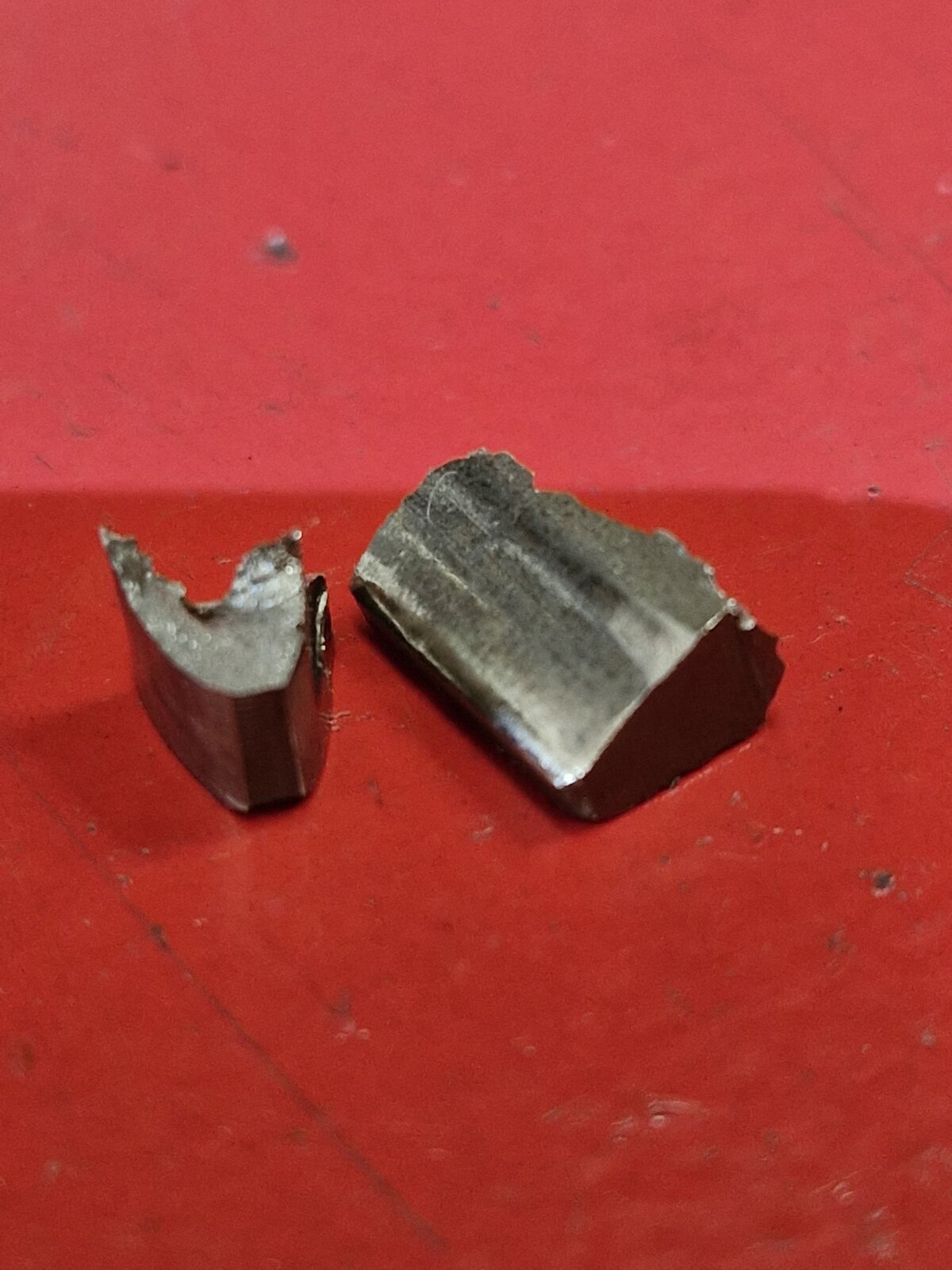

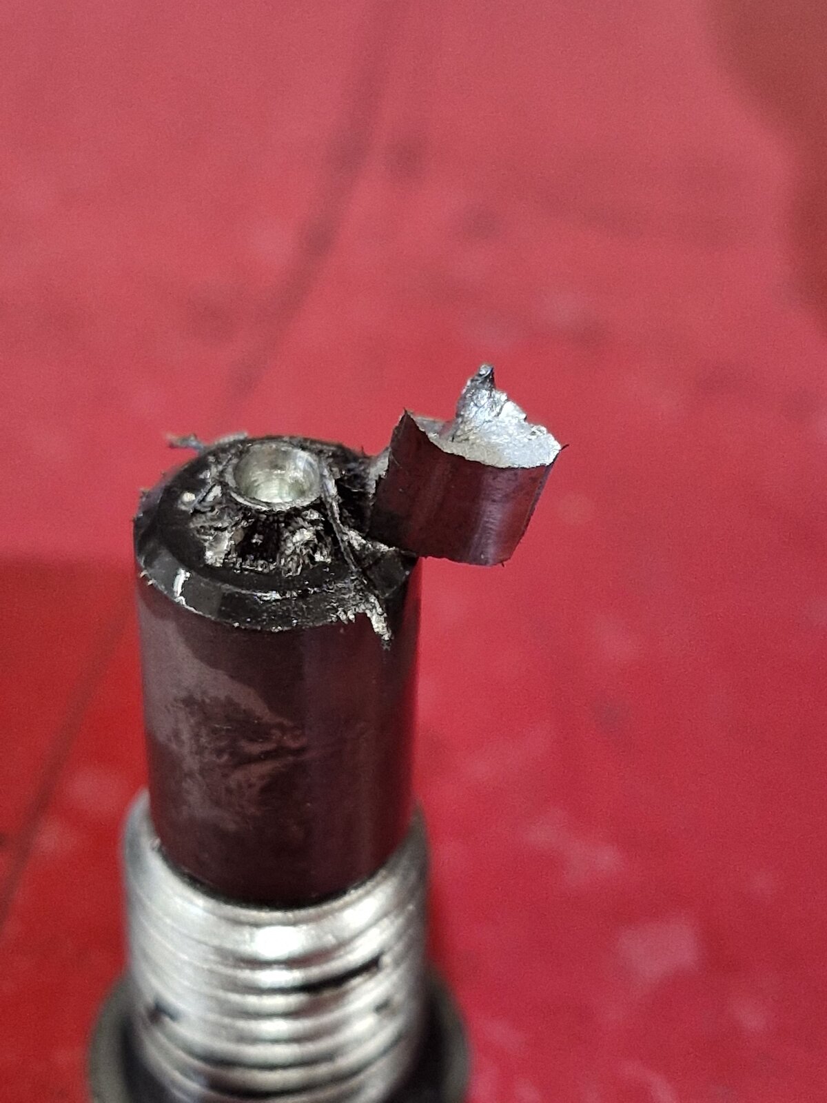

    WARNING: the following post contains images some views may find distressing.
  17. 0d601b05-d644-43aa-9423-c99ace1b6655.jpeg 91288b3a-4d05-43d3-a7ab-eaa70af2ad2b.jpeg 29d1170d-fde6-4e6b-8460-f7612cfe2959.jpeg
    • Dislike Dislike x 2
  18. I can hear you all sucking air through your teeth from here o_Oo_Oo_O
  19. Ouch!
