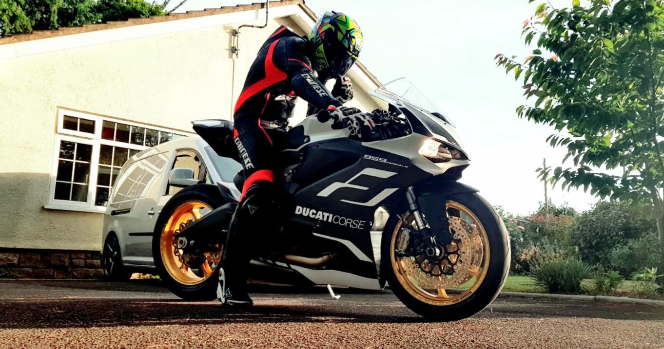

  5. 178kg with half a tank of fuel! What really concerned me was the weight bias. Obviously with the carbon rear end and mostly Ti bolts throughout. Sat under the front wheel was bang on 100 and rear was 78.... but here’s the thing, with me fully kitted out (dainese trickster kangaroo suit, agv pista r and pro race boots and gloves sat on the bike in a semi prone position she is is bang on 50/50! result I’ve also gone through some further weight reduction myself and down to a healthy 66kg at 5 9” .... I’ve always worked on power to weight on all my bikes as I think it’s one of the most important upgrades, along with suspension and tyres. Also setting the bike up ergonomically makes a massive difference.
    I opted for the softer 80nm spring in the rear and played around with the ride height. Set up the static and rider sags front and rear and then it was just a case of compression damping and rebound to dial in. I also dropped the forks through the yokes by 4mm just to quicken up the general feel when transitioning. Along with the weight loss I can honestly say the bike has been transformed. From a handling prospective it’s faultless. Holds an amazing line without any compromises, so little effort to put it exactly where you want it and so stable. Corner entry and exit allows you to carry far more controlled speed without it feeling a like it’s freighting you. But the biggest difference is transitioning, it’s so quick but yet so stable.
    Performance has also improved dramatically, purely due to not having to haul so much weight about, brakes also feel more effective under all conditions. I’m really happy with the way it turned out. I know it was a lot of money to sink into a bike but the transformation is nothing short of spectacular....
