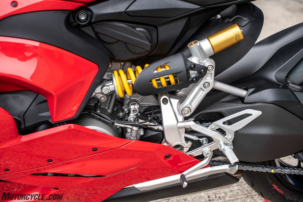

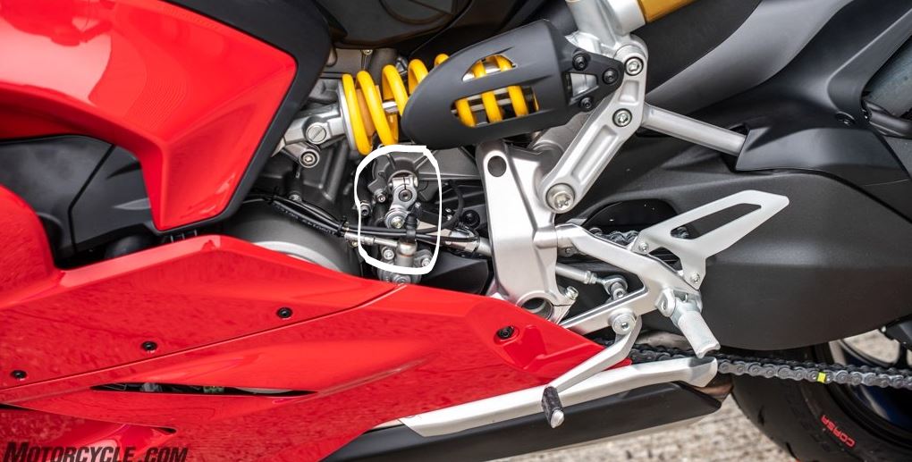

    The pic below shows the V2 - it’s shifter linkage/footrest looks the same as the stock 959 which means you can’t use GP shift out of the box.

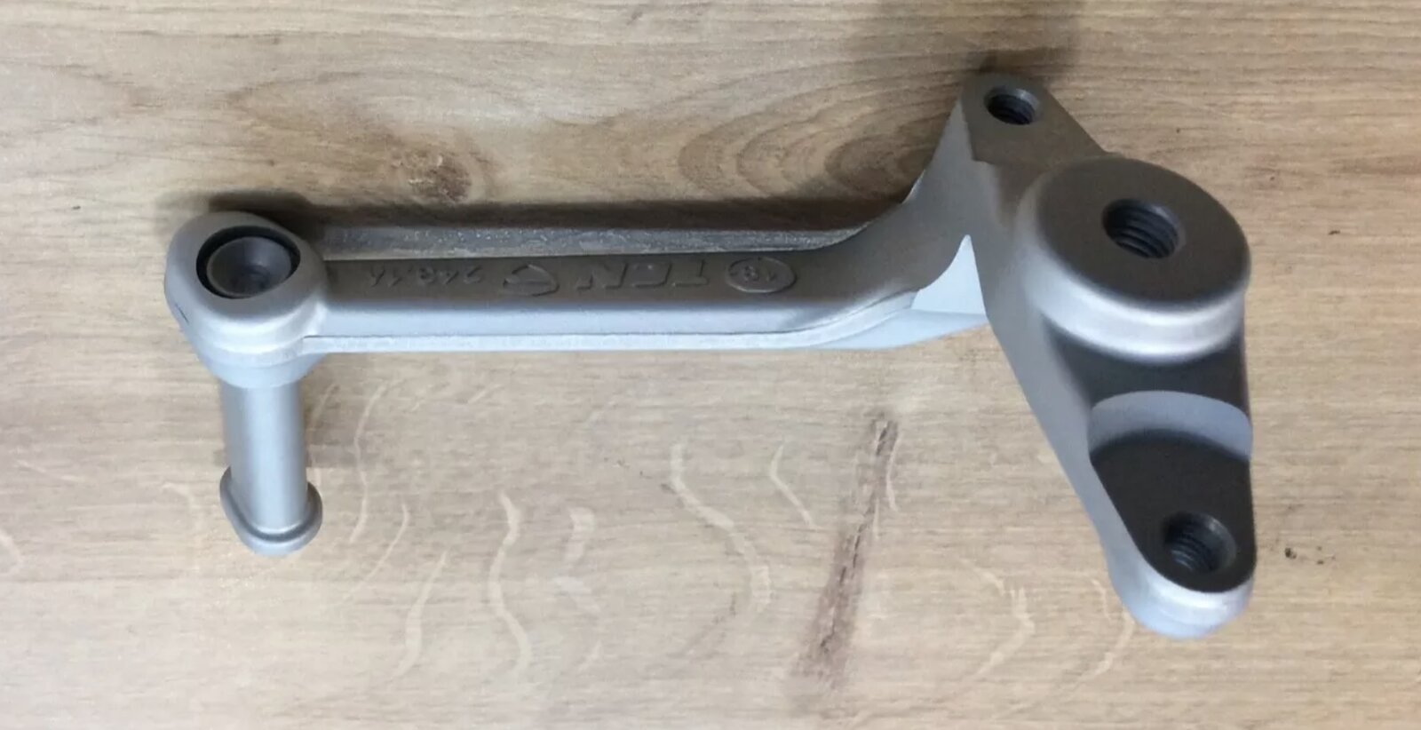

    The V4s etc has a linkage with two positions so you can switch between shift patterns - the cheapest option if you aren’t bother about bling is to get a used v4s setup. It might even be possible to just buy the shift lever - part no 45613411aa and fit it to the stock V2.
    Below is V4s
    V4 lever showing bottom hole - connect shift rod here for GP shift
    link to photo steps to switch to GP shift

  11. Will this flip over? Point up?
  12. I don’t think so - moving the linkage connection point just reverses the direction of travel - push down with toes pulls the gear shaft instead of pushing it in standard configuration.
    edit - sorry wrong response - for some reason your picture didn’t come up for me before!
    yes I guess thus could be reversed to achieve the same thing - as long as the shift arm could be extended long enough to reach?
    And clearances around shock / shock mount were enough - I just looked on the 959 - I couldn’t do it as I have the R-G crash protectors fitted and the mountings get in the way - it might work without but would be very tight.

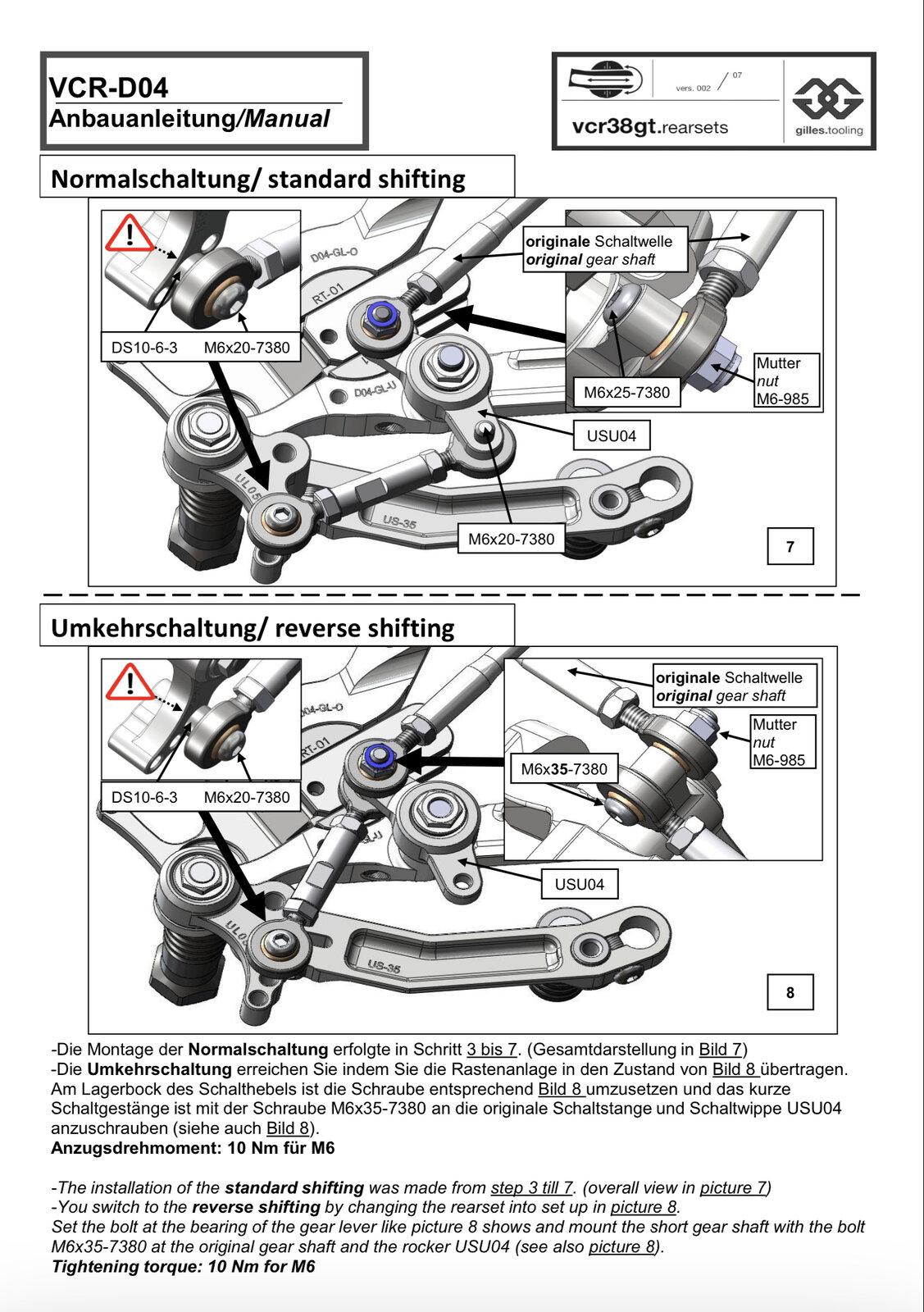

    #57 LiveFast......, Nov 30, 2019

  17. This is a great explanation and guide as to the fitting of the older reverse shift kit.
    Also answers the question as to why you can’t just flip the standard gearbox arm
