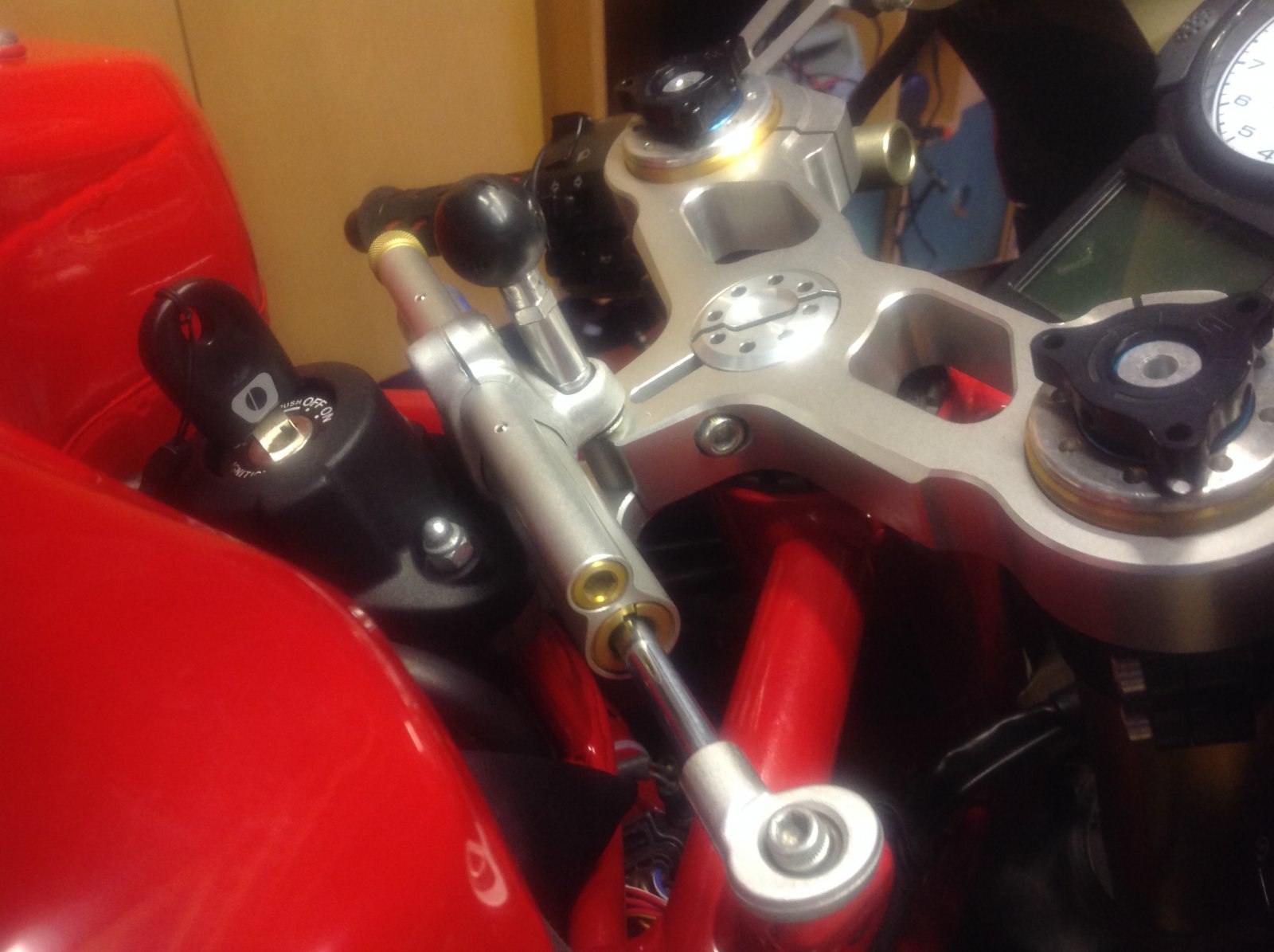

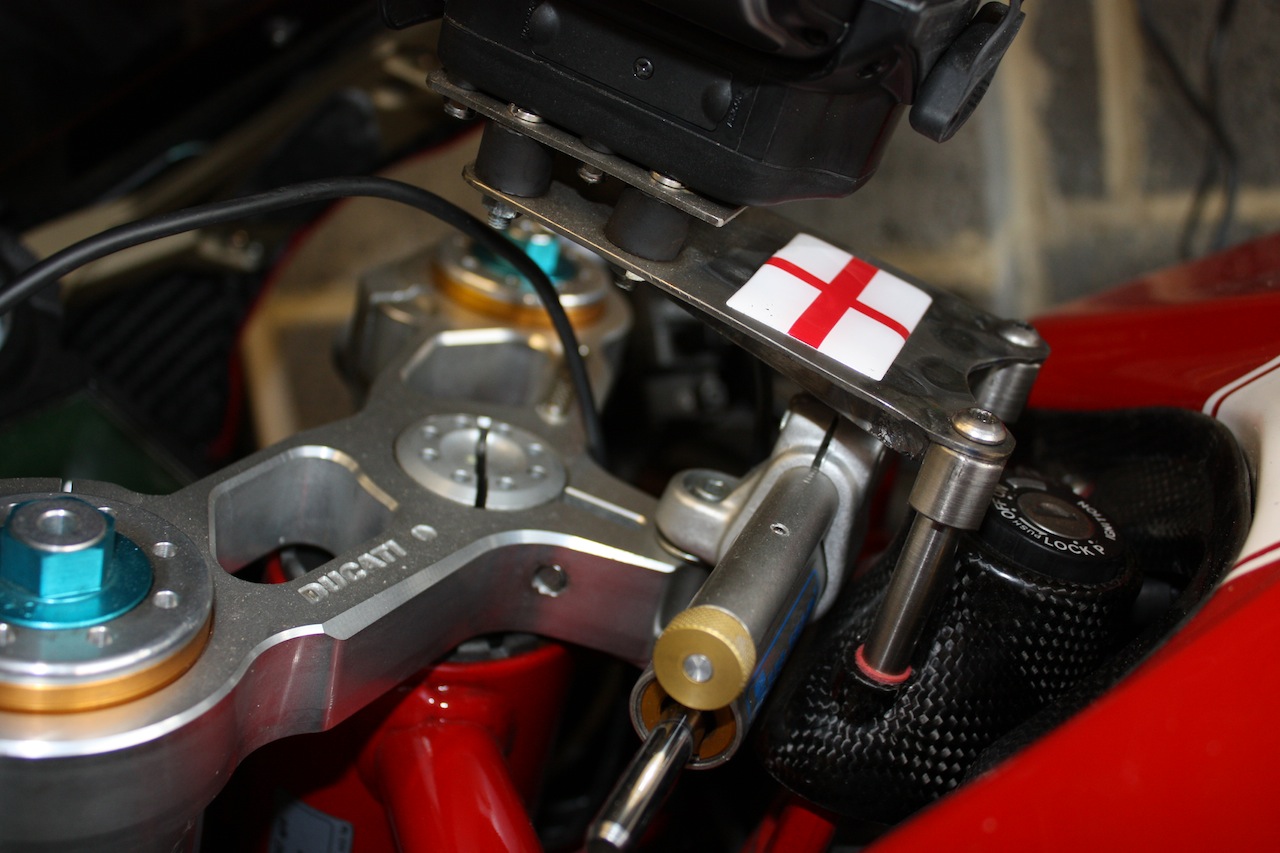

  5. I know not everyone has the material/machinery/ability but I make all my own mounts . This one is for my garmin zumo. I didn't want it turning with the bars so I mounted it to the key cover bracket . All made from Ti and has done many EU trips ..
  6. maybe you can post another photo to contradict me but it looks a bit bulky to me.

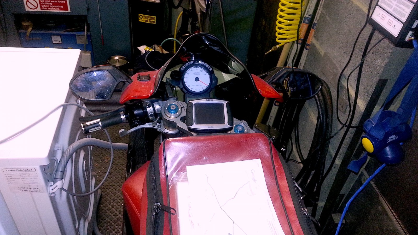

  7. Its not always about size . Sometimes its about position . Specially when touring with tank bag on .

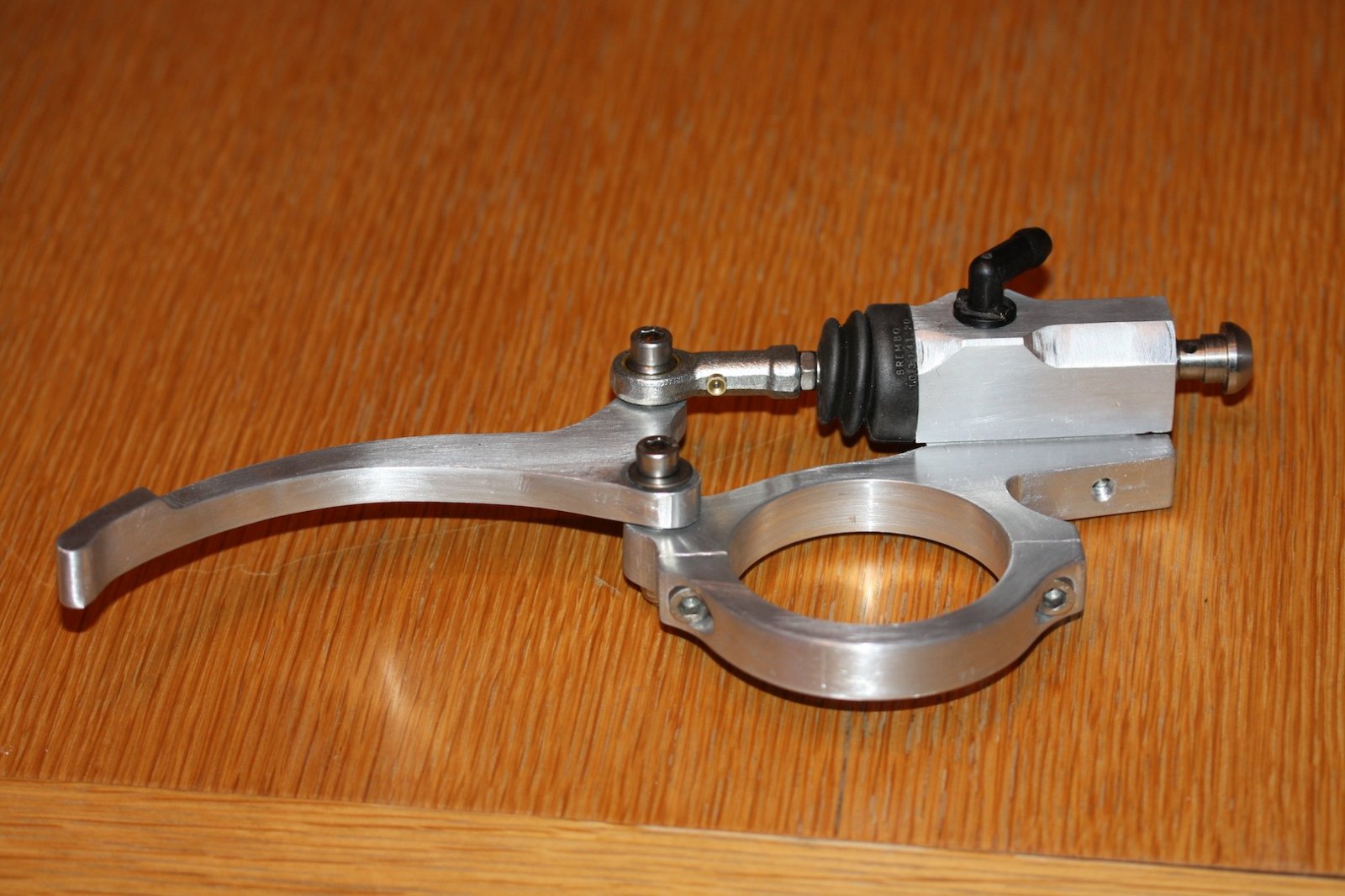

  8. Is that a thumb rear brake under the left handlebar?
  9. Yes. All my own work but had to alter lever and never took it back off for finishing

  11. which GPS and how do you power it ?
  12. Brilliant work.
    Does it vibrate with the sat-nav being so far from the mounting bolts? I never would have though the key cover holes would be strong enough. If you don`t use a tankbag, I suppose you could shorten the bracket a little bit, although, that would move the screen further back from your eyeline. Your solution is probably the best one. Does it block the view of the speedo?
    Any measurements or more pics would be appreciated.
    Cheers.

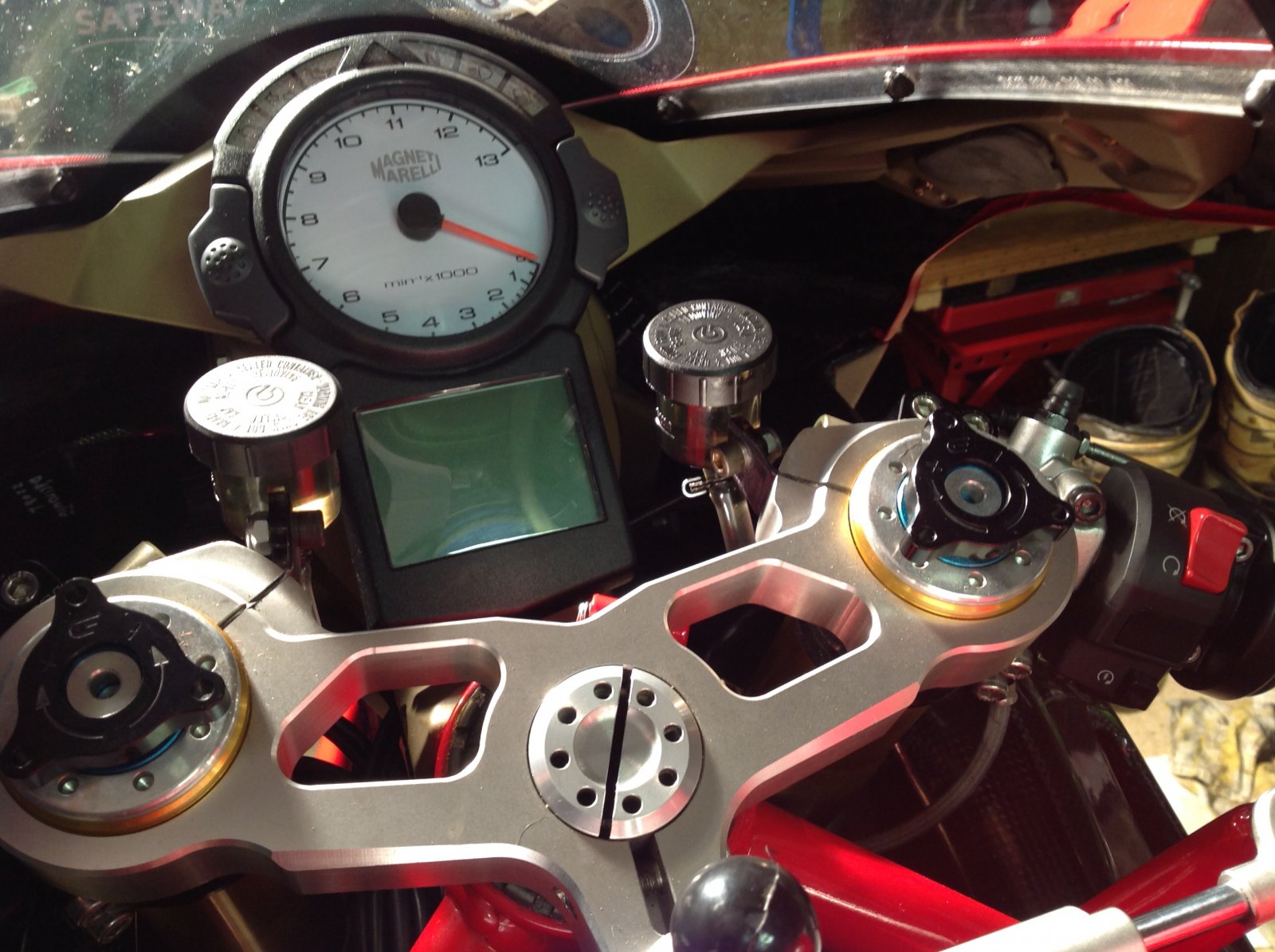

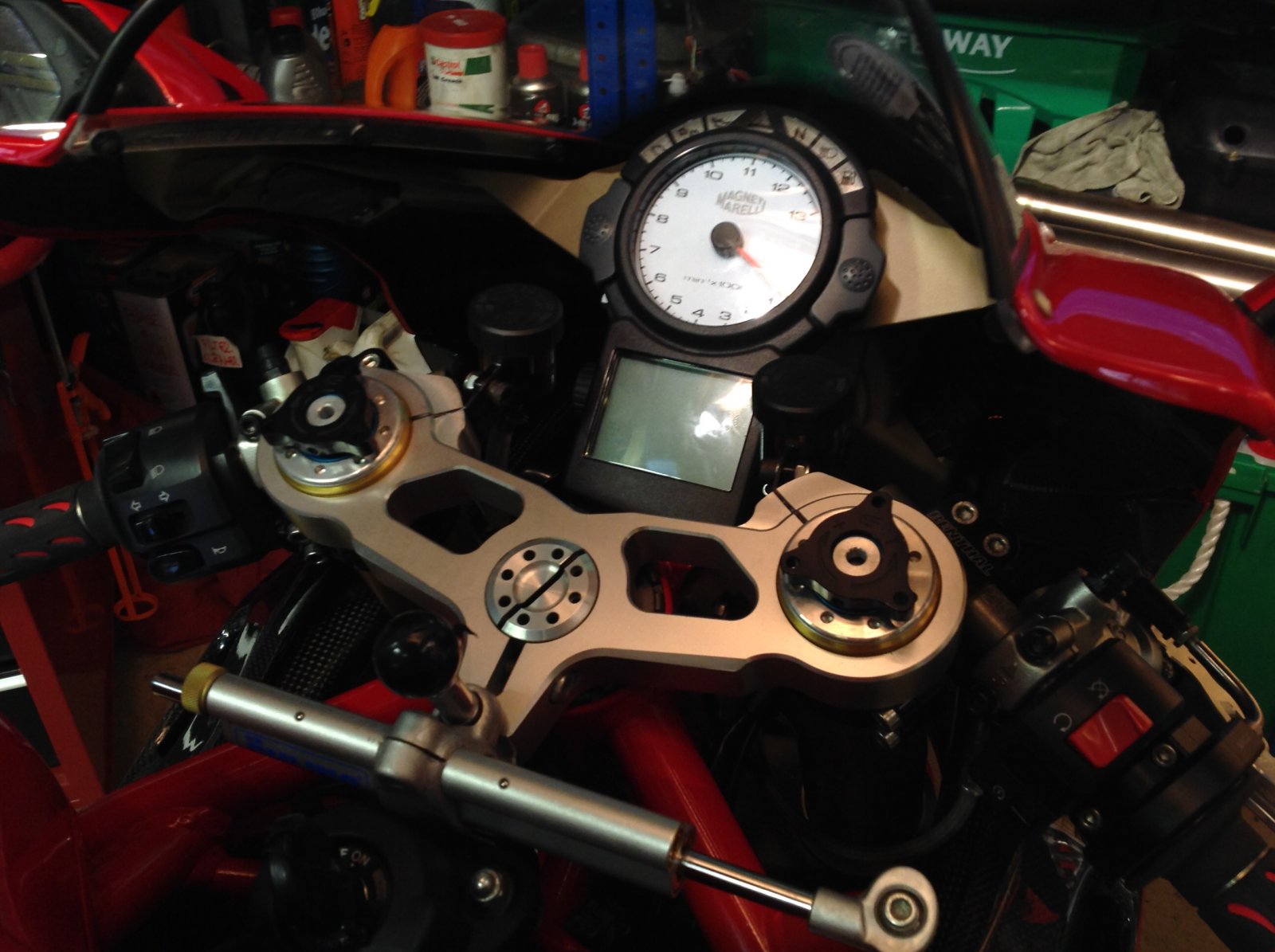

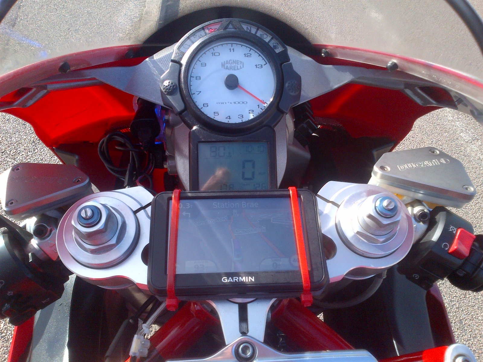

  13. tidy up reservoir brackets and sat nav mount done...now need to buy the sat nav haha 2015-04-04 16.37.17.jpg 2015-03-28 17.16.21.jpg 2015-04-04 16.34.18.jpg
  14. I'LL get you a picture with a measurement reference at the week end . There is no noticable vibration but if you look at my first picture you will see there is a top and bottom part held apart by small rubber shock mounts . Bought from ebay if i remember right.
  15. Thanks for that.
    I also noticed, after I`d posted of course, some triangular pieces underneath to prevent any flex.

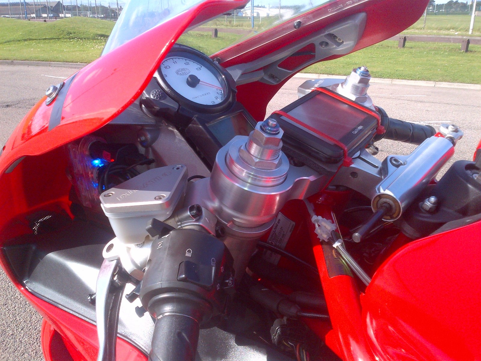

  16. fitted my sat nav recently,, nothing fancy but cheap and working well ,, connected to Ultimate tail and throo Halfrauds multi cigar lighter
  17. Love the simplicity and no obstructions or destractions [emoji106]
