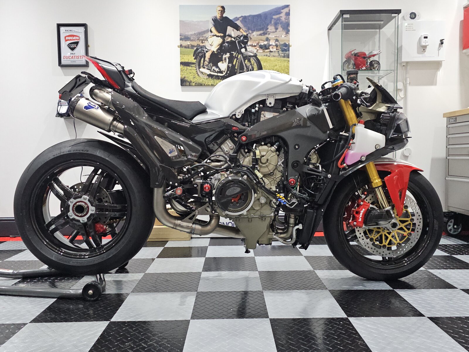

    Here is a better view of the bike from the RHS. The exhaust system doesn't really exhibit any signs of a heat cycle, as the bike only ran for around 90 seconds before the fuel leak became apparent and I shut the bike down.

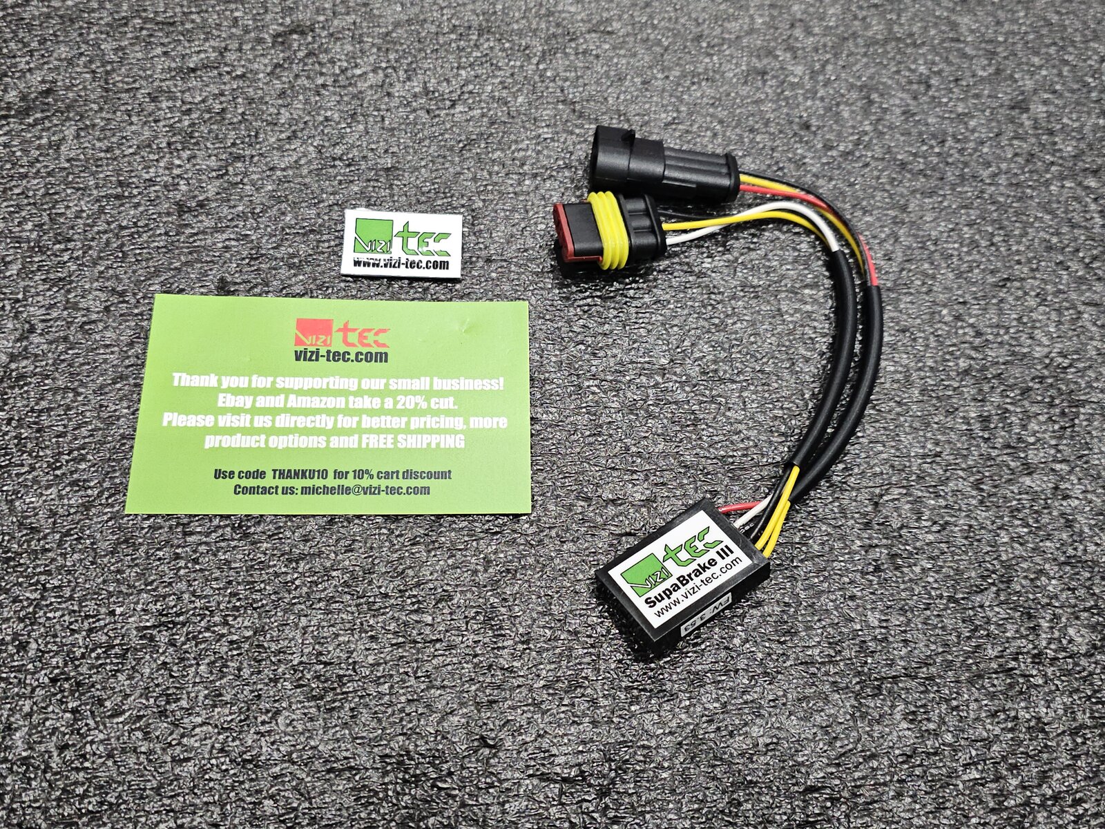

  4. Another part arrived today that I have been waiting for, for quite a while. Had one on my 1098S a few years back and it's extremely well made. It is this brake light modulator ("the SupaBrake III") from ViziTec, who are based in Australia. Unlike other cheap modulators this one works on algorithms that do not simply flash the brake light at random times or on repeated use of the brakes. Instead it uses a "Grace Period" and both your braking frequency and intervals, to determine the most appropriate time to activate. You can also configure the profile to your own liking and the unit is fully CAN bus compatible. Each unit is tailor made to your bike and is simply "plug-n-play" and comes with a comprehensive 24 page user manual, that you can download from their website. It takes literally 5 mins to fit it. The owner Bernard, is very knowledgeable and helpful and responds quickly to any correspondence or questions you may have. More details can be found here: https://www.vizi-tec.com/
    Here is the unit itself. Very small and compact and easy to secrete under the seat.

  5. Cost?
  6. All the details are on their website. Depends on your model but IIRC they are around AUS$110.

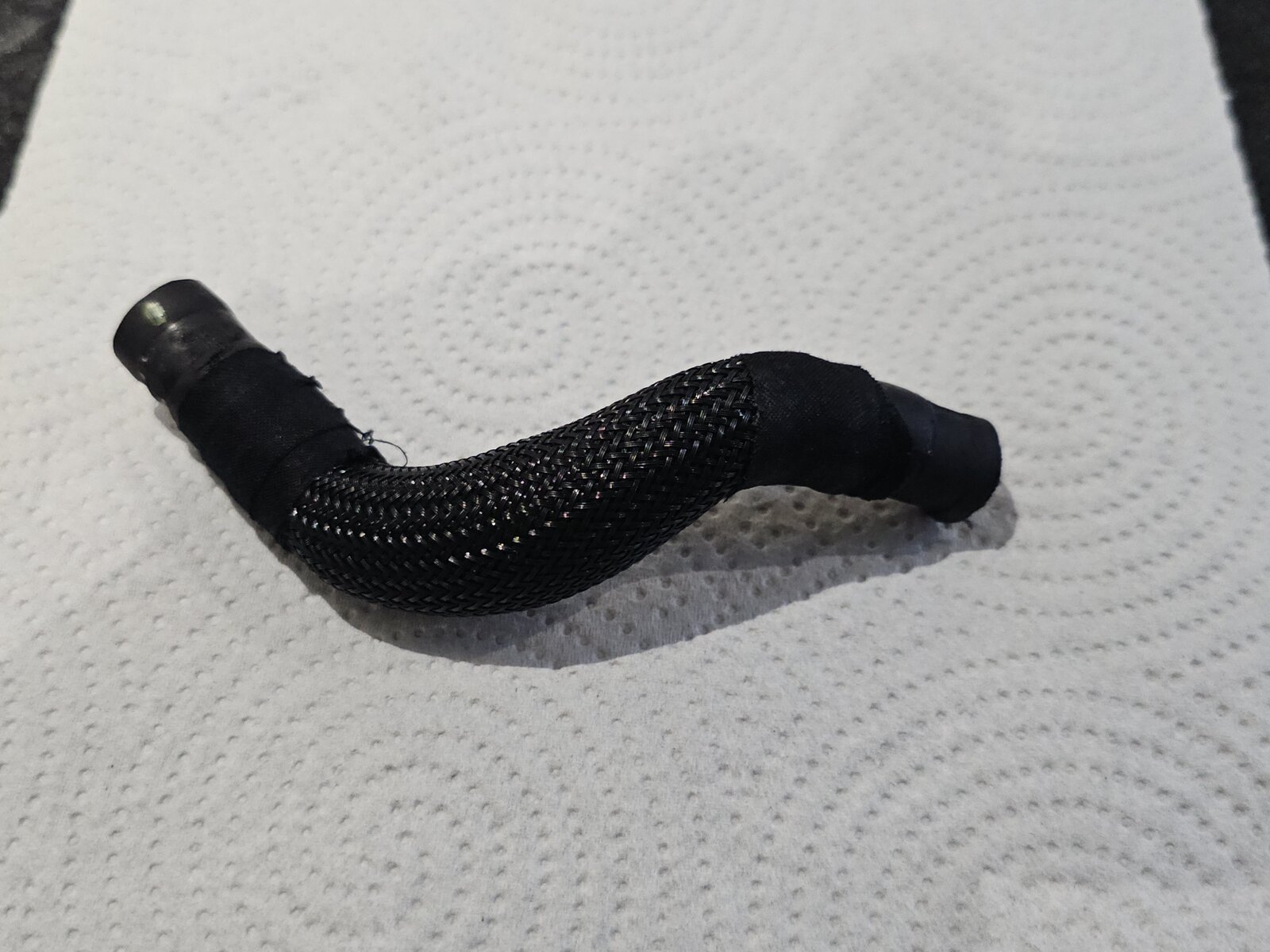

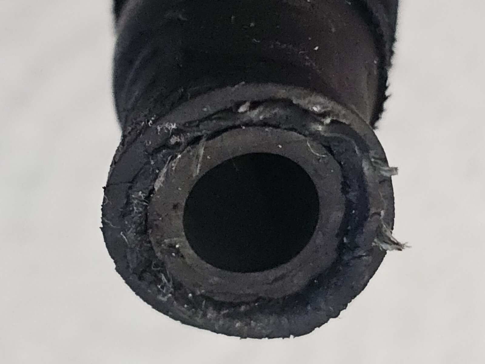

  7. So fuel tank coming off today to remove the offending delivery hose. On closer inspection, it appears to have a tiny hole, almost invisible to the naked eye, from where the pressurized fuel is escaping. I hope to have its replacement and associated clamps in a few days, in order to reassemble the bike and run the engine up to temperature. Whilst the new hose now comes with what Ducati call a "damper", it's basically a braided sleeve that goes over the hose to stop it fretting against the subframe/cylinder head. I may well add some spiral binding or a short oversized section of rubber hose, to protect it further. Whilst I had the tank of my previous bike on/off several times with no fuel leak issues from this hose, threading it in/out of the gap between the rear cylinder head and subframe, often requires some forceful manipulation which, I imagine, is when the damage is being caused.

  11. So tank is off again! Removed the offending hose and clips. Whole process took no longer than ten mins. Discovered that the hose had delaminated at the fuel rail end. There is an outer reinforced sheath that is bonded to an inner rubber core. That aside from what appeared to be a very small nick, is most likely the cause of the leak, so this hose is toast. The braiding around the hose is what Ducati refer to as the "damper".

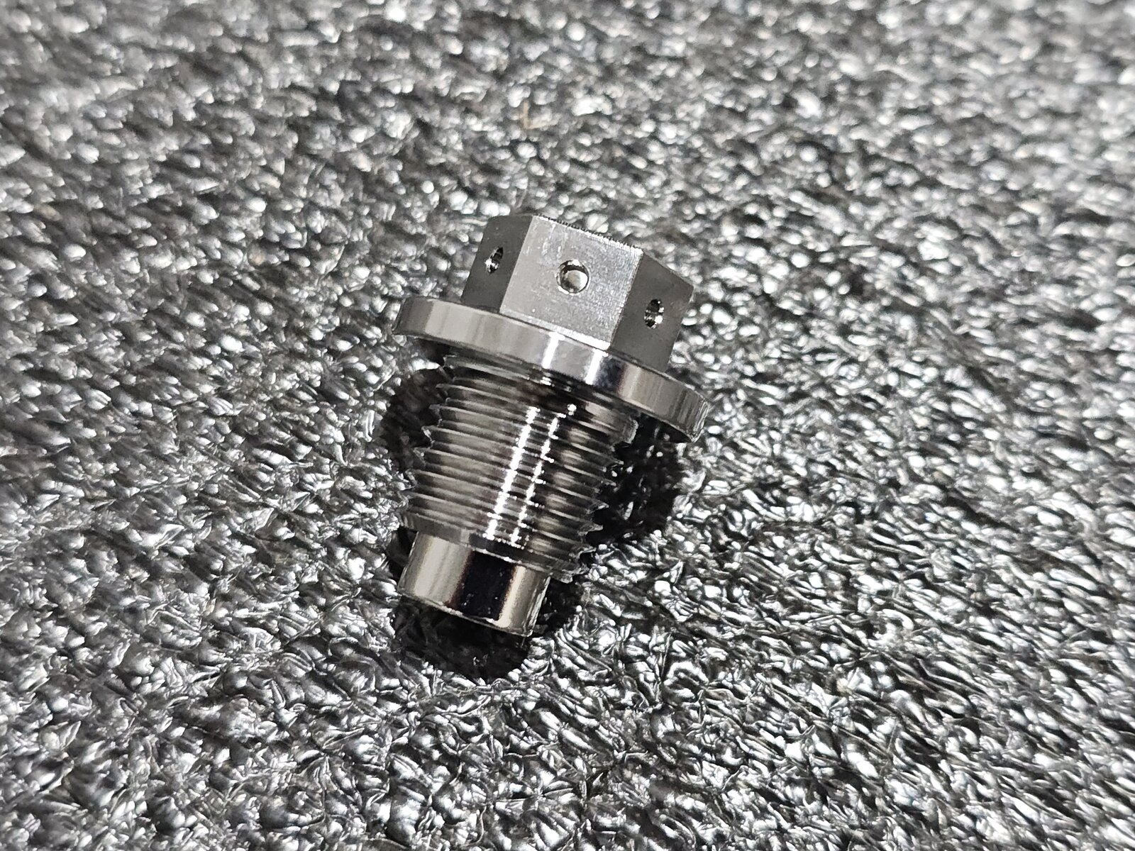

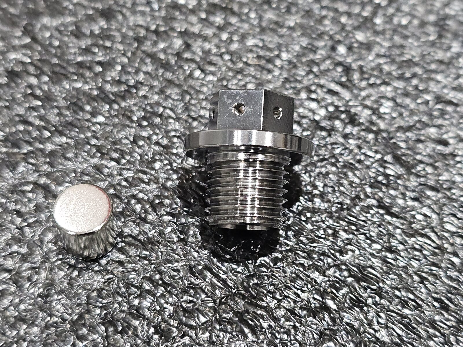

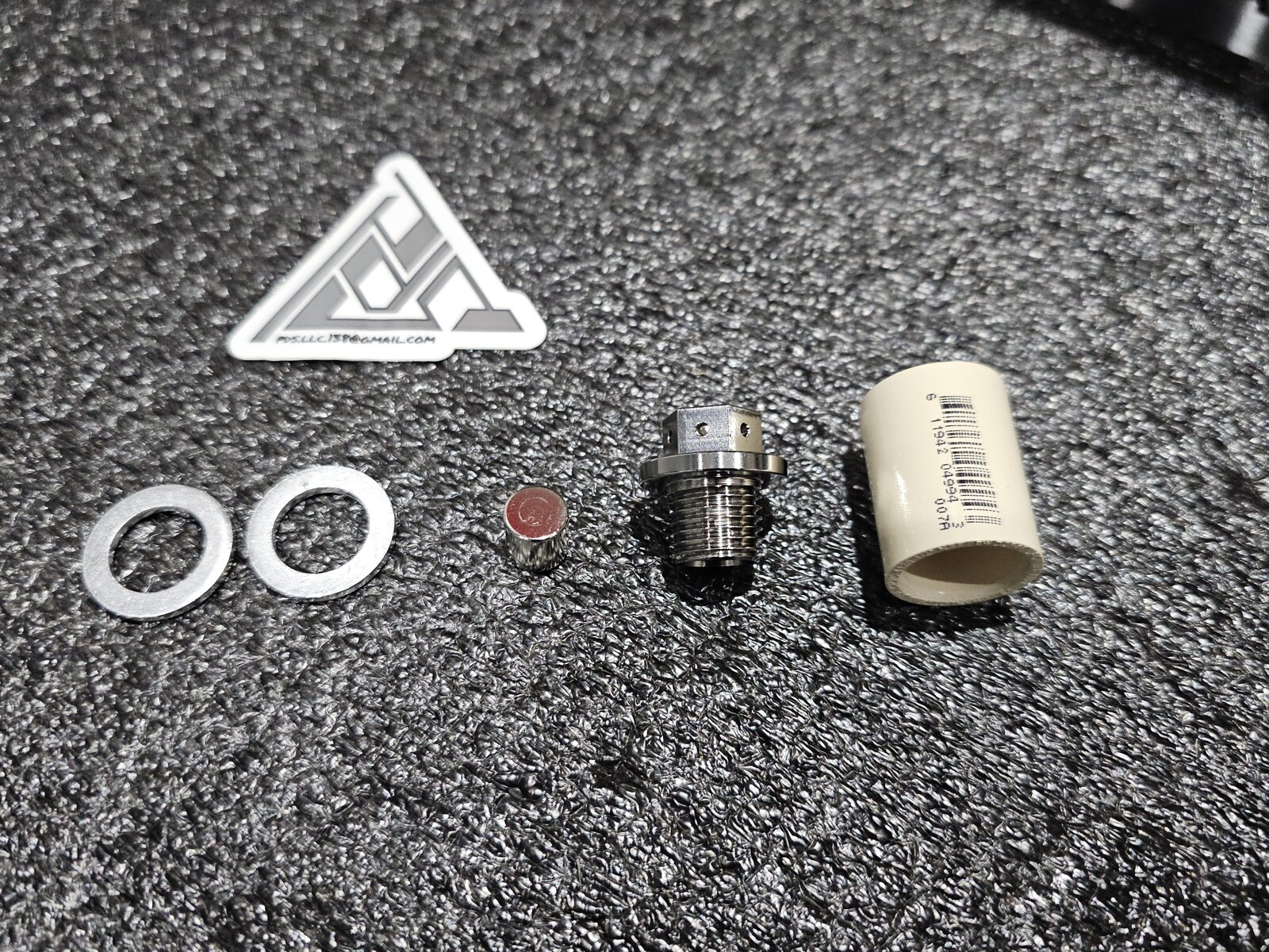

  12. So....still waiting on the fuel hose to arrive (hopefully this week, so I can run the bike up to temperature, check for leaks and if all good, refit the bodywork) but in the meantime, I did receive this titanium drain bolt with a separate very powerful magnetic insert and two crush washers which were also included. I will be fitting it at the first oil change which is due in a couple of hundred miles. Email address shown is that of the moderator of the US Ducati forum, who makes them. Great quality part.
    Here's the bolt and magnetic insert
    Magnetic insert in place
  13. What holds the magnetic insert in place? Just an interference fit?
  14. No it's magnetised to the bolt. Takes quite considerable effort to pull it out, if necessary.
  15. I didn’t realise titanium was magnetic, every day’s a school day :upyeah:
  16. I have one of these from Phil on my 1199, no issues.
