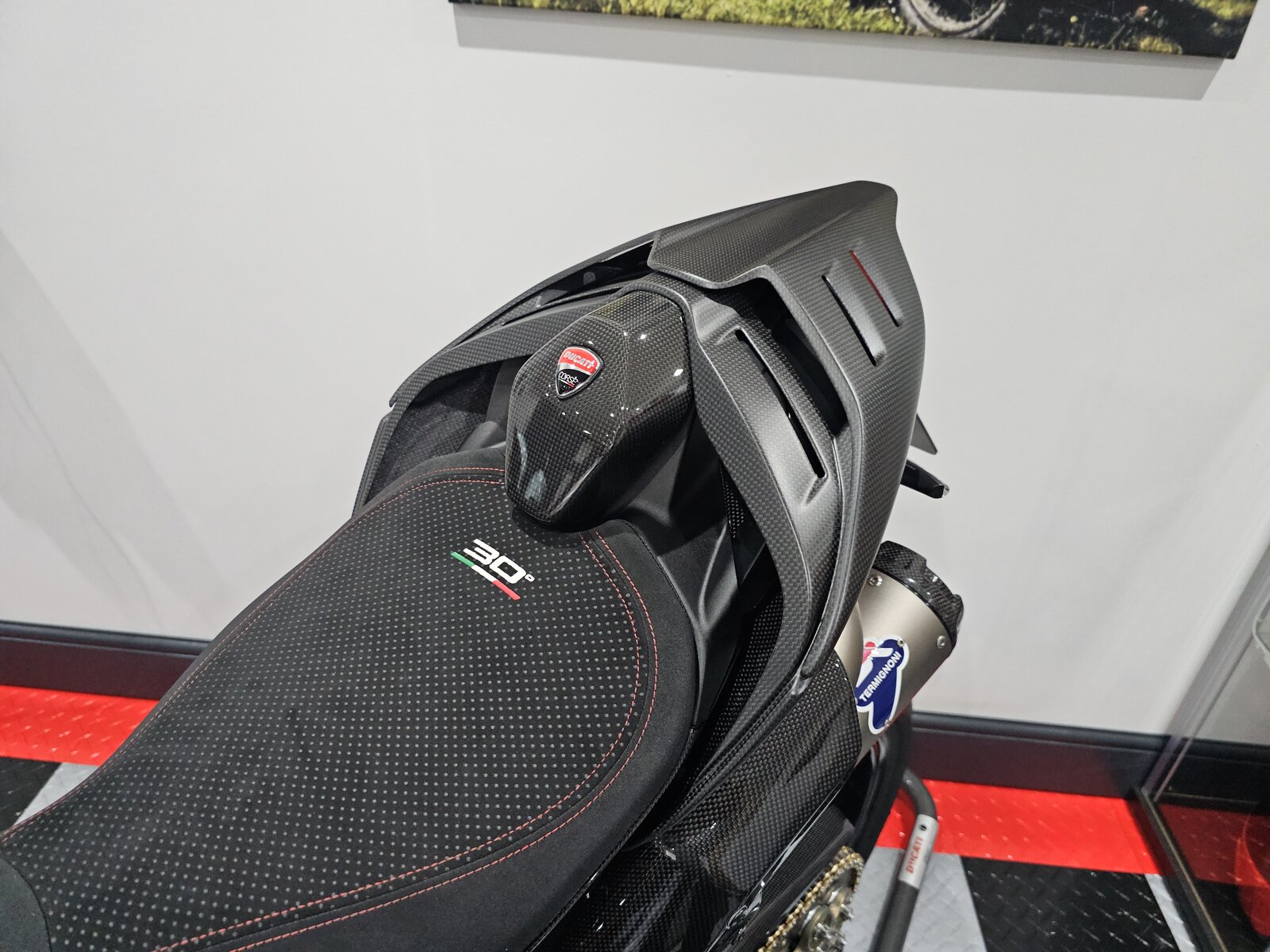

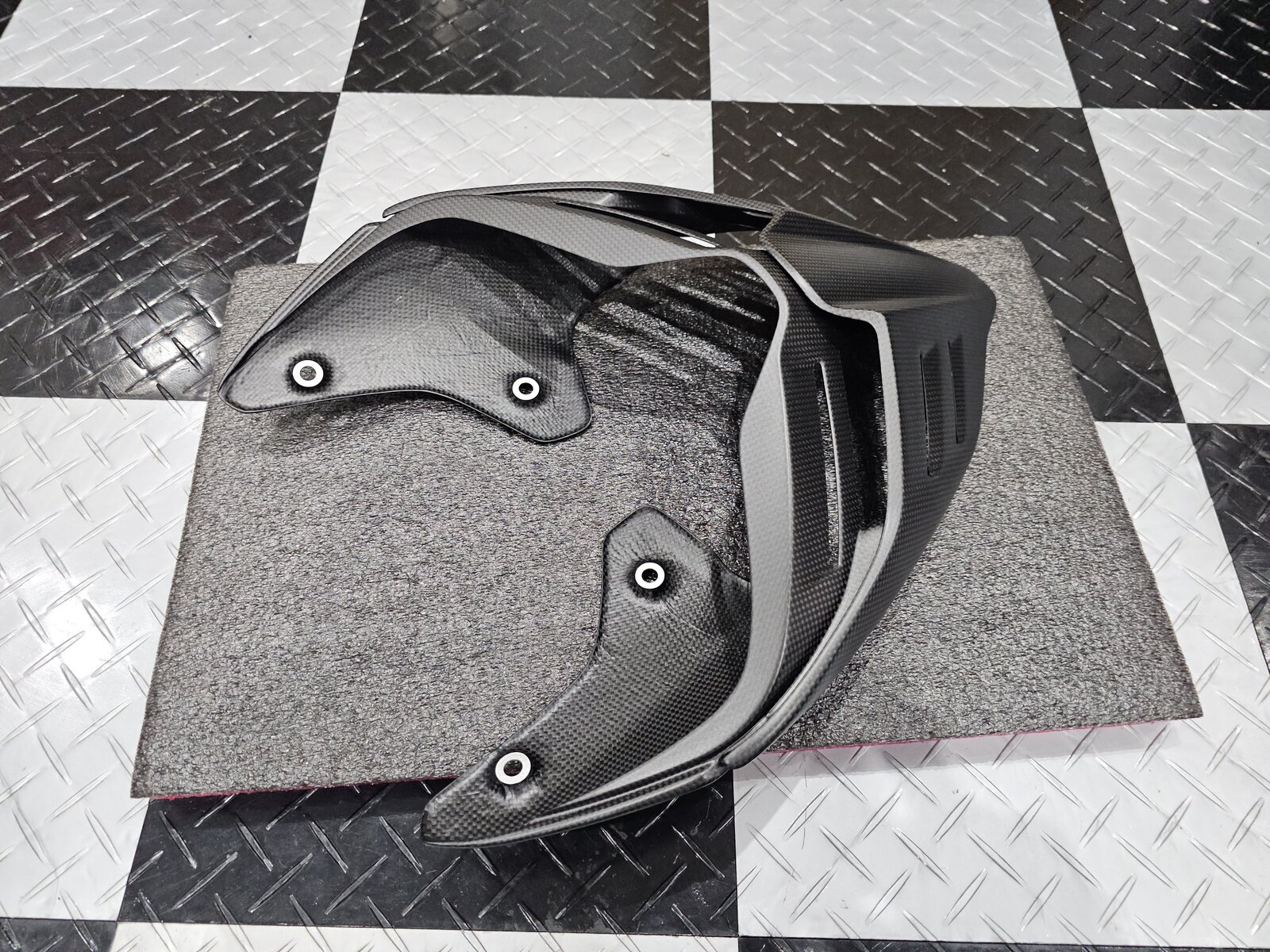

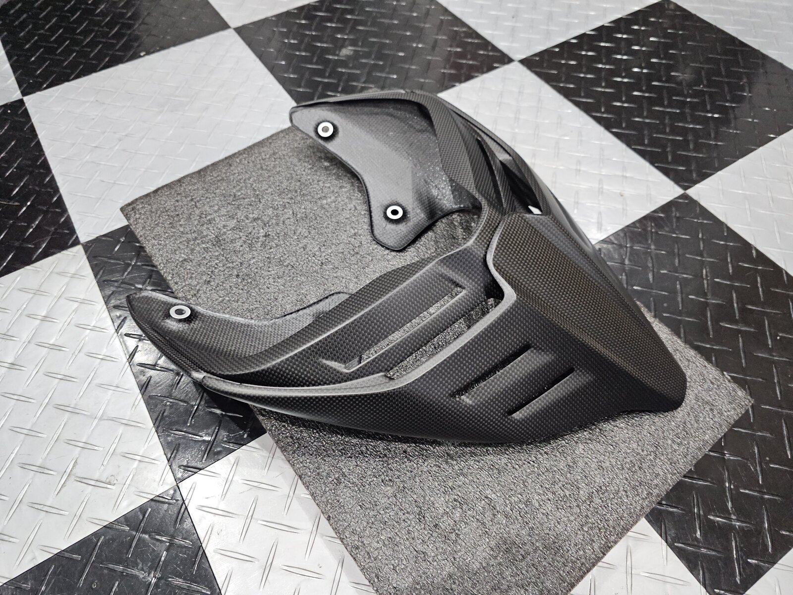

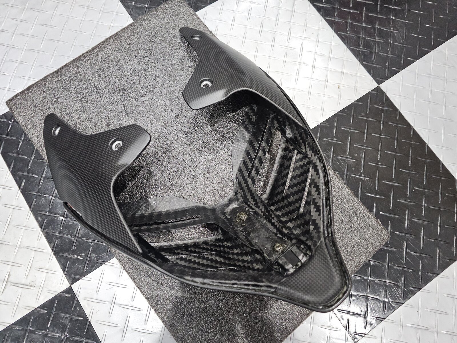

  5. Here is a sneak peak of the new Vulturebike carbon tail cowl, which will replace the OEM plastic one. It is currently being painted in a similar OEM paint scheme, to match the bike's livery. Really looking forward to seeing it finished. Pics to follow, once it is ready.
    Here it is mocked up on the bike, prior to painting, along with the bump stop.

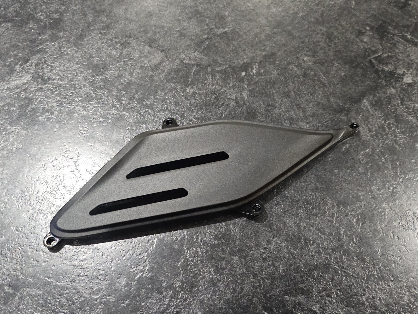

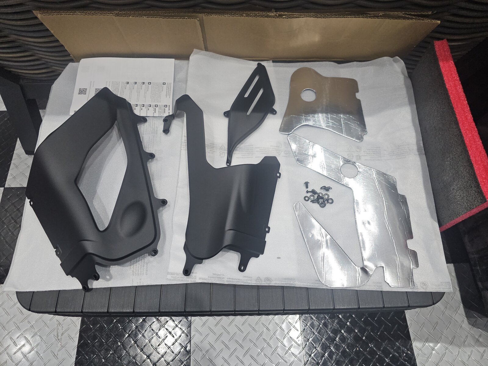

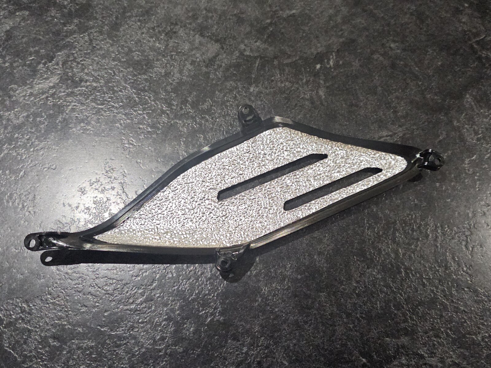

  8. OEM lower fairing extension panel kit finally arrived. The steel sprung washers that hold the panels to the lower fairings are an extremely tight fit, so much so that I had to slide them over some tapered metal dowel, to expand them a little first, in order for them to fit over the plastic lugs on the fairings. Heat reflective panels are also included, which required a few cuts here and there, so as they would better conform to the shape of each panel
    Unlike the full Akra system, the Termignoni pipework follows a different path, so that meant I was able to add in the infill panel, which ordinarily you can't. Not before making a heat reflective panel for it, however. A fiddly job as always, if you want it to be accurate. This infill panel is held to the extension panel by the four supplied self-tapping screws.

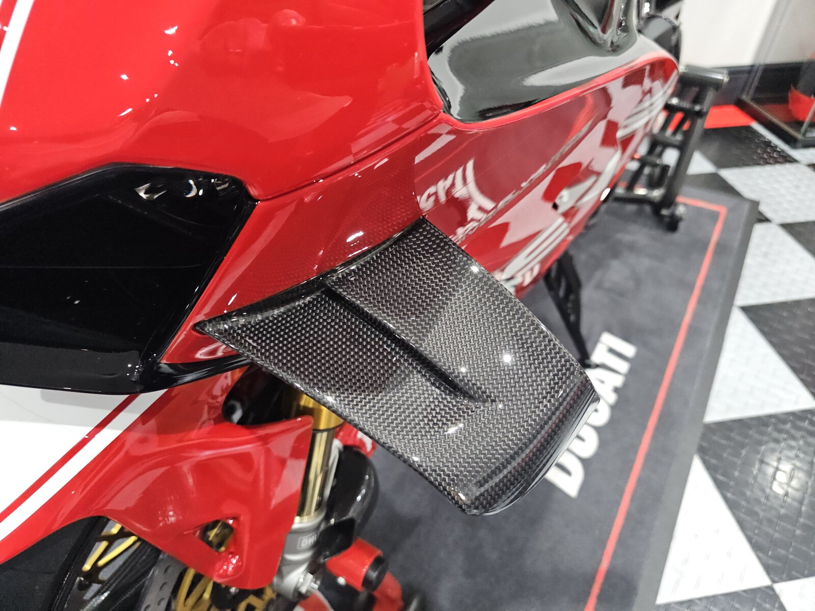

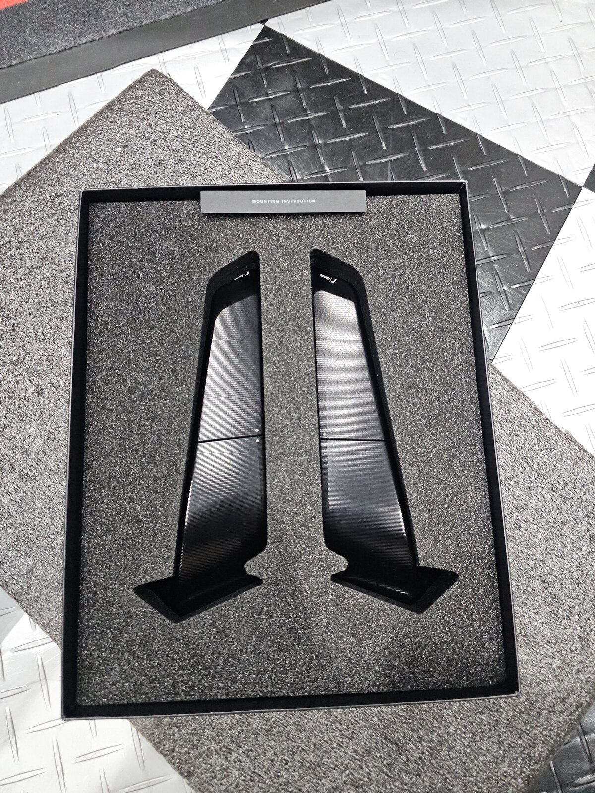

    Here's a view of one of the clear coated winglets, now that the bodywork is on.

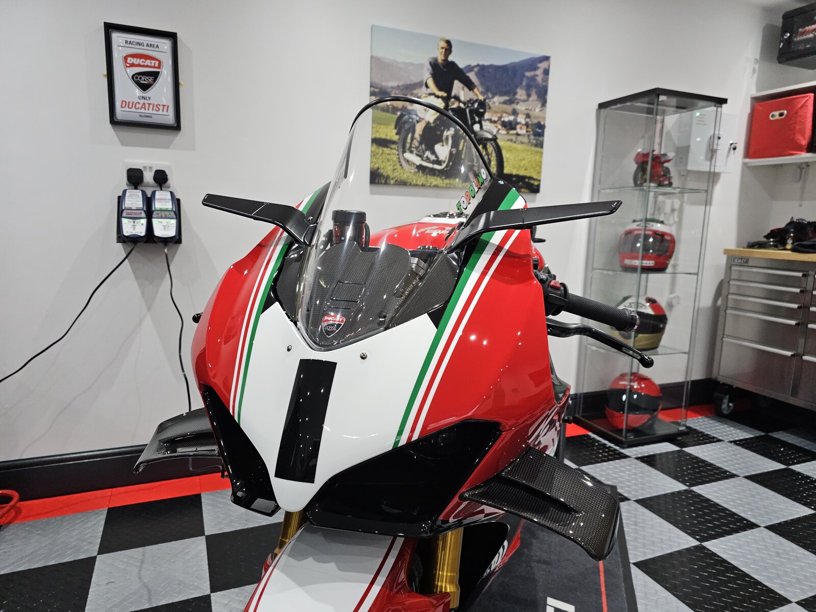

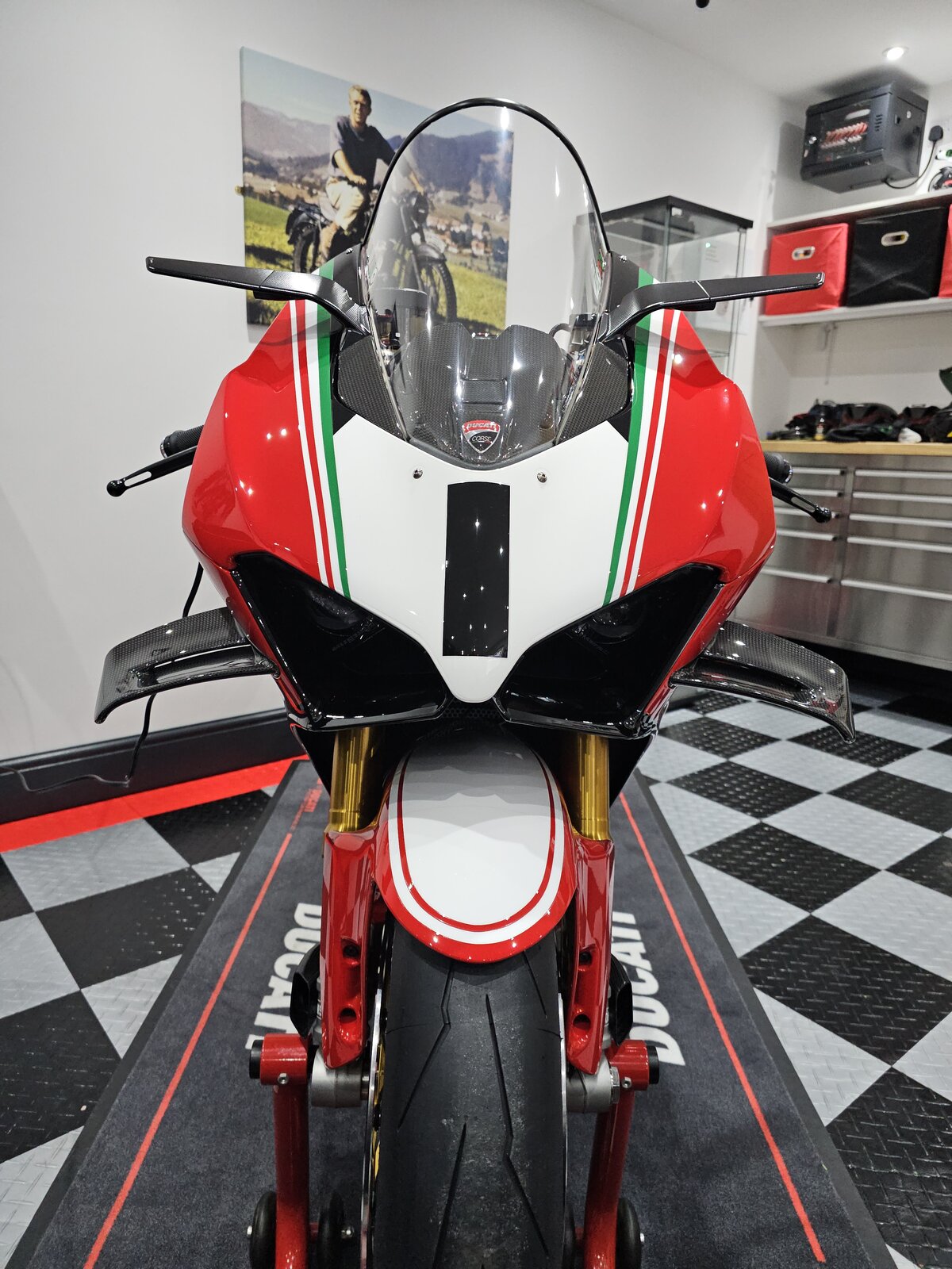

  10. Mirrors finally fitted. Just got to set the chain tension and torque up the rear eccentric hub and rear axle nuts, fit the painted seat unit (once it is ready) and the bike is pretty much complete. I will post up pics and a video when I am at the finishing post. Until then here are the mirrors in situ.

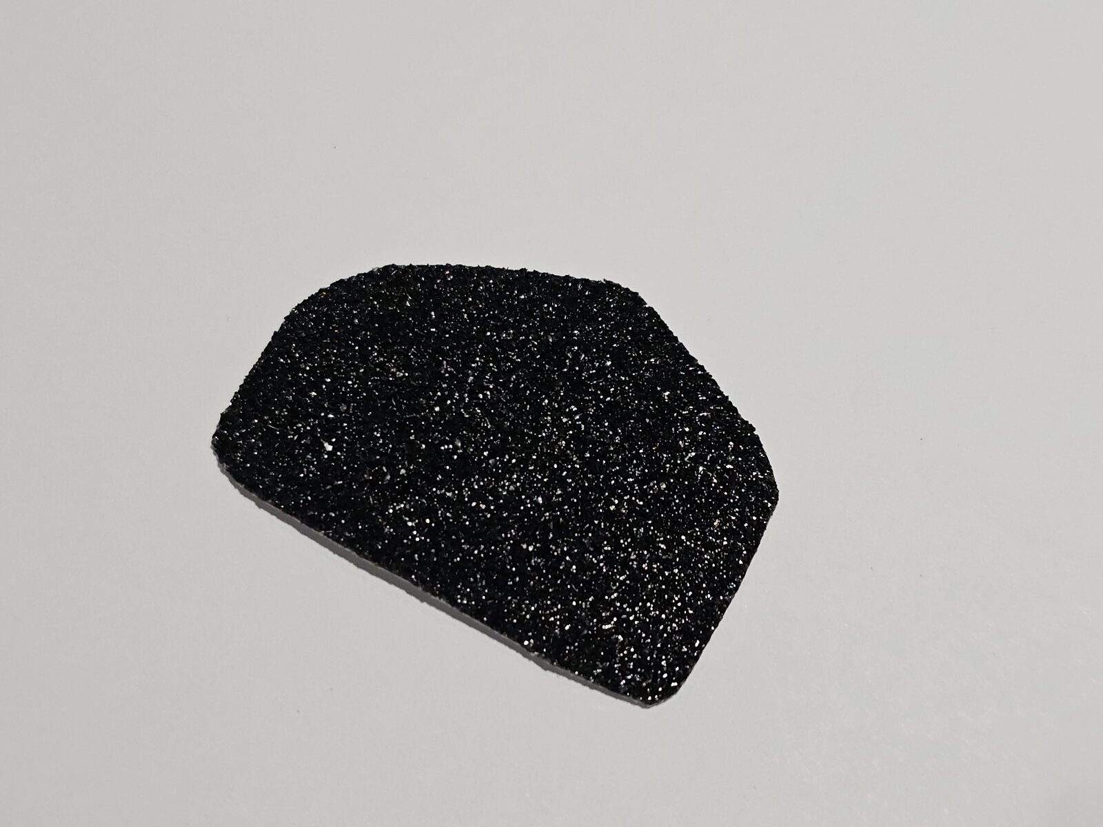

  16. Made up a protective grip tape adhesive cover for the underside of the side stand foot to protect the billet aluminium from scratches, or at least that's the theory.
