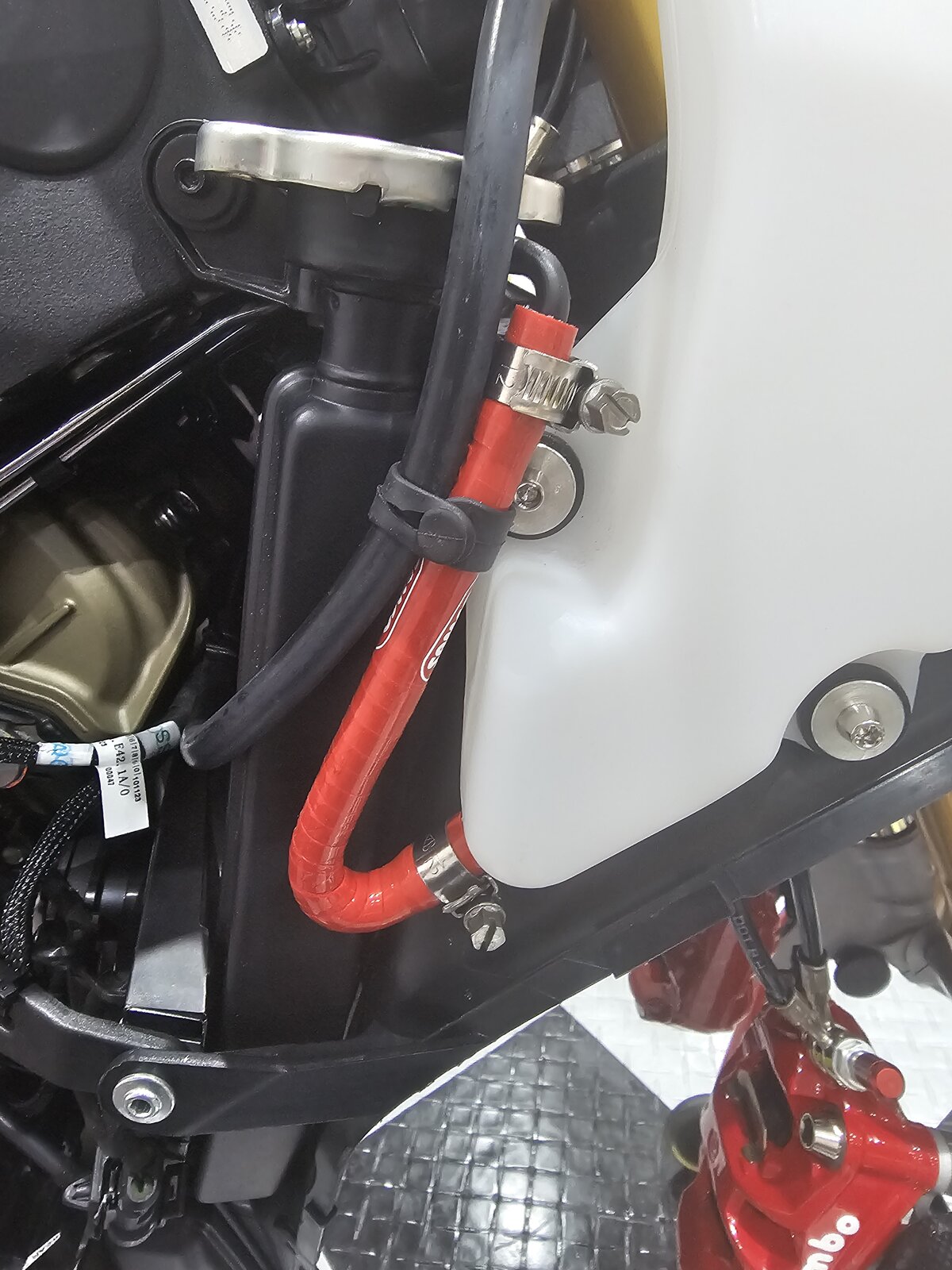

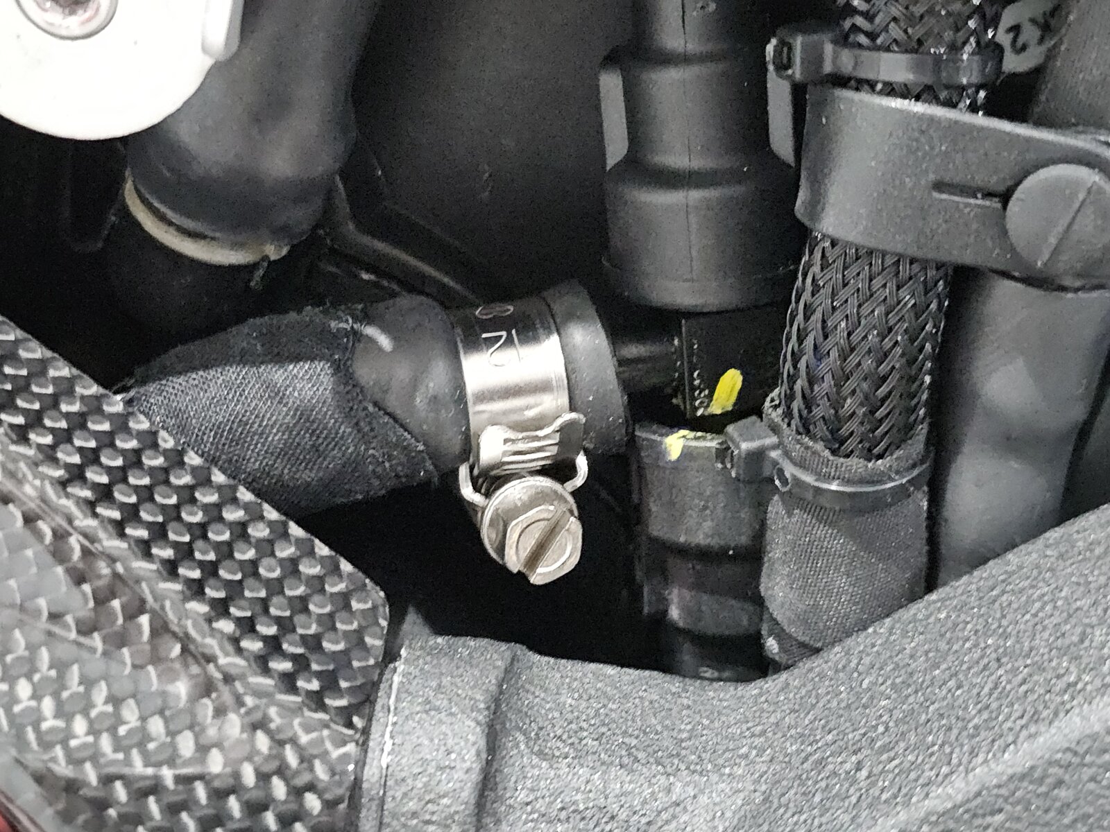

  4. So as I wait for some fairly major parts to arrive, I managed to finish off a few little jobs today, the first of these being the cooling system and this the last pipe in the SAMCO kit. The diameter is too large to use the stock wire clips so I used JCS stainless steel 9.5-12 clips instead.

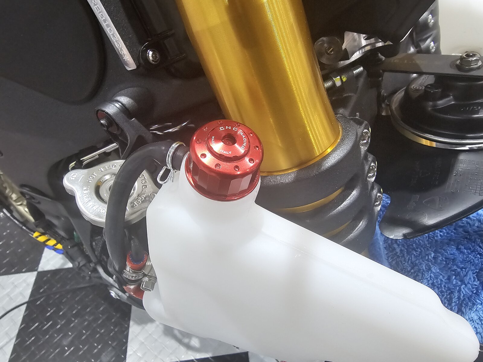

    CNC Racing billet expansion tank cap

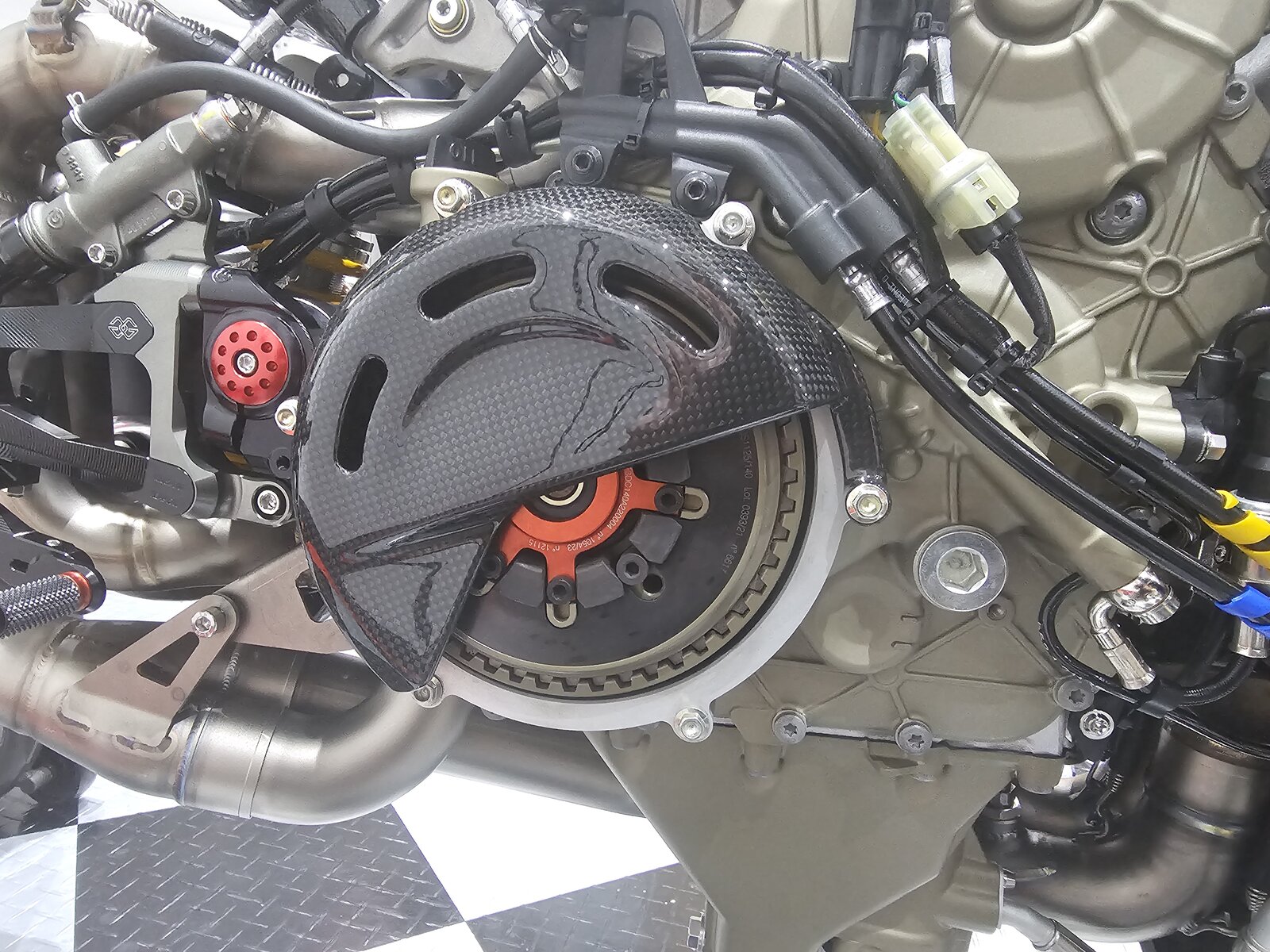

    Took the opportunity to fit the newly clear coated clutch cover. Torqued to 5Nm.

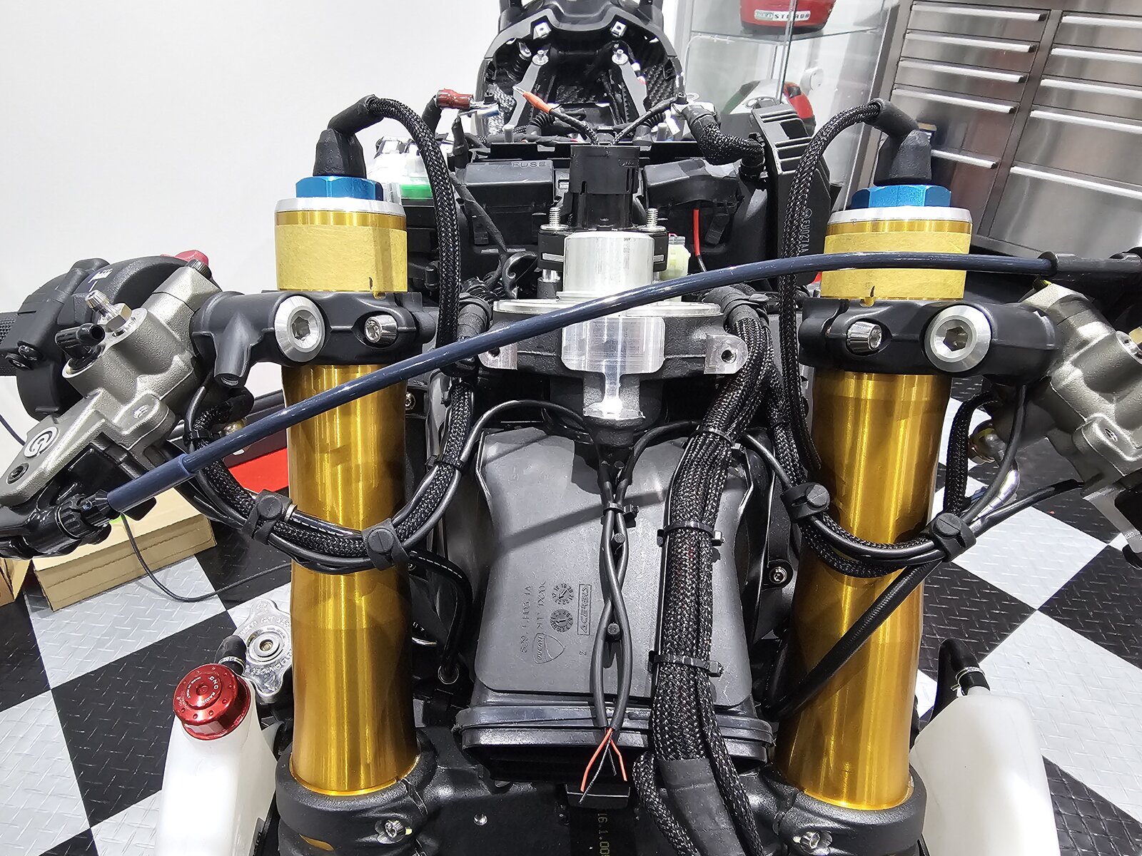

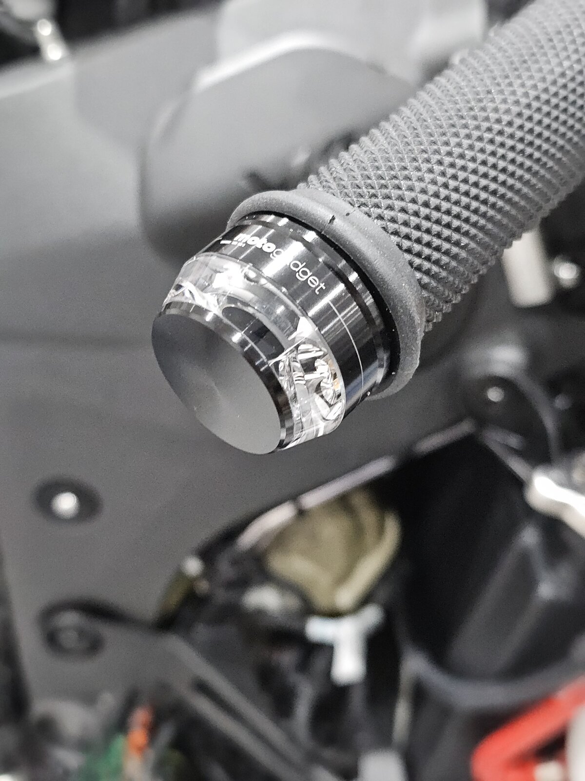

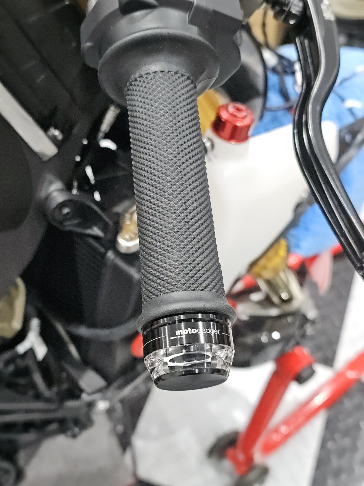

  9. Little bit more done today as still waiting on more parts. Fitted the MotoGadget bar end indicators which is a very fiddly job, as you have to thread the wires to each indicator through the handlebars and out through the 3mm hole I pre-drilled under the bars, then I bought some 3mm sleeving to protect the wires and routed them over the air intake duct. They will sit in the void under the front subframe so that there is enough slack in the wires when you turn the handlebars but I'll check this properly once the front wheel is back on.
    Here's the wiring to the indicators, which will largely be hidden by the front subframe. Lots more to tidy up, but it is getting there. I've got to solder on the pigtail connectors so that they'll connect directly to the OEM plugs on the front loom, but that will have to wait until they arrive.

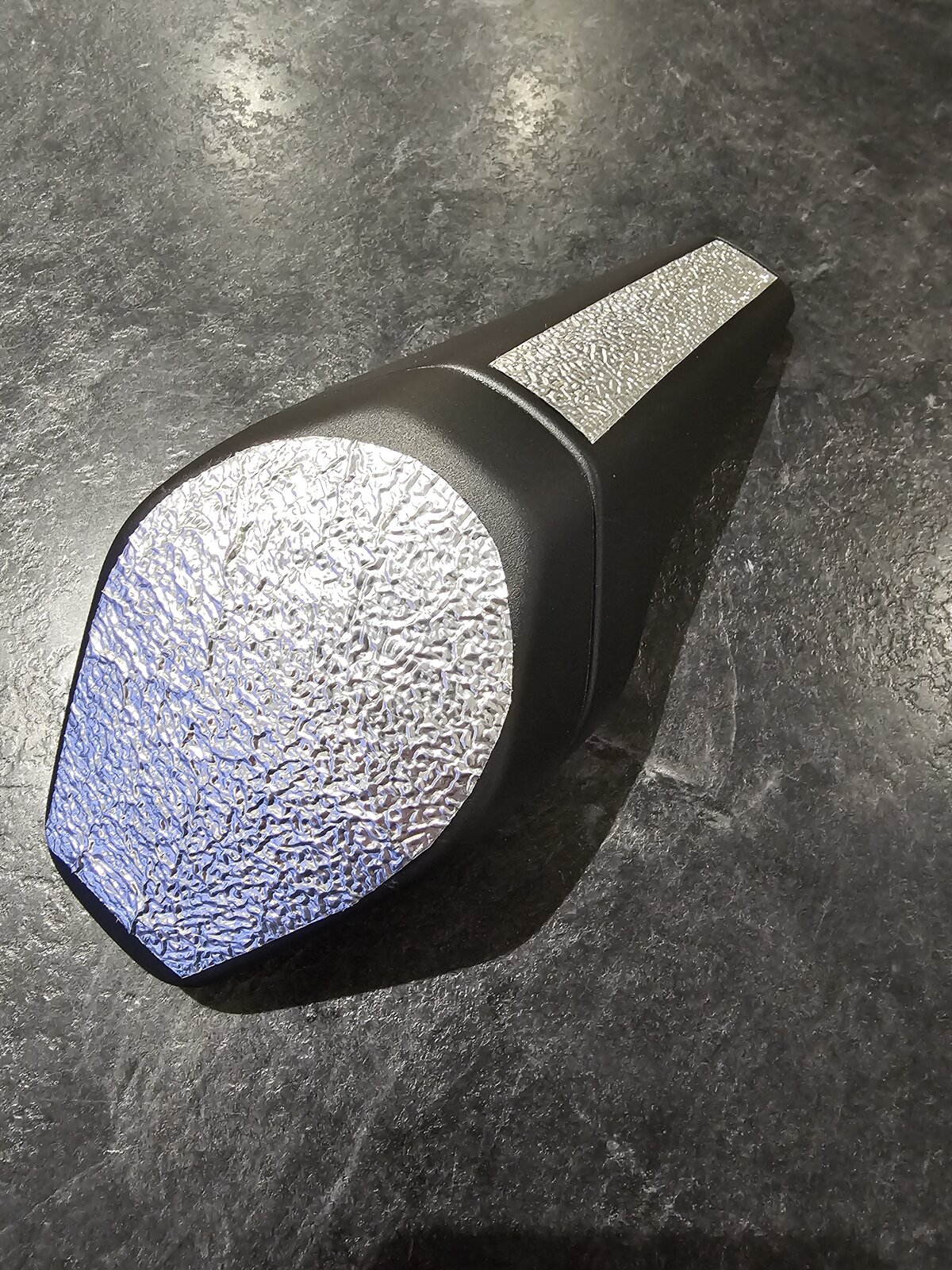

  12. Got to hope that tube of Parabond 600 I bought is still useable as I've a couple of Lieb Speed parts to fix back on the bike. Firstly the seat pad cover which, as with the subframe covers, I have prepped with some heat reflective foil tape onto which the sealant is applied before bonding the carbon cover on. There are all carbon versions but I found they flext too much when trying to lock them in position on the bike, so this option is a better solution IMHO.

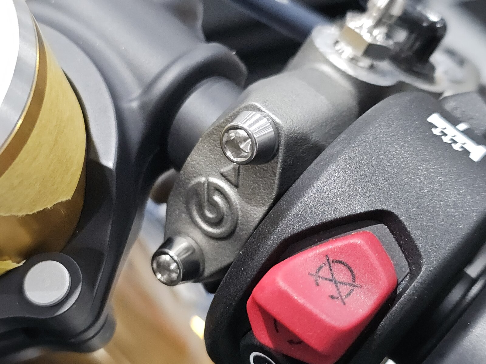

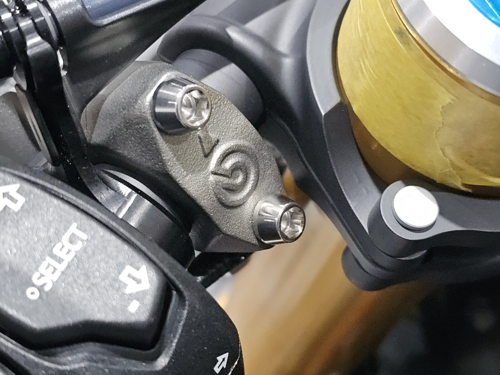

    Pro Bolt perch bolts M6 x 25mm, torqued to 10Nm

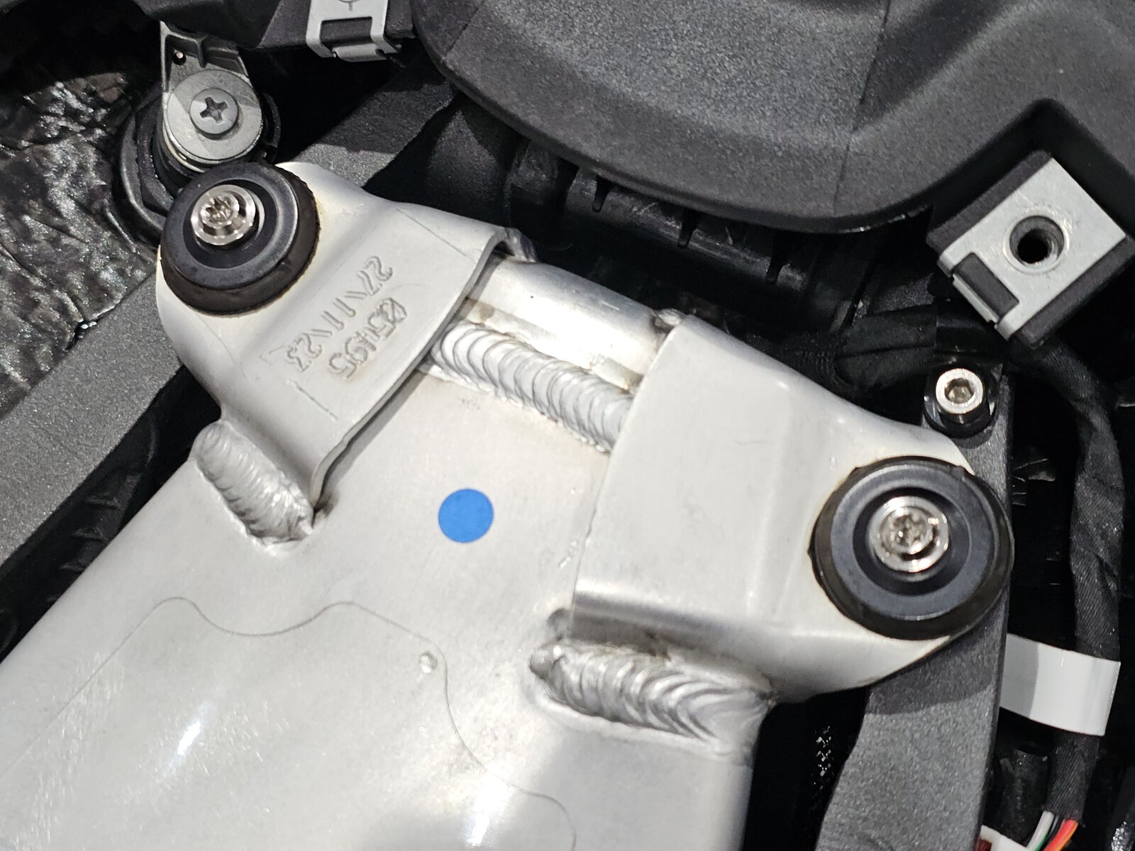

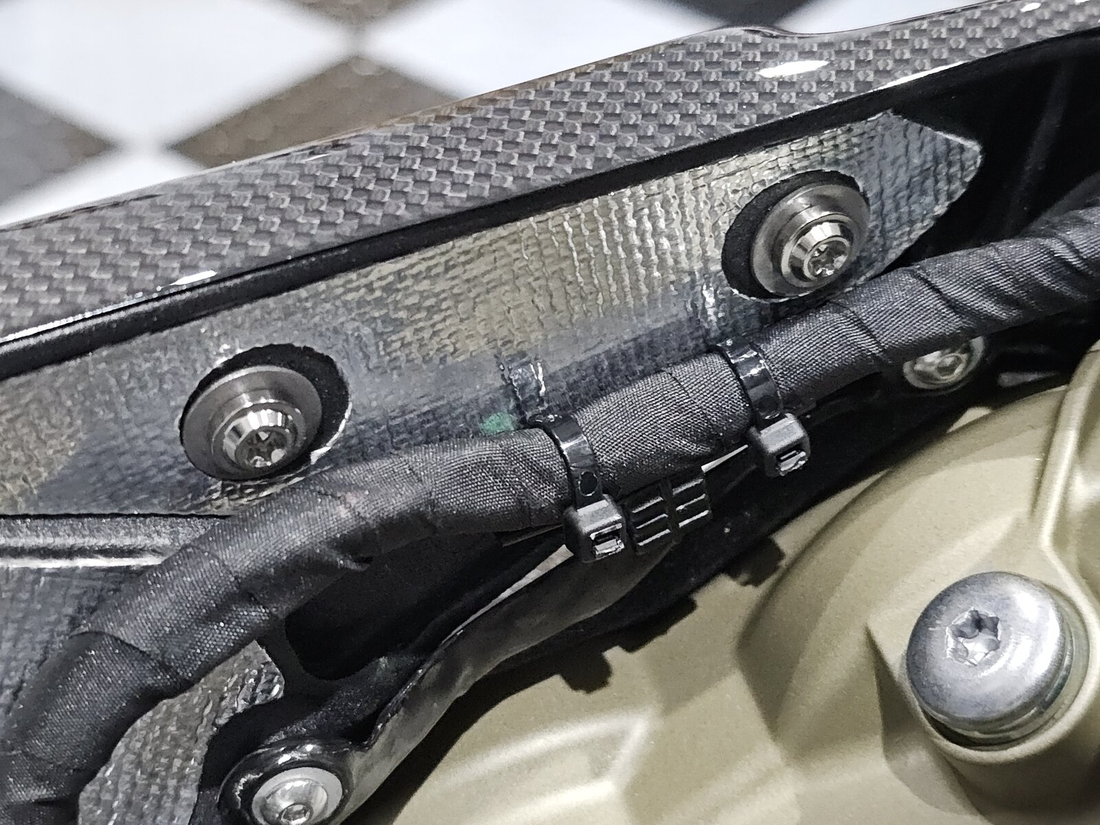

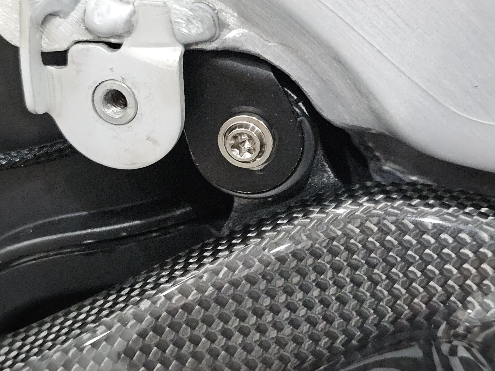

    Last few of the titanium fasteners from RaceTi. This time the subframe cover bolts, M5 x 12mm. Torqued to 2.8Nm.

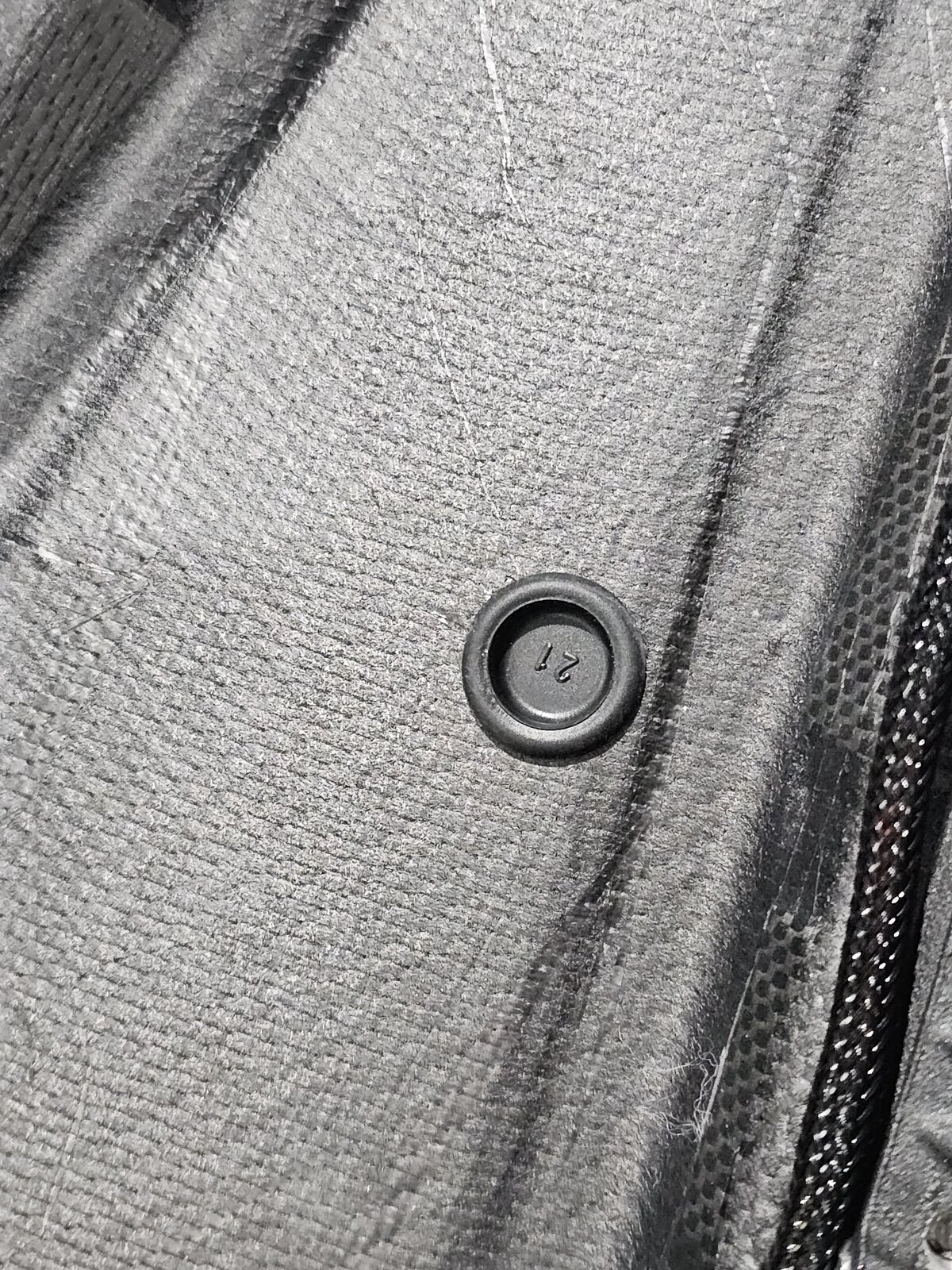

    Fitted a 21mm grommet in the Termignoni undertray.

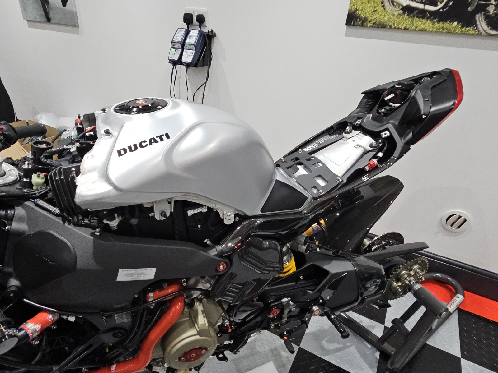

    Next up was the fuel tank...
    Again RaceTi bolts. The front ones are M5 x 30mm, torqued to 6Nm
    Then the rear two bolts. M5 x 10mm. Again torqued to 6Nm.

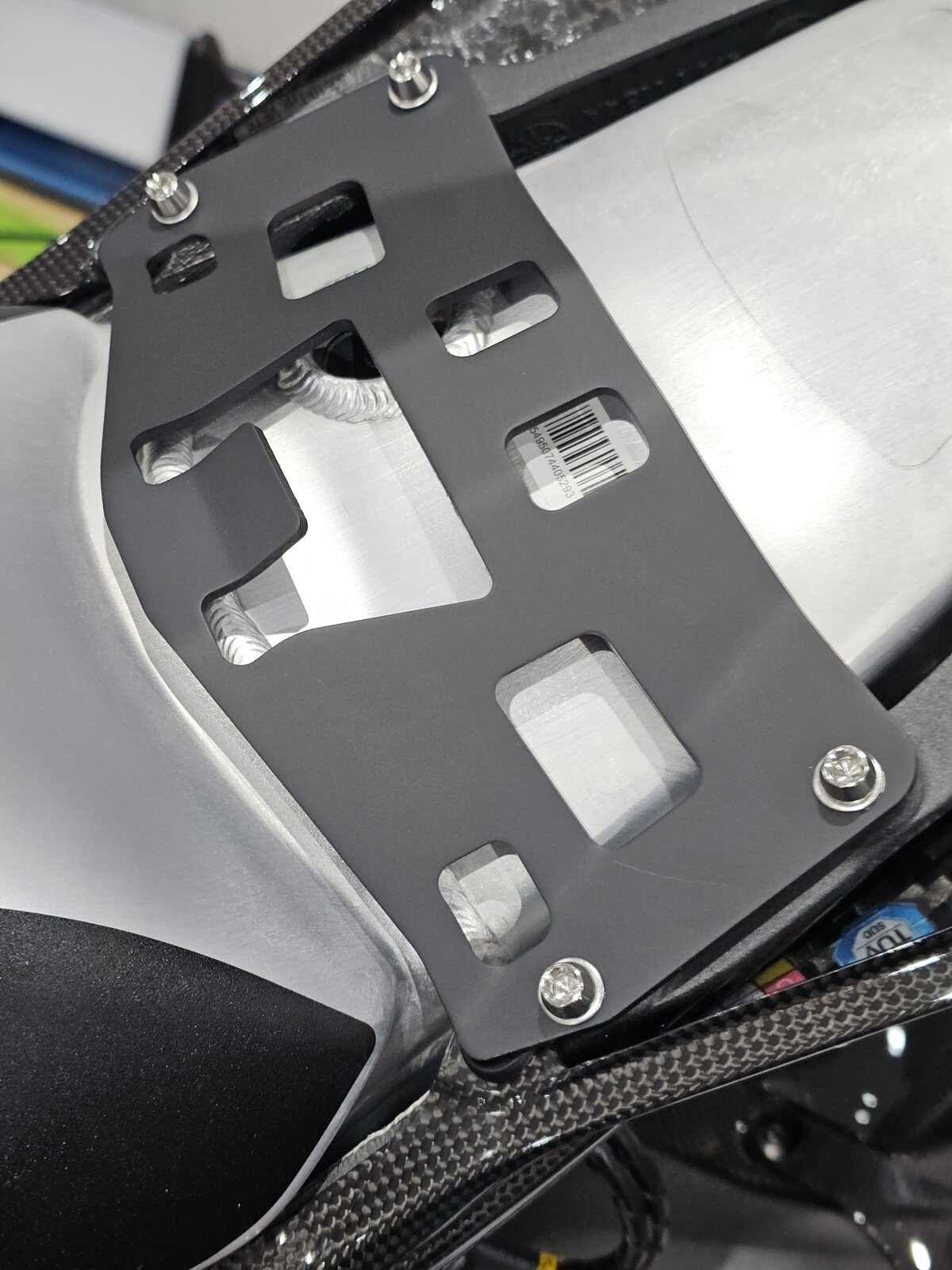

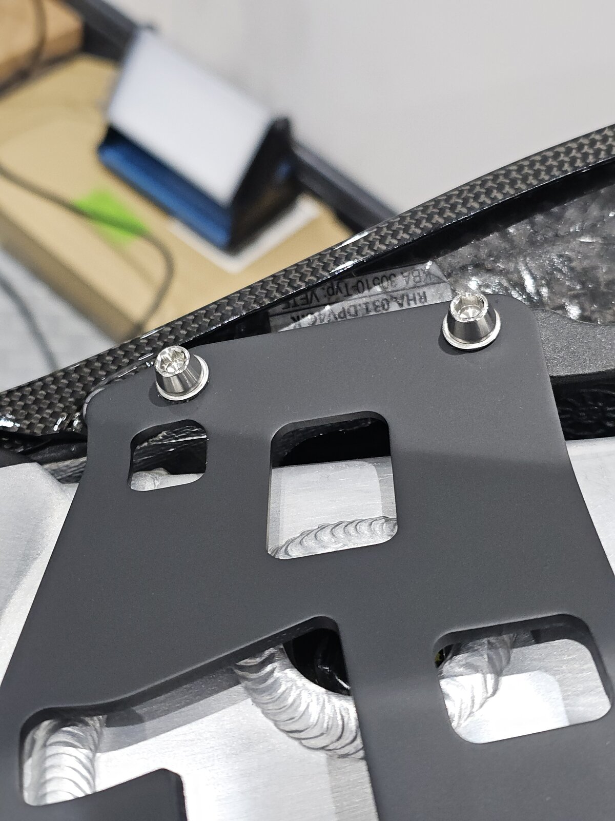

    Next the seat bracket (which I had Cerakoted "Glacier black") fixed in place with 4 x Pro Bolt M6 x 10mm bolts, torqued to 8Nm and ACCU stainless steel M6 washers.

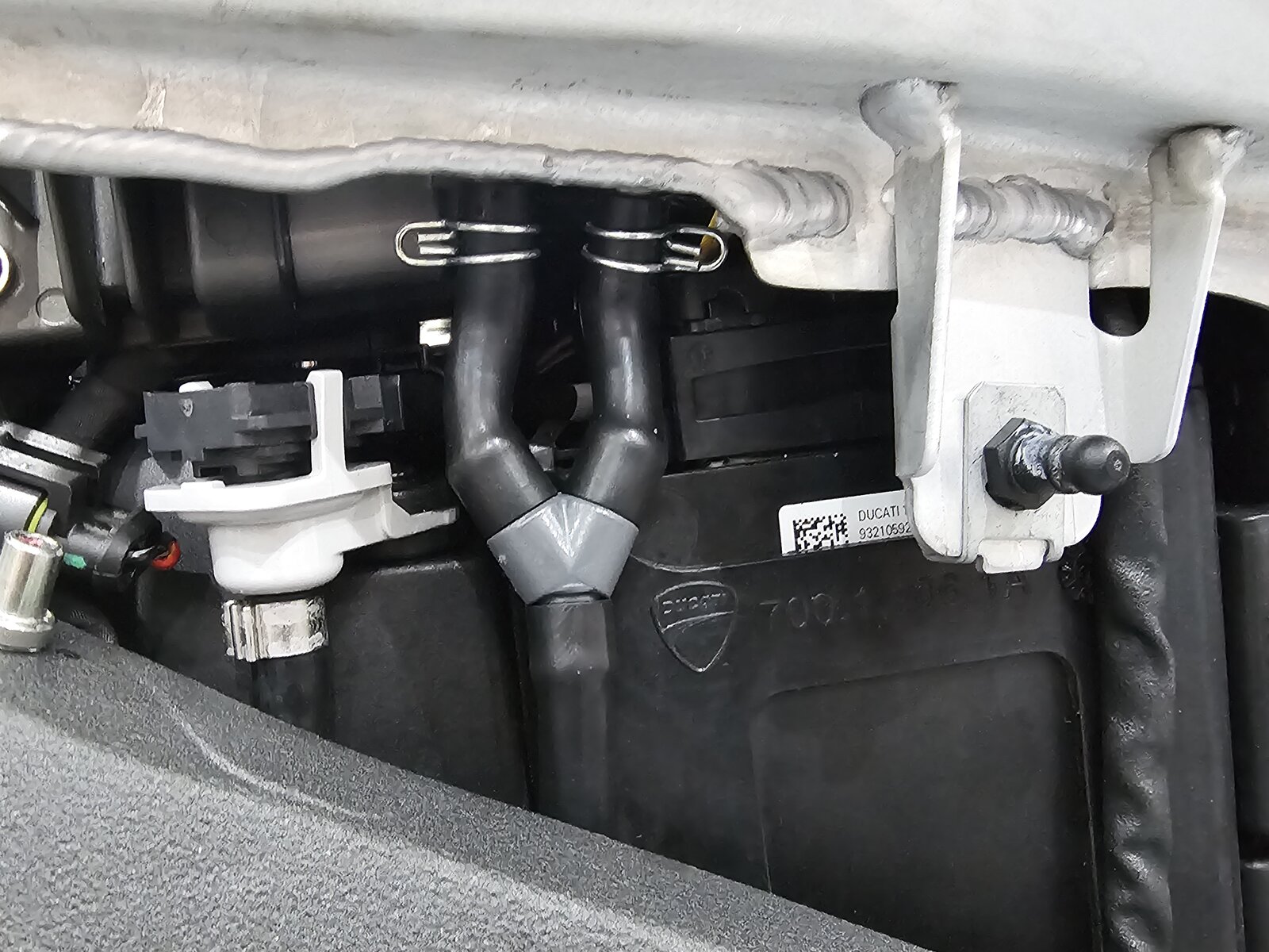

    Next the two tank lines (formerly the one on the left would have gone to the now defunct EVAP canister and the right one was the fuel overflow), so the Y-join allows you to run a single line to the drain point under the bike. Secured in place with two new zinc plated clips.
    Last job was to connect the fuel pipe. I discarded the OEM clip as it's made of swiss cheese and prone to fail, so I used a JCS 9.5-12 stainless steel jubilee clip. Tightened by hand, not too tight as the fuel delivery barb is only plastic, so gently does it.
    And here's the tank finally back in place on the bike.
