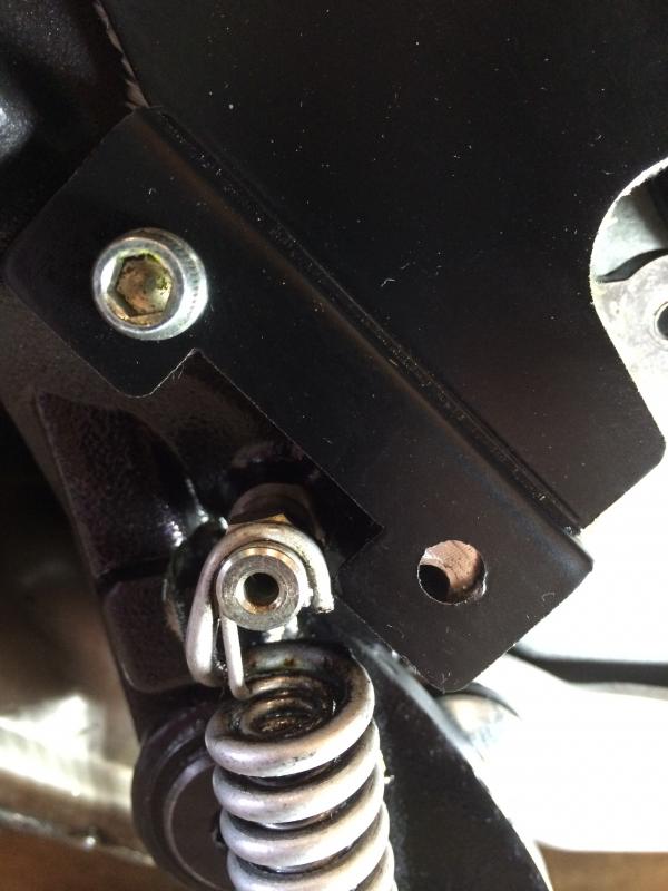

  4. Mine fouled the spring but literally 2 seconds with a file sorted that. I then used a bit of permanent marker to touch up the edge, job done.

  8. My centre stand has been removed and refitted a dozen times for various reasons (but not for shortening the leg). It is true that the springs can be fitted either way round, but that doesn't make any difference to how close it is to the corner of the heat shield. Like I have said before, this is not a big deal, I am not complaining, and I am certainly not seeking a refund. I just mentioned the need to do a little bit of filing-down for peoples' information. No need to make a fuss!
    As you can see, it would not be any better if the spring were the other way round, so that is a red herring. I have filed off the absolute minimum to allow the heat shield to clear the spring by a whisker.

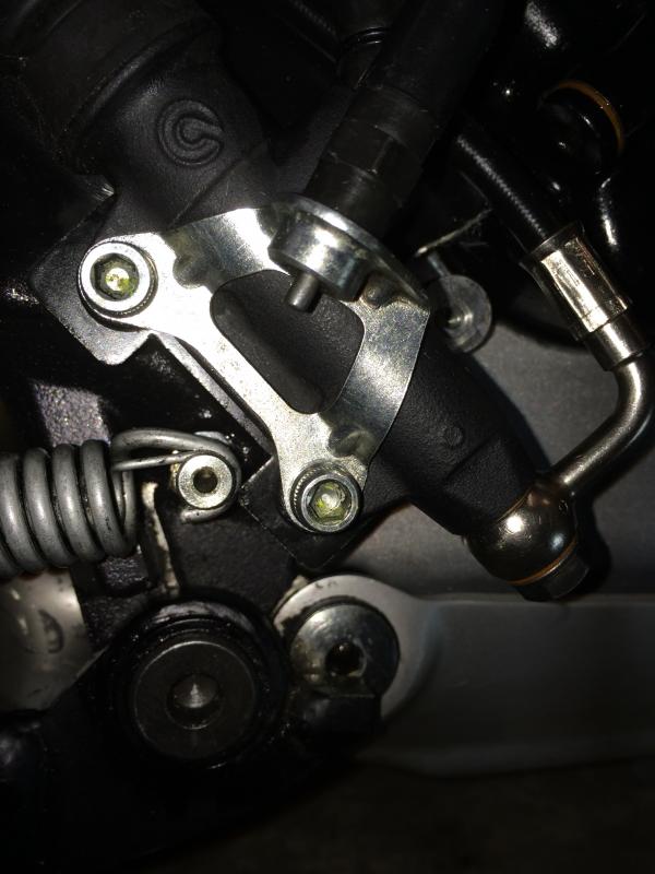

  15. righty ho lets put this issue of the bracket not fitting to Bed, I got round to fitting mine today its a 62 plate S touring with factory fitted centre stand, right here we go, I took out the 2 bolts that hold the master cylinder and brake switch lined the bracket up, and it would not line up as the centre stand spring was in the way, initially I tried to pull the spring over, then thought about putting the centre stand up, and working off the side stand, and Viola it lines up, very close to the spring but it lines up, pics below before and after stand put up 1 bracket.jpg
    hope this is of help :upyeah:
  16. Thanks for the pics satzoomer. I'm currently working abroad at the moment so won't get to fit mine for a while. Apologies if this is a 'bone' question but I take it the bracket then sits behind the spring once tightened up when you put the Mutley back on the centre stand?
    Mark H
  17. As per the pic above it touches the edge of the spring when the bikes put up on centre stand couldn't. Hear any scraping of materials so looks to be ok, probably could do with a few mm taken off edge by the spring, if I was being picky
    And should have cleaned the bike before I took the photos it's shockingly dirty sorry all
