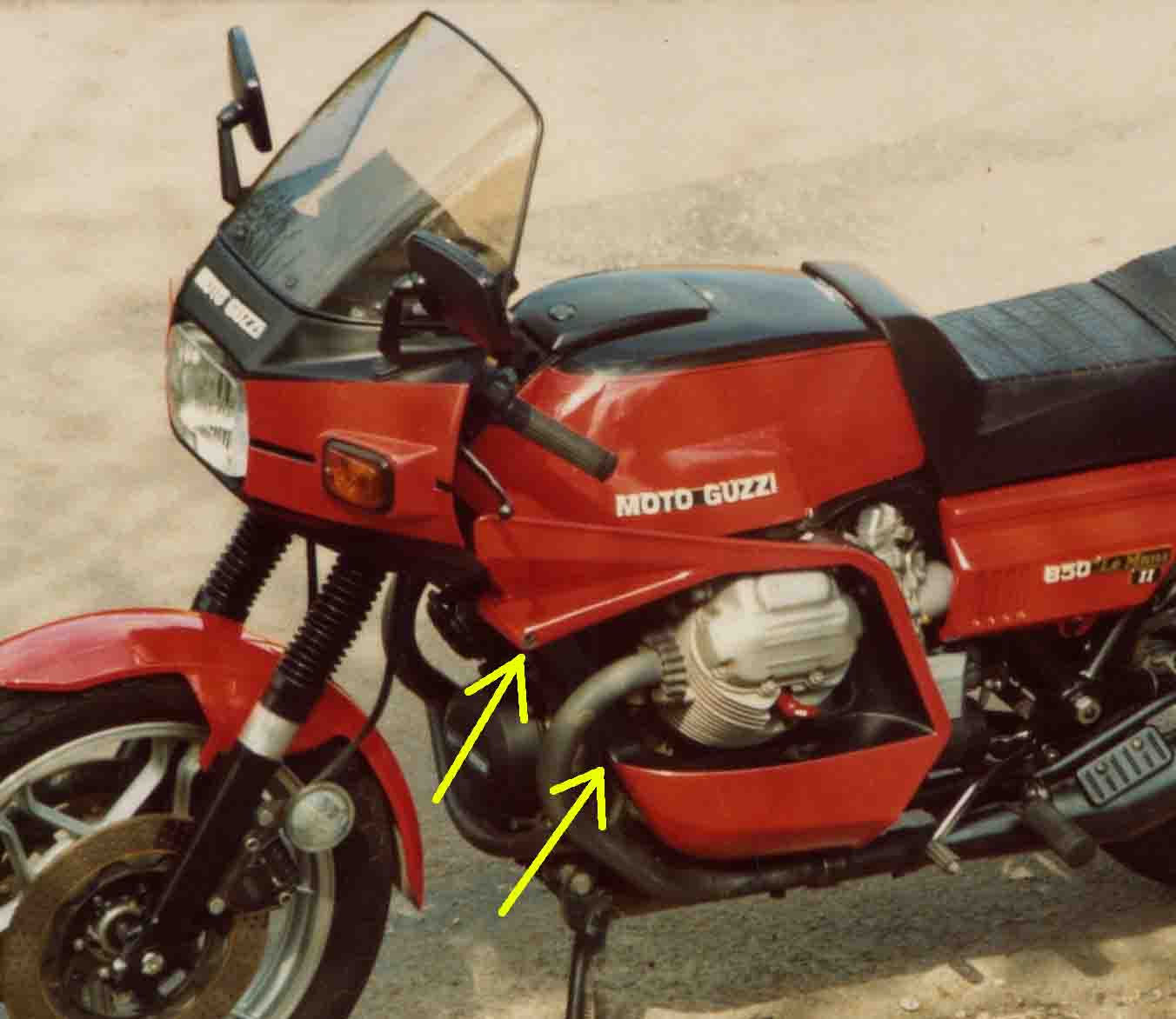

  14. Yep....Mine was a 1980 registration built 1979......I had the bad (rough) fairings but they were replaced under warranty because the cracks were so bad after 1000 miles.
    The nose fairing may be OK paint wise, and the glassfibre shouldn't crack; but you may have to do a bit of reinforcement on the inside of the lowers.....where the two yellow arrows are on mine below.
    That's assuming of course yours haven't already been replaced.
