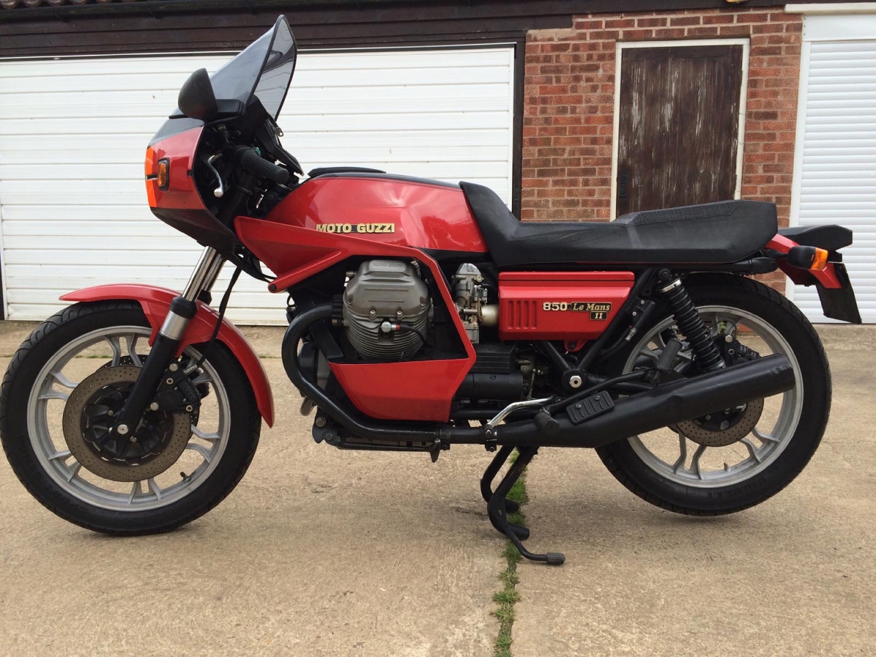

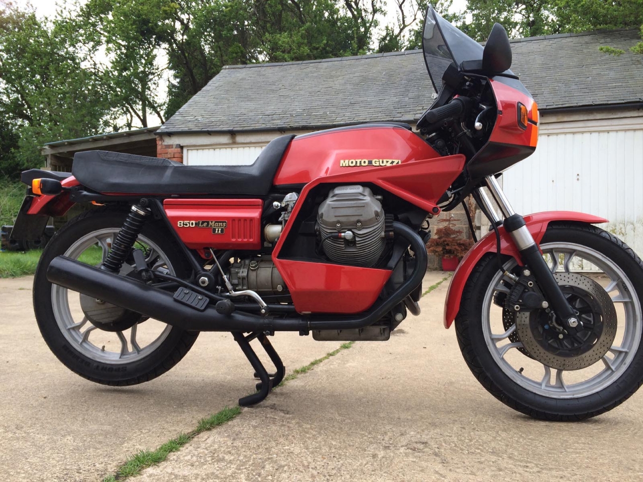

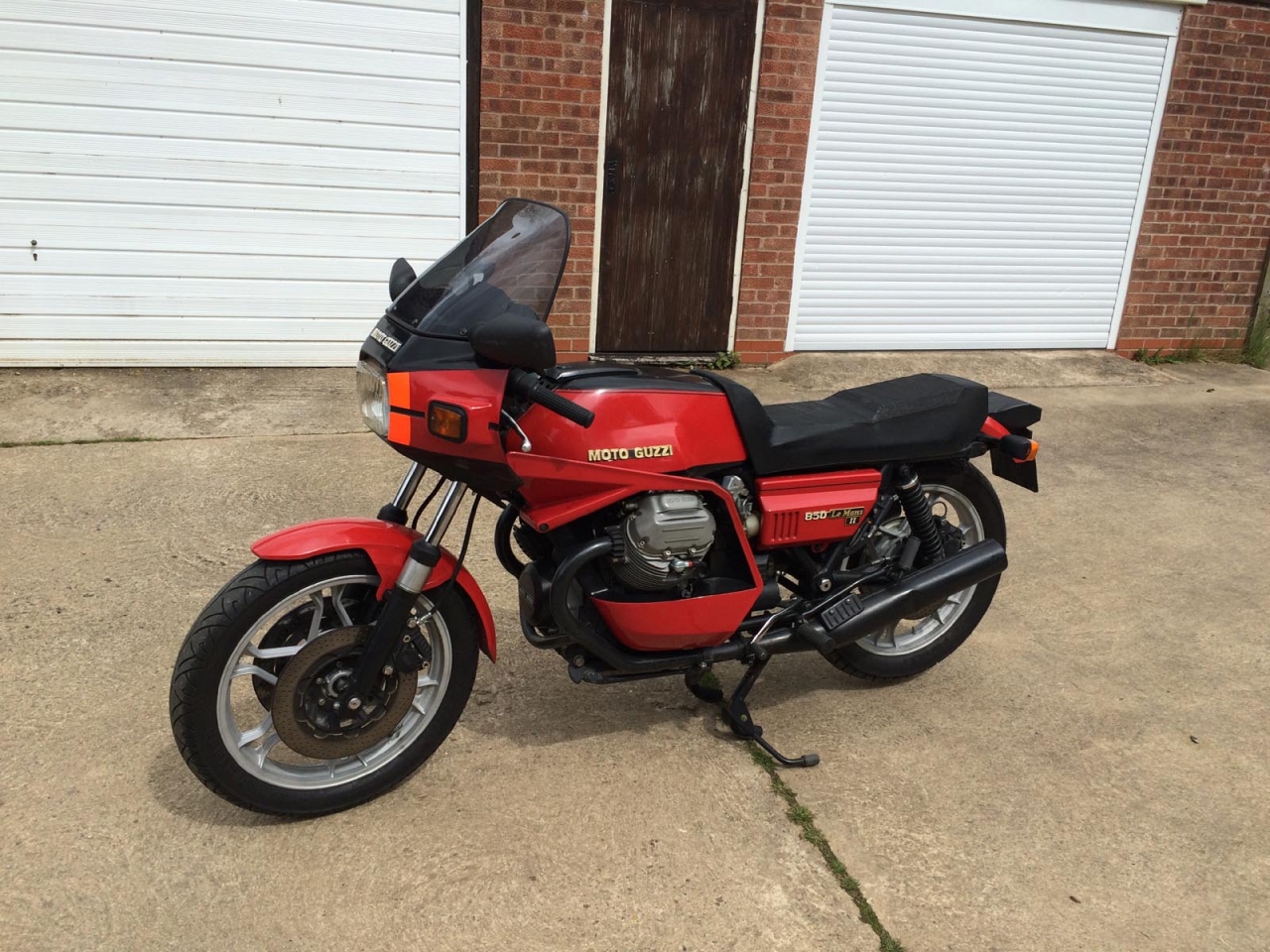

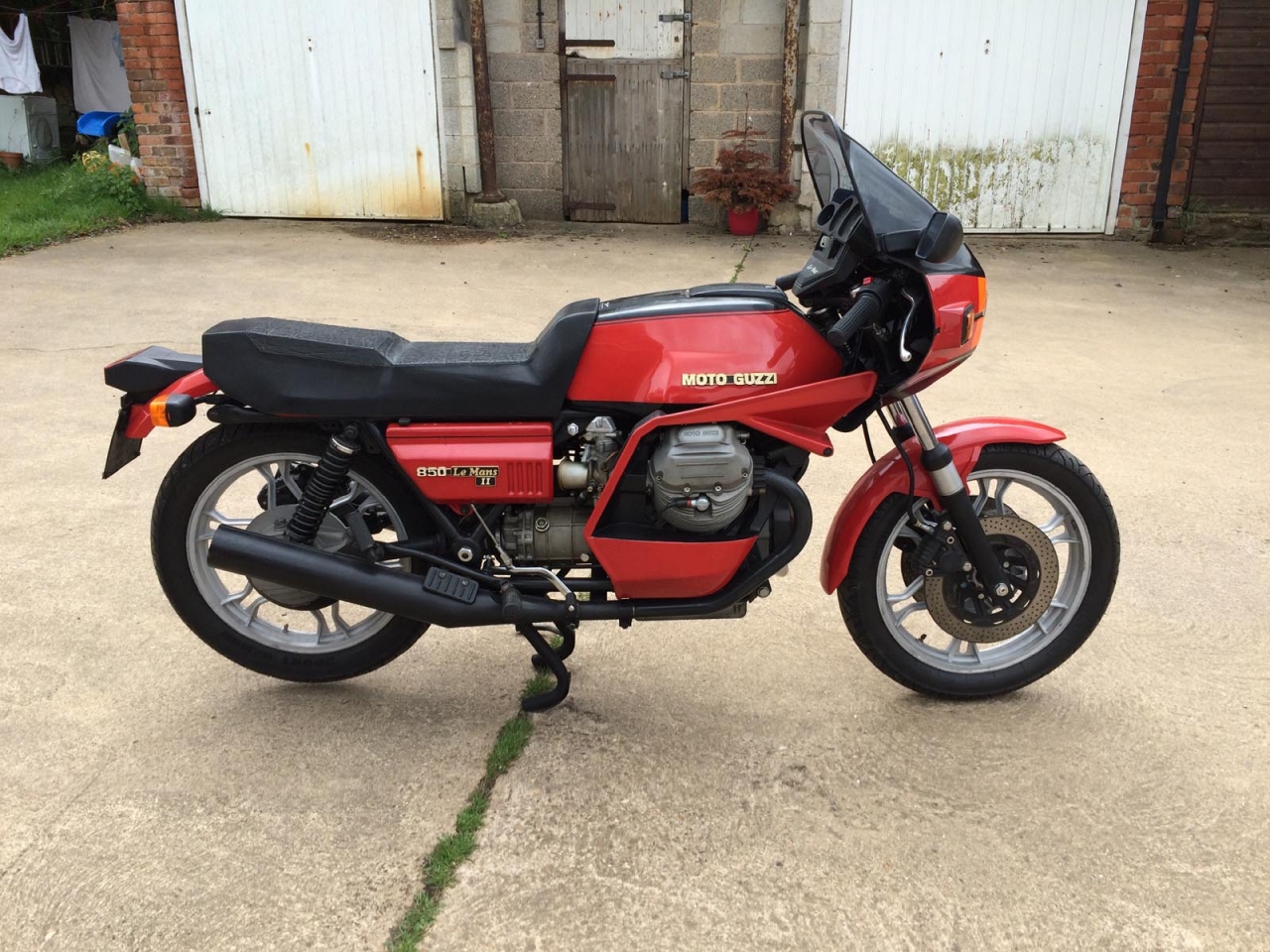

    Here's a few new pics;
    Just need to get it legal & serviced. :upyeah:

  5. F-me that's in good nick........
    But I'll bet those silencers and header pipes have been changed or coated with something........they don't look that good after just 1000 miles even if wiped over with WD40.
    Anyway...........A couple little things to watch out for while you are piddling around and getting it ready.....
    1) Check the centre stand for cracks where the brace is and where the kick horn sticks out.
    2) Make sure you get used to the sidestand....Immediate flip-up only......Always park uphill if using the sidestand.
    3) When putting it on the centre stand, hold the grab handle with the right hand, clip on with the left.....then wheel it backwards and push down on the centre stand horn with right foot............It will just roll onto the stand (unless you miss with your foot that is).
    4) You may find a slight weep of oil from an oilway drilling boss just forward of the gearbox oil level plug......There is a lead plug in the centre and a small thump with a decent round end drift should cure it.

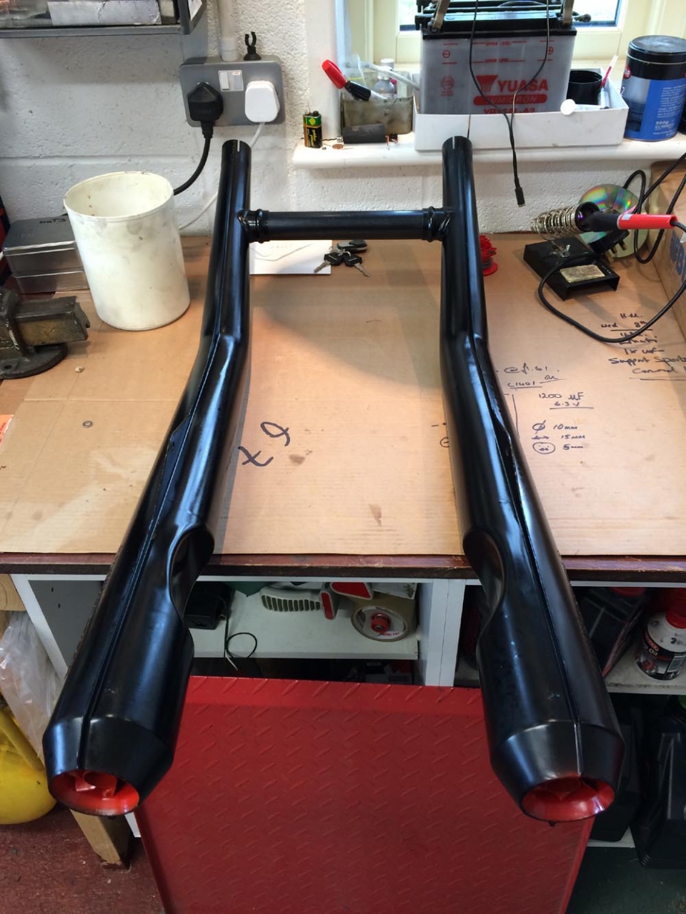

  6. I'm told they're the originals, the left silencer has a dent and a few scuffs and although I told myself I'd keep it original, I have to confess to having bought (few beers, late night, bored etc.) some replacement, Lafranconi competizione exhausts;
    It's the swirly red bits that got me... :Shamefullyembarrased:
  7. Lafranconi's sound awesome on a Guzz..................Goooooooooood choice
    Keep the originals to sell for a gazzilion squid along with the seat on Flea Bay.
    Me I'd take off a lot of the original stuff and store it so as not to damage then bastardize MKI it or cafe it a bit.
    Then put all the original stuff back when you come to sell it.
