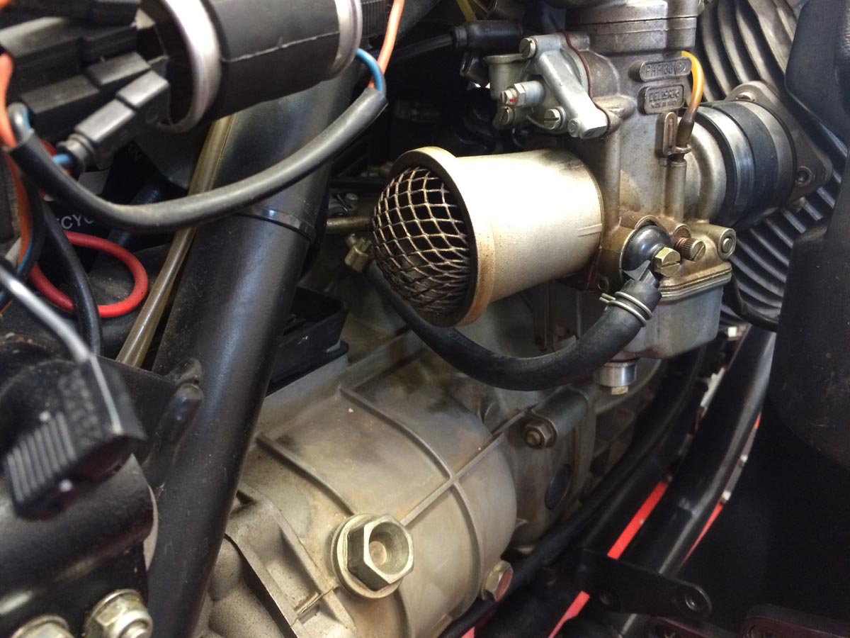

  1. One thing I have found out about the carbs is that if I leave the fuel taps on, they leak...
    At least the right one does, just been out to the workshop and the right side of the engine's covered in petrol - maybe that's why it's so clean. :rolleyes:

  4. Carb leaking.....dirty float bowl/needle valve or the fuel level is wrong.........easier to deal with than Ducati BDST38s.........it's only gravity feed..........no pump etc.

  6. PHF 36 cast into the side of it, at least on the RH side - the LH looks the same but 'mirrored' and I assume the writing is still on the RH side of the casting, so under the tank.
    No filters either, only a coarse mesh over the bellmouth...

  8. The coarse mesh / grey plastic bellmouths are the correct OEM ones.
    I tried K&N cone filters instead, but apart from the fact I found them a bit restrictive of the performance, the damn oil from them would get everywhere, because these carbs need to breathe..........
    ......I then found spun ally Malossi ones with a finer mesh........they worked fine and looked pretty good as well...

  14. Turns out the leak is from the bolt that holds the float bowl on, it passes through the float bowl and has a fibre washer which has dried up and is leaking a bit. I will get new ones along with other seals, gaskets and jets (if required) when I get into things deeper but, for now a light smear of threebond has cured it. :upyeah:
