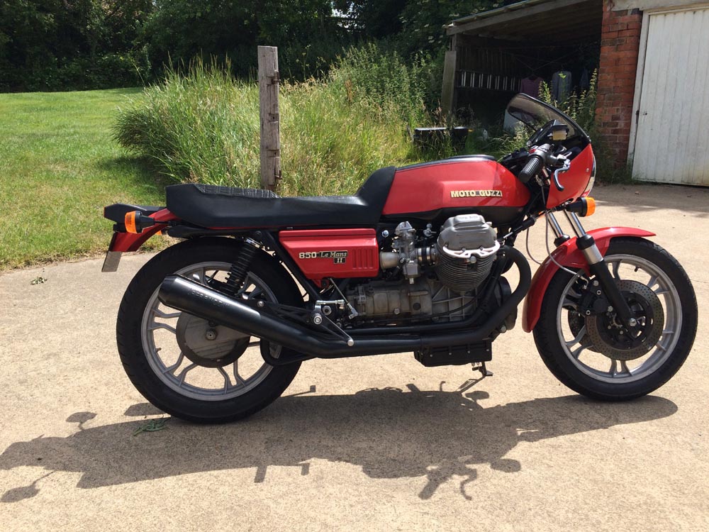

  9. To update, I have made a few changes.
    Reversed the gearshift to 1 up, 4 down combined with rearsets.
    De-linked the brakes & rebuilt the calipers with new seals and alloy pistons (old chrome pistons had some rust and were sticking)
    Fitted braided hoses (the rubber hoses were date stamped 1979) & changed the master cylinders to get the right ratio now that the brakes are de-linked - smaller bore master on the rear & larger Brembo RCS 15 on the front.
    Fitted a Le Mans 1 style fairing (had to do it!) and at the same time changed the indicators (LM2 are integrated in the fairing), simplified the instruments to suit, fitted a Ducati Monster round headlight and some new (longer) clip-ons as the originals don't fit with the new fairing and master cylinder.
    No longer completely original, but I like it;
    Just need to get some suitable mirrors...
  10. Gearshift was conventional but I changed it to suit my preference, trouble is that it's not as easy to do on as on a Ducati because the gear change shaft is on the back of the gearbox so I moved the pivot point of the rearset linkage forward and then flipped the link arm so I could come at the shaft from the other side.
  11. You mean you prefer it the wrong way round?
    Didn't have any issues like that when I fitted rearsets to mine........
    But I did fit the sump extension (like a sandwich unit) but the filter was still inside....
  12. Yes, I like it 'wrong'. All the available rearsets are the 'correct' way round so it took some engineering (new mounting bracket, cut & weld the linkage) to get it 'backwards' but, whilst I've never got it wrong if riding another bike, I wanted all mine to be the same.
    As for the sump it is a complete new sump that has been made with the filter recessed into the bottom, so it has the benefits of the sump extension, i.e. oil further from crank, better cooling etc. but means the filter is easy to swap.
