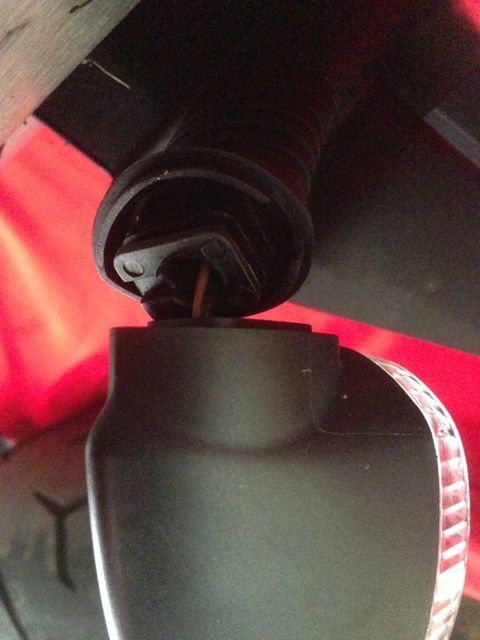

  4. Hi,
    Should this rear indicator just click back on? It doesn't seem to have anything to hold it in place.
    Thanks.
  5. dont think so. I think its a soft join which is why it moves a bit
  6. Thanks for reply. As you can see, mine currently moves more than 'a bit' :(
    Would it be glued that, do you think? There's no sign of glue, or any other way it's s'posed to be attached.
  7. Hmmm, i'd have to look at mine to double check. Thankfully they're in the garage with the original plate hanger and didnt get chucked at the scenery on Monday :)
  8. I checked and I cant imagine that these 'pop' in and out, so it looks like a replacement may be needed. Worth looking at a parts doc if you have time :)
  9. If you take the lense off one screw and then the reflector out you can relocate it the reflector has lugs that slide in the slots on the stem it's easy to put back on.
