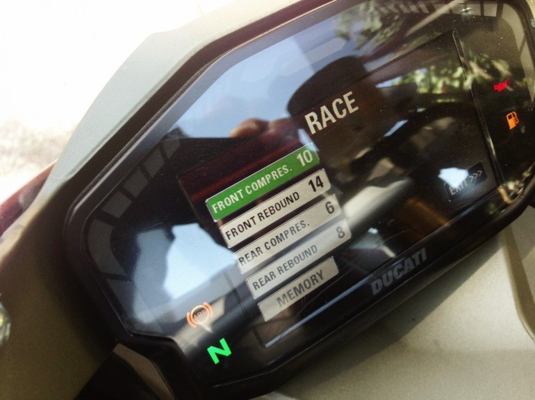

  1. Here's something that doesn't make sense to me. Check out the Troy Bayliss suspension settings. They say this is what Bayliss had on the R model, but the R doesn't have electronic suspension so why would this be on the screen, and if they've used them on the S then I'd imagine it would be different due to different suspension? Also I've read recently that Bayliss liked to set up the rear to be soft to prevent wheel spin and the front to be harder whereas these settings are the other way around. Anyone with jedi knowledge that can make sense of this? perhaps just because it's the Pani?
    RideApart Comparison: Ducati 1199 Panigale S v R | RideApart
  2. Lower number = lower settings
    I run Race all the time, I have lowered the rear shock setting a couple numbers working better however I need lower rate rear spring being only 70kg

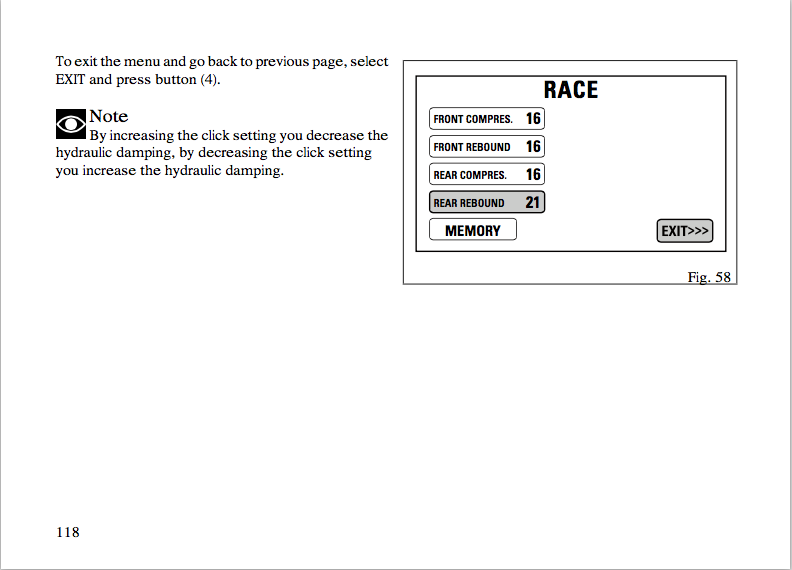

  3. Its the other way around, unless I'm mis-understanding something:
  4. Your right, I'm wrong
