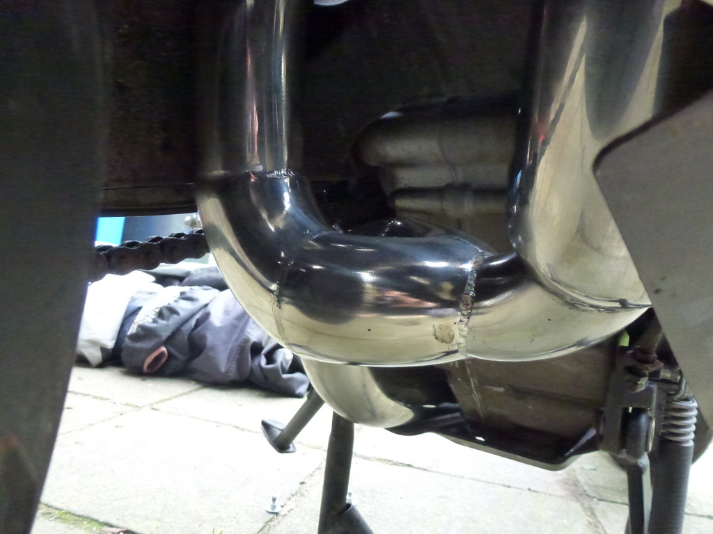

  5. Forgot to mention one slight drawback/criticism - there is no provision for the centre stand if you have one.
    It's not that the exhaust fouls the centrestand, it's just that when the centrestand is up there is nothing for it to 'stop' on - well there is , but this is the rubber chain guide on the underneath of the swing arm! And it is not easy to see how a DIY 'bodge' might fix this (any ideas gratefully received) - or I may just have to live without centrestand.

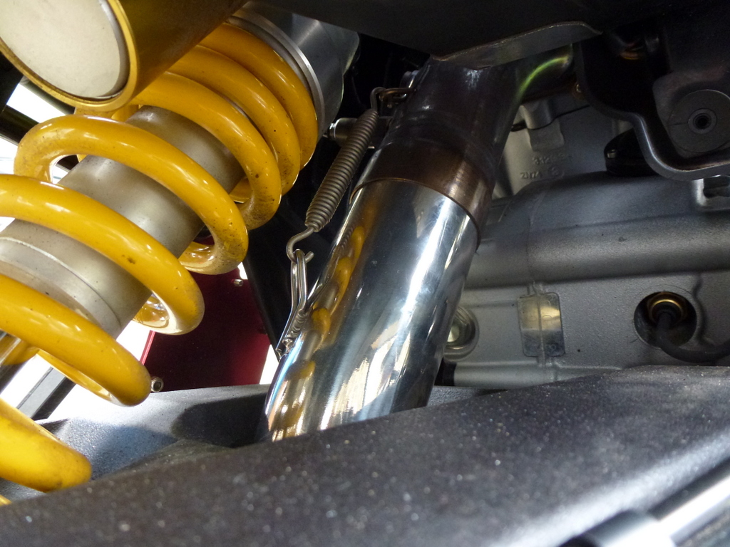

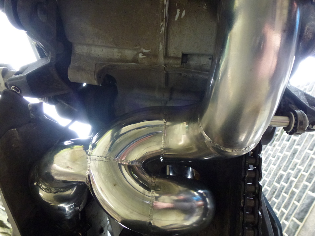

  13. A few in situ teaser pics for you... I will try and get some audio/video files up tomorrow...
    #93 Zed3, Apr 14, 2014
  14. Not much wrong with that at all. :upyeah: Looking forward to seeing the rest of the pics Zed3.
