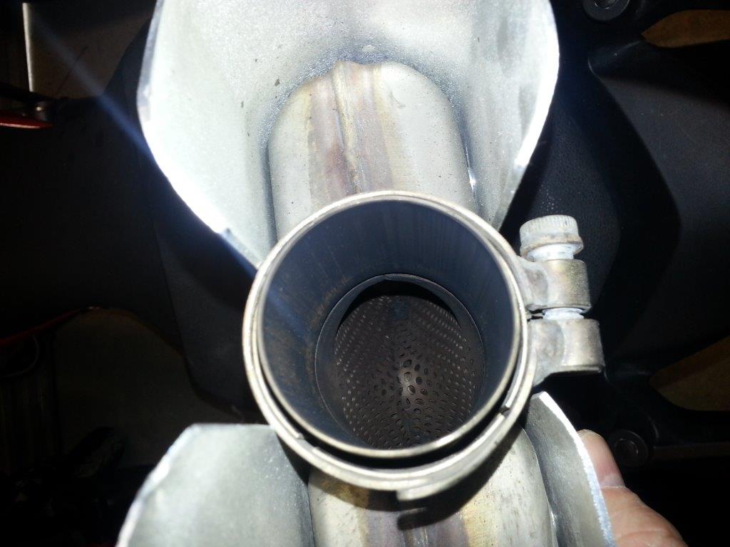

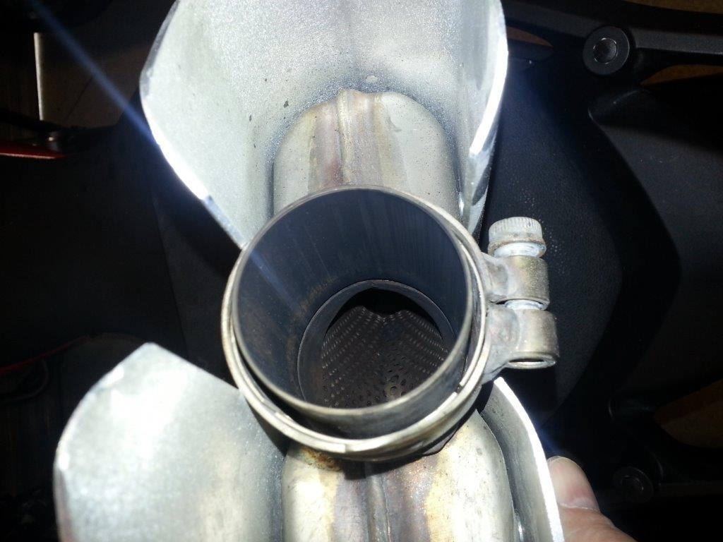

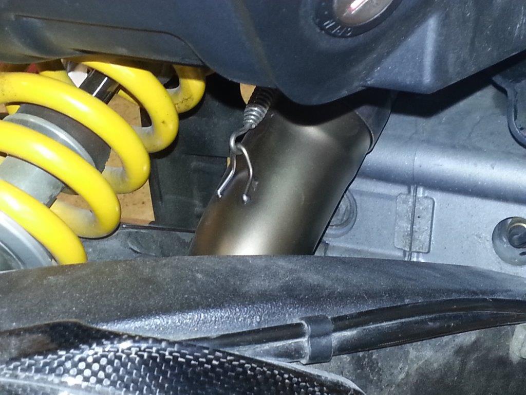

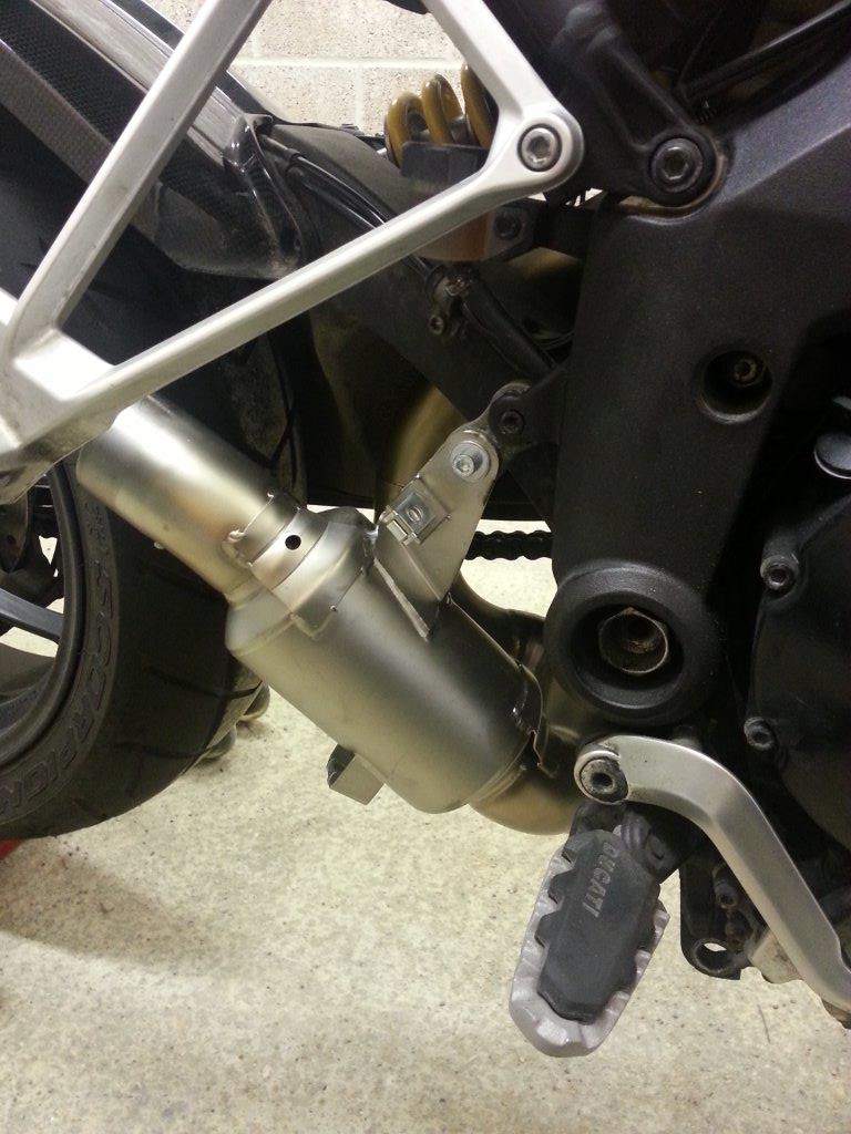

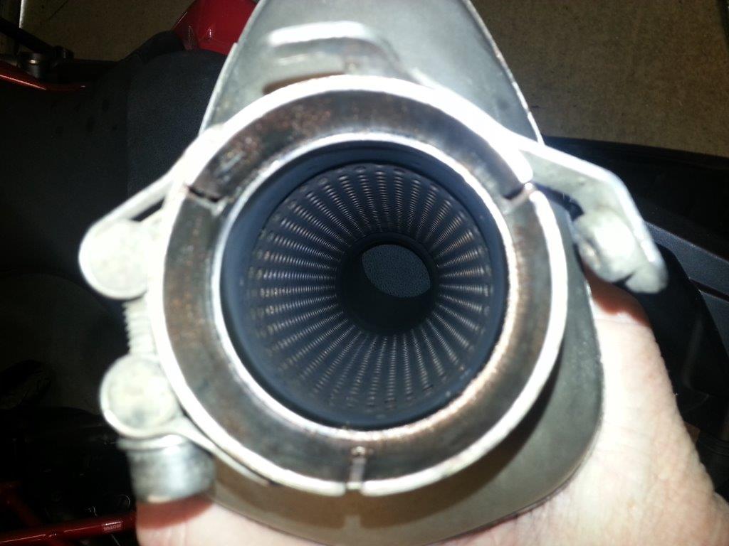

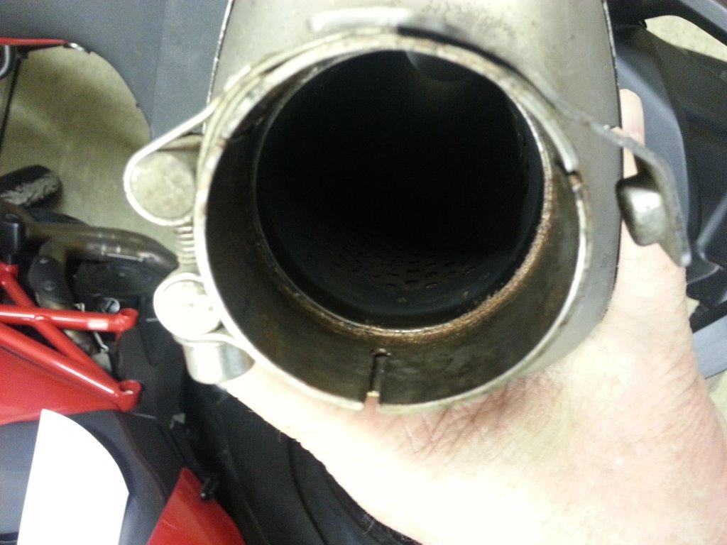

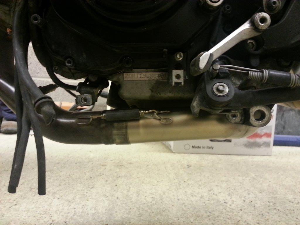

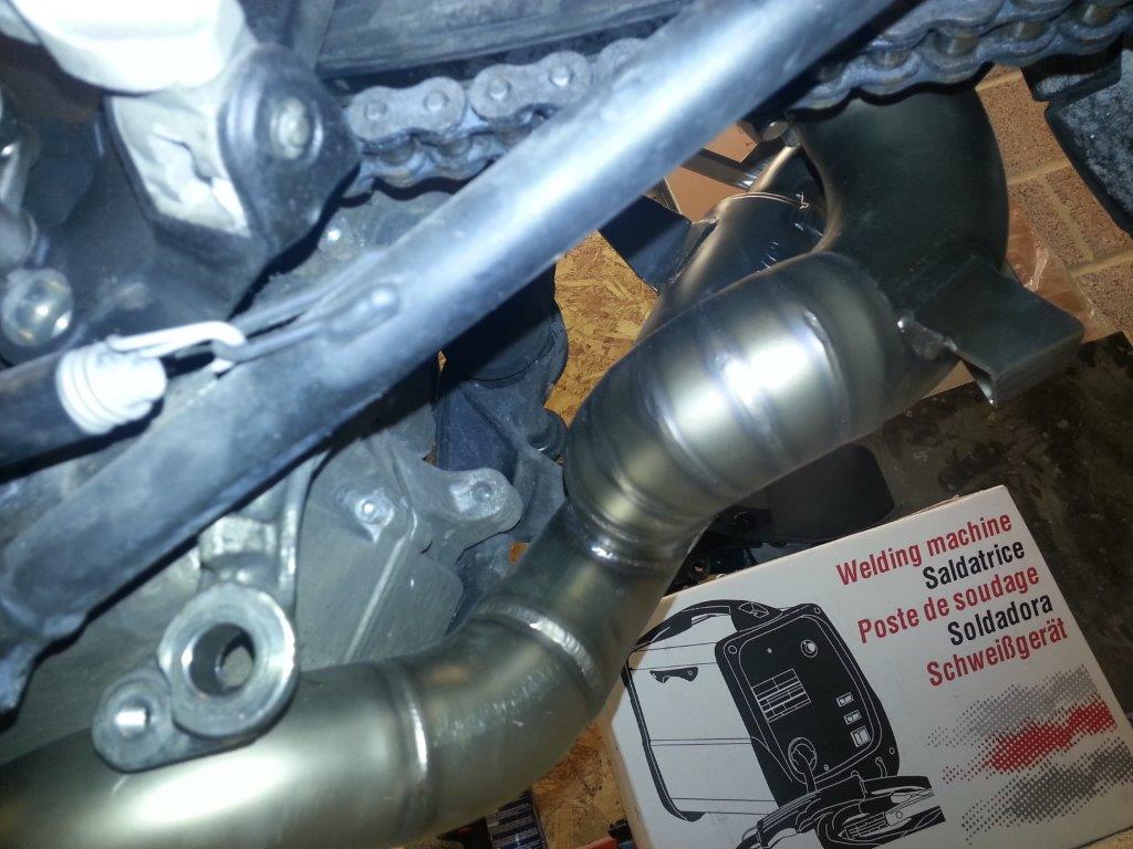

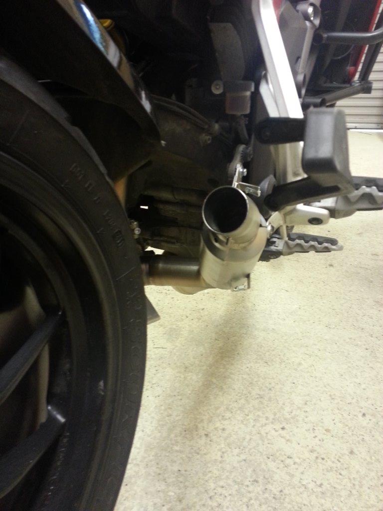

    Okay, so I have been able to take a closer look at the differences between the OE end can and the Akrapovic end can.
    As you can see from the pictures (Akrapovic 1st and last, OE 2nd and 3rd), the depth of the "pipe socket" on the OE is a lot deeper than the Akrapovic, 60mm vs 28mm which goes a long way to explain why you need to crop the decat pipe to fit the Akrapovic end can and that there is a lot more space to fit the decat pipe baffle on the OE end can. The sound of the Leo Vince decat pipe work with the OE end can is much deeper and more manly than the stock set up but the Leo Vince decat pipe work with the Akrapovic end can is more manly but refined. They are both loud although I have heard louder so I have decided to not crop the decat pipe work and run the OE end can with the decat pipe baffle for the MoT and events where loud cans would be ill advised and come up with a mod to the Akrapovic clamp so the end can is secured to the decat pipe work and the carbon heat shield fits 2 of the 3 securing points. If you have the Termignoni stubby end can I'd look at the "socket" depth which will be your limiting factor. Hope this helps. Andy
