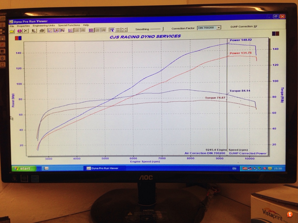

  13. [​IMG]
    Air filter + Quat D's with baffles in = 148 at the rear wheel. Chris (CJS) has seen north of 150.
    Hope the piccy uploaded ok!
    #153 rivets, May 17, 2014
  14. Nice. If I may, who did it for you and how much did it cost ? Andy
  15. It was done by CJS near Bristol. It's 3/4 of a day on the dyno, very thorough. Chris is a great bloke and I can't recommend him highly enough. Price was circa £400. Bike is transformed, throttle response is so accurate, especially when you're operating in the higher rev range, I was never too confident "at pace" but now just grin from ear to ear, does play havoc with consumption but who cares!
