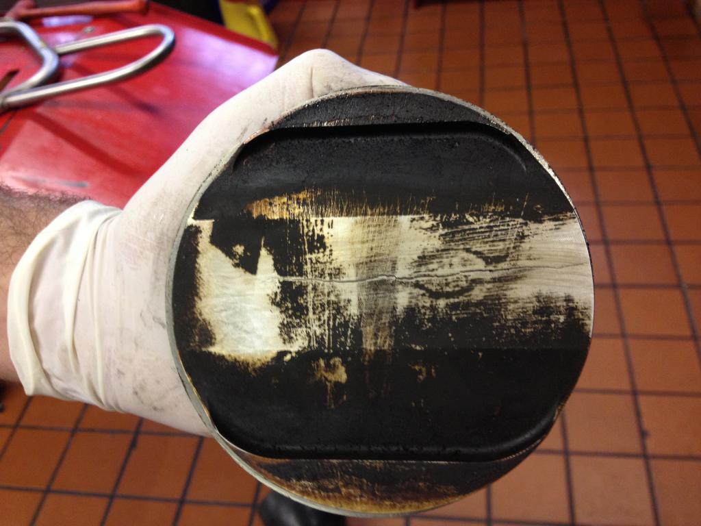

  4. Hmmm, this all sounds very familiar to what I've just had done. The vertical pot on my 1098R started passing oil. It turned out to be a cracked piston. As stated, don't run it just in case. I was lucky my whole engine didn't get lunched. I'll upload pics when I get to my laptop.
    Anyhow, the up shot was a new piston kit with barrell. I've asked around and looked on tinterpipe and it seems a very rare occurance. Ducati were keen to have the old cracked piston for analysis.

  17. This is said piston from my 1098R. The crack had actually propagated around the crown and through the bosses that houses the gudgeon pin. Piston broke 002.jpg

  18. Oh, and fixed under warranty by Italia Moto in Lincoln. Sound lads.
