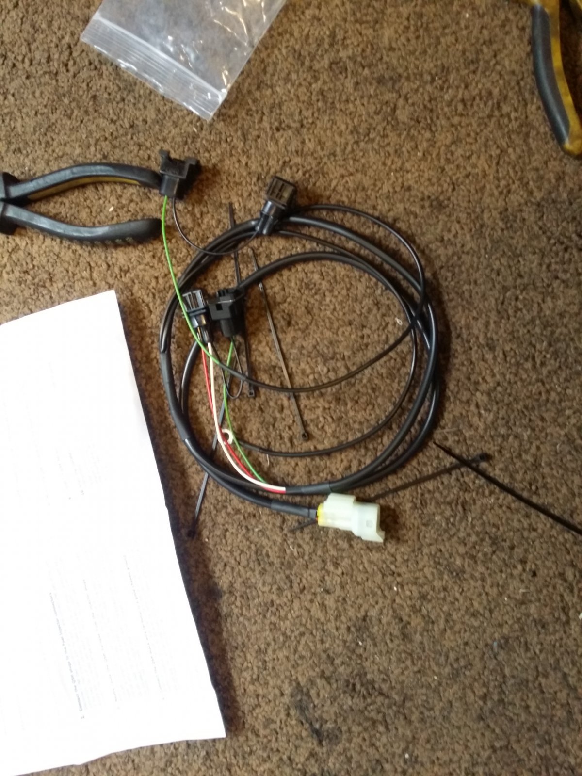

  1. Back now...well it doesn't work quite yet so ill have to wait to the weekend to do some testing and also call healtech tomorrow to get some help....everything is connected and working (apart from the actual cutting of the ignition)...so, working is the..
    a. connection to the unit from the phone. (so, Bluetooth connectivity)
    b. sensor is working - the phone is registering the gear lever being pushed and pulled.
    Going through the setup on the phone the only part that's failing is the cutting of the ignition. When I fitted the loom to the coils the instructions just said "fit the harness to the coils" two of the coil plugs had slightly different wiring to the other but the instructions didn mention the specific fitting of particular coil plugs to a specific cylinder....although I don't know why one cylinder would be different to the other but ill find out tomorrow...
  2. What's the plug with the red link wire for ?
  3. Just a blanker - a passthrough if you want to disconnect it without taking it all out...
  4. Ahhhhh OK
    You figured it out yet ? Connections and earthing connector all good ? (Not to sounds patronising)
  5. Not yet - contacted healtech - had the initial email back about make model, etc etc....ive got it grounded on the frame up at the top by the ecu....I might try another ground point when I get home just for the sake of it....the only thing I think is a bit hazy is the harness plugging into the loom....they didn't seem very (the instructions) specific and two of the plugs have a red square on each one...
  6. You'd assume the red square ones go to the same coil connections
  7. yeah - which is what ive done but they don't say which ones the red squared ones should go on...ie the upper or the lower (not that it would make a difference I know) I thought one would have gone on one and one on the other but the wiring it too tight for that to work....ill see what they say...as you can see...
  8. Yeah seems strange that one plug has 3 wires and the rest just one...
    Maybe it's something to do with the firing order and the 3 wire plug needs to be on the first firing cylinder which I assume is Horizontal as that is named cylinder 1 by Ducati
  9. Well, ive been in contact with the Healtech support over the weekend....(I can only guess this lad is watching a mailbox as he's been replying within the hour at all hours but that's been good). They reckon ive got the harness wiring right and that it doesn't matter which way round the two pairs go, this is confirmed by me leaving the bike running and then pulling the harness wire to the module and the bike's engine cuts. So, to that end they think the module is faulty. Now the only thing that I think is a bit weird (and this could be down to the harness) is that the ground wire that I have to connect to the frame/battery/engine....wherever I ground it the bike becomes harder to start....ie a few turnover's to get it going whereas - right now the loopback plug is in and the ground from the harness is disconnected it starts within half a turn, ie instantly....
    @mechanico lee - your the electrical master - does that mean that my harness wiring needs to be checked or something else??

  17. Right..... After all the arsing around with it I got it working! Turns out i think it actually worked in the first place! No matter what I did run in through the setup step 3 was the engine cut.... No matter how I wired it it failed. So this afternoon I thought (after stripping it again) I'd bypass that and see what happened.... Fucker works... Awesome...
