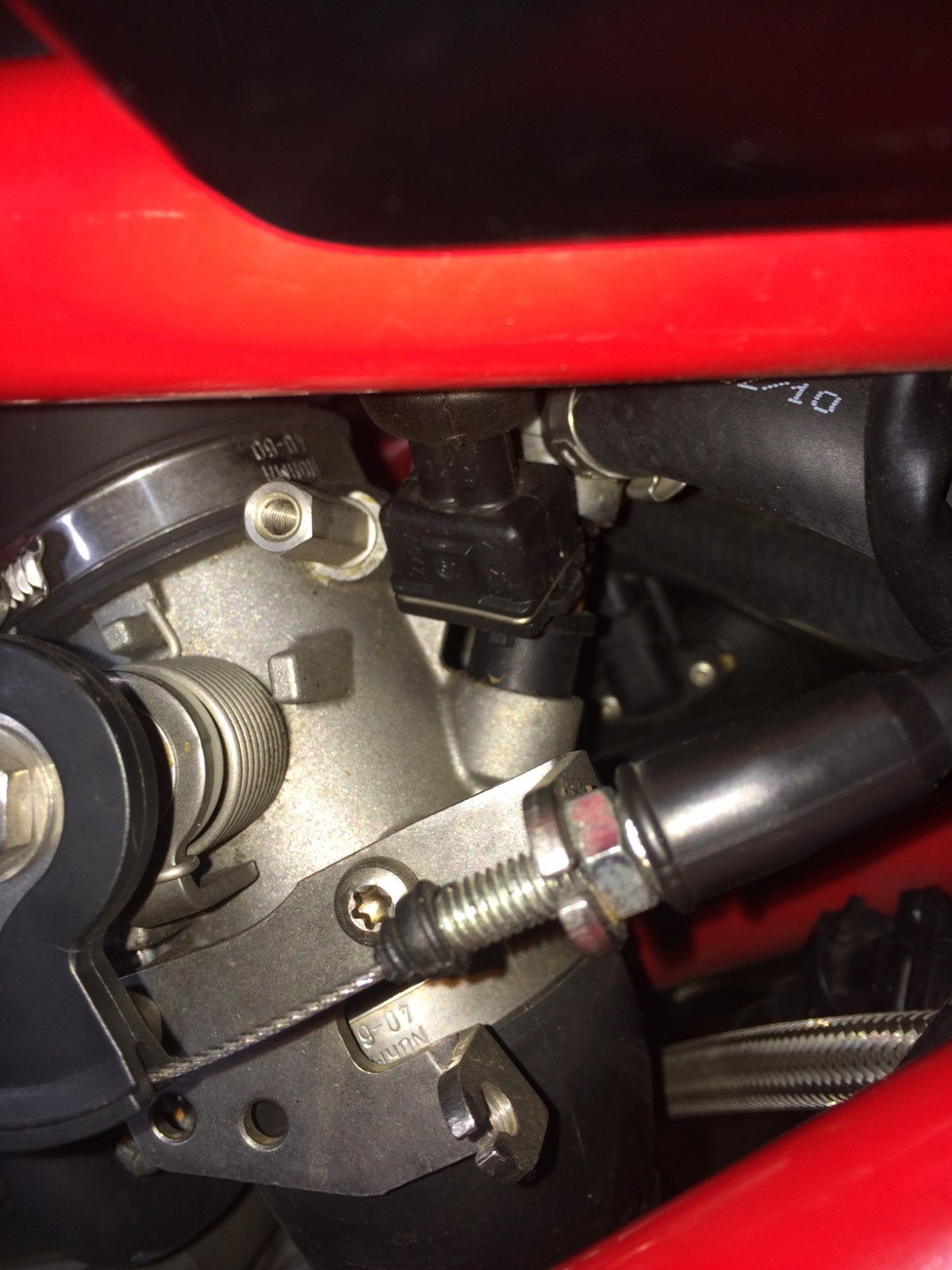

  9. Which connectors does the wiring harness actually connect to? I initially disconected one of the coils connectors to check for fitment, however it was a different shape of plug. The only other connector that looked like it might fit is attached to the injector (shown in the picture below) but I have no idea how to dissconect it, is this the correct one?
    Would you be able to upload a picture if possible please? :)
  10. Yep... That's the one.... Get a small screwdriver and get it behind that metal clip..... Once you get that out of the way the plug will come away...
  11. Alright thanks mate, I'll give it a go later. :upyeah:
