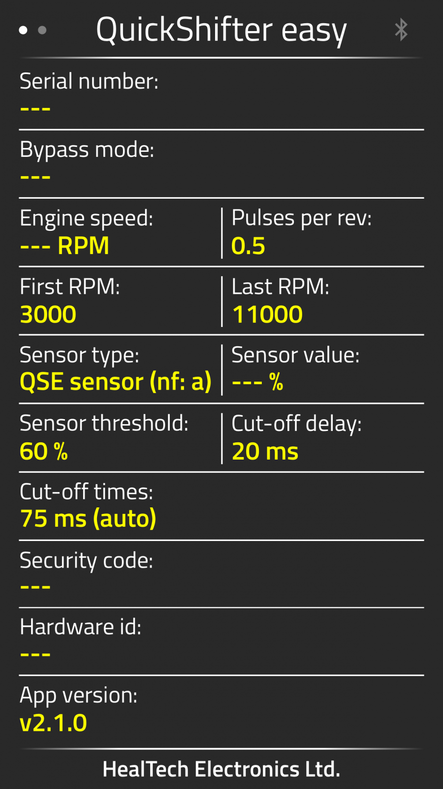

  11. After a weekend at Pannonia race track I provide you my optimal setup for the Healtech quickshifter on Multi DVT:
    RPM
    Imp. 0.5
    3000 - 10500 rpm
    Sensor
    80%
    20 ms
    Noise filtering active (needed at high revs and speed)
    Cut-off
    Auto
    75 ms (Is not fully smooth when shifting to 2nd. But 80 and 85 resulted in front's dive in higher gears)
    Regards
    Nicolaus
