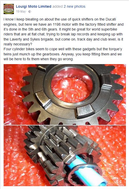

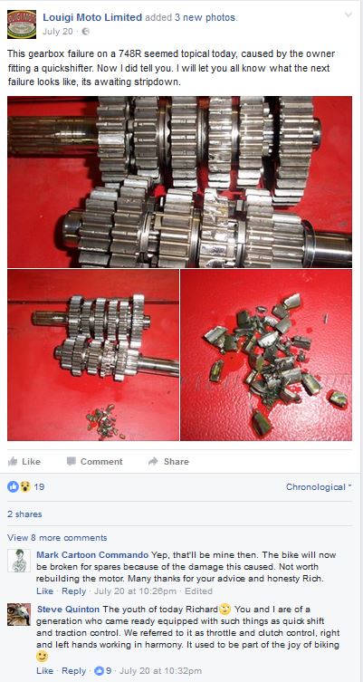

    I was recently at Louigi Moto, and Rich showed me three bikes in for new gearboxes, because of quick shifters!!
    Rich reckons the Ducs are just too grunty for a QS and put a lot a stress through the box.
    Here is some evidence of this in a couple of posts on the Louigi Moto Facebook page.....
    Just sayin', of course what anyone does with their own bike is up to them.
    I was going to fit one on the 999 and the Multi, but the thought of trashing the boxes on them put me right off.
    And as much as I might like to think I need one, I certainly aint no Casey Stoner/ Dovi / Chaz Davies, so I'm sure I'll cope without one!
    Deaks :)
