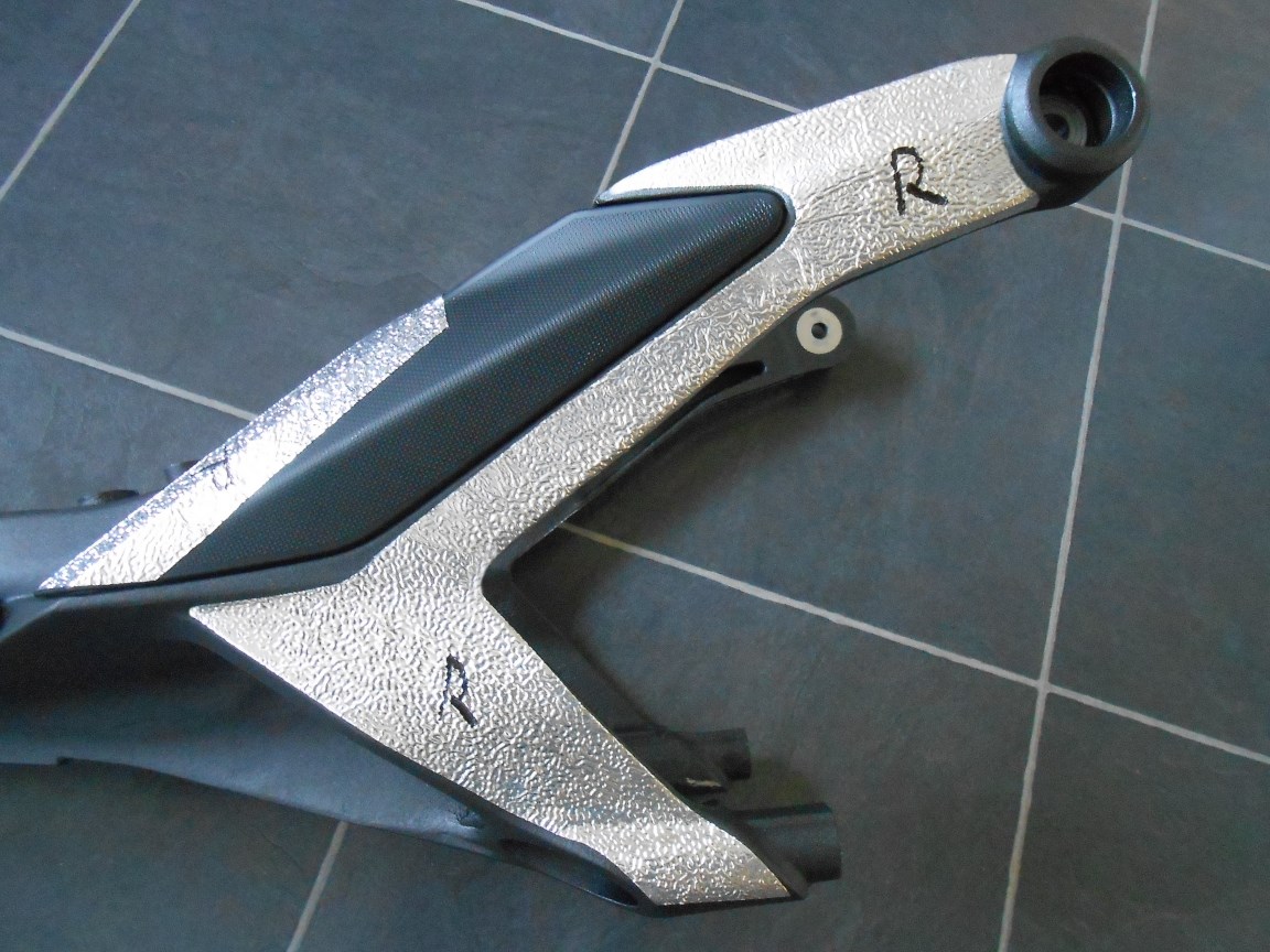

  13. If you mean the subframe inserts, remove the seat and you will some steel spring clips that fit over the plastic lugs of each insert as they pass through the subframe. Easily removed with some long nose pliers, though not sure that will help any as you are simply exposing more metal to your legs. If you meant the cylinder head covers, you'll have to remove the two lower subframe mounting bolts and loosen the two upper ones, remove the fuel tank and seat pad, then raise the frame up sufficiently to allow you access to each side so as to be able to take them off. Again not sure this will help. Far better would be to use some subframe covers lined with a heat shield foil which will insulate you from the worst of the heat that is conducted to the subframe from the rear cylinder head.
  14. Cheers Tops, I only wish to remove them to apply heat tape on inside. Then re-affix. :)
  15. Oh OK, that makes more sense now! The subframe covers I mentioned fit over these plastic inserts. There are a few on the market but the ONLY ones worth buying are produced by Lieb Speed in Germany as the fit and finish is sublime, He also sells the additional heat reflective precision cut backing kit. You can comfortably touch any part of the subframe where your leg might normally contact it and you won't get burnt.
    Here's a picture of them fitted to my subframe and the backing kit (RTV sealant is supplied in the kit as well). The tie wraps and bubble wrap were to hold the covers on while the sealant cured (24 hours)
