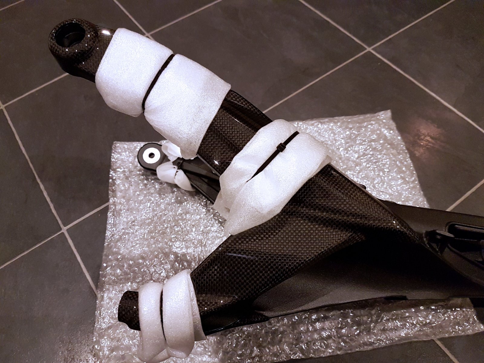

  2. Bought a set of Lieb Speed subframe covers and the heat pads.
    Its 100% the subframe that gives the issue in my case. I note it most whenever I grip with my knees for a prolonged period.
    The Lieb speed covers are very well made and I shall buy more carbon from them.

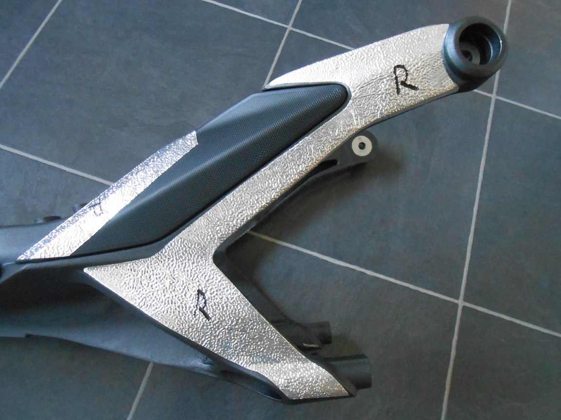

  7. Bootsam, take your time to position the foil kit accurately as it's very sticky and if you try to re-position it, it will tear once stuck to the metal. Make sure the subframe is completely cool when you apply the RTV sealant OVER the heat foil kit. You will need to allow a minimum of 24 hours for it to cure completely, hence why I used tie wraps and bubble wrap to secure the carbon covers in place. Not sure applying heat wrap to the inside of the plastic inserts will help as it's the heat being radiated out from the subframe you are trying to mitigate, so no real need to remove them. Just apply Peter's foil kit, RTV sealant and covers and you are good to go!!

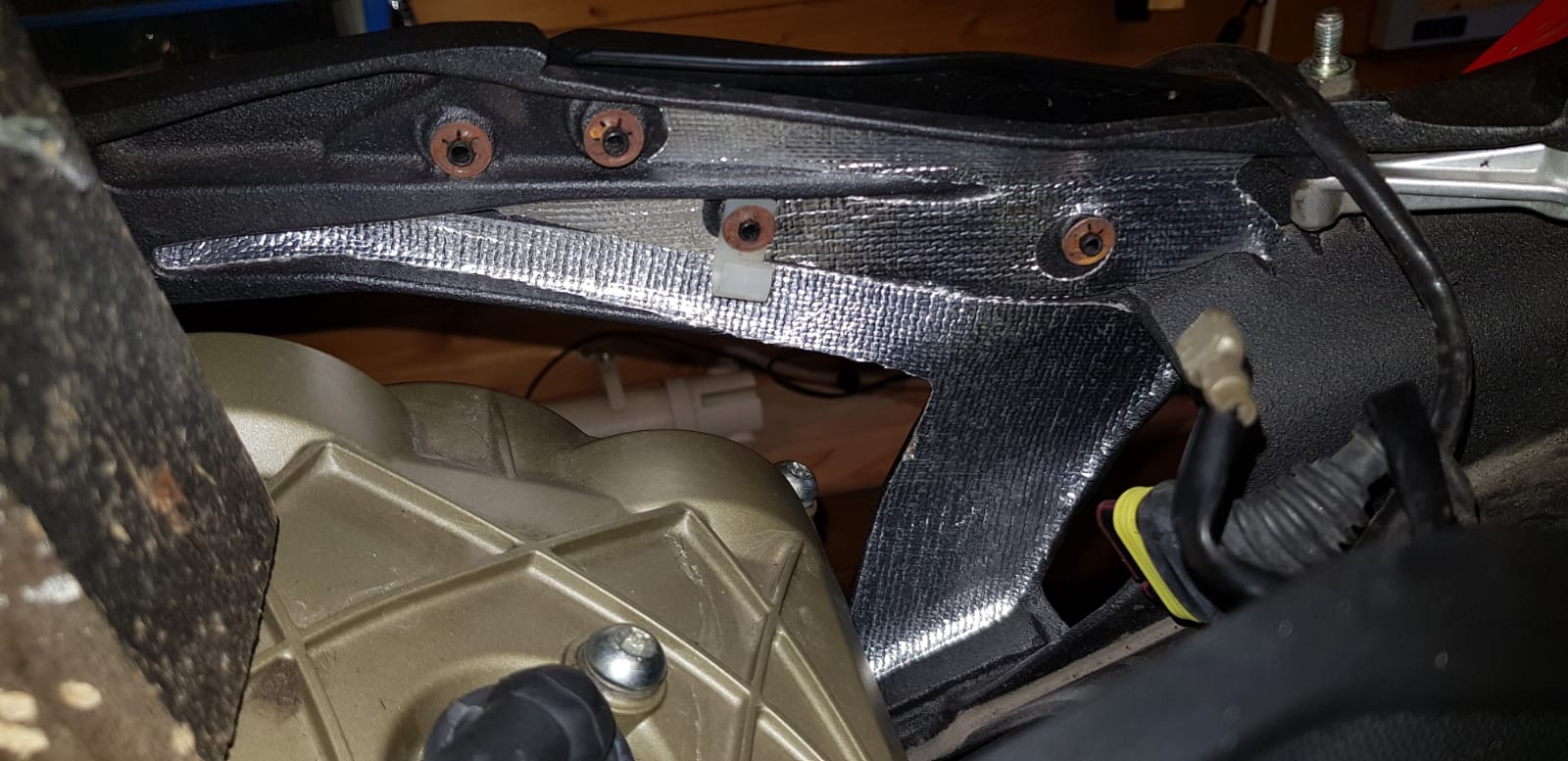

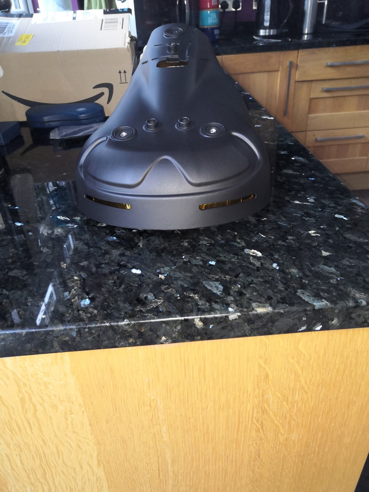

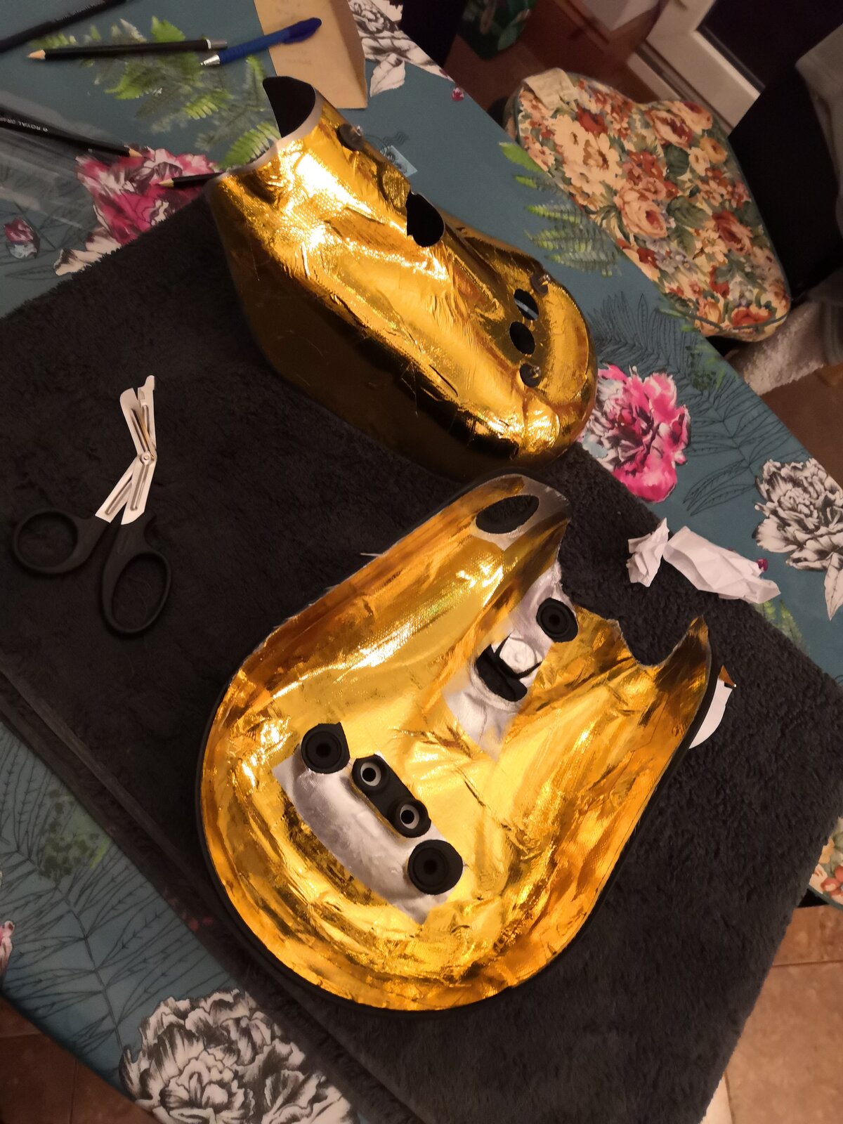

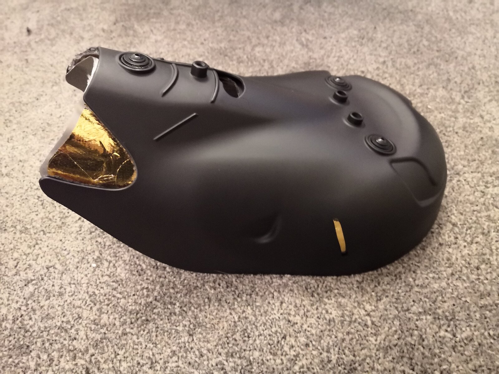

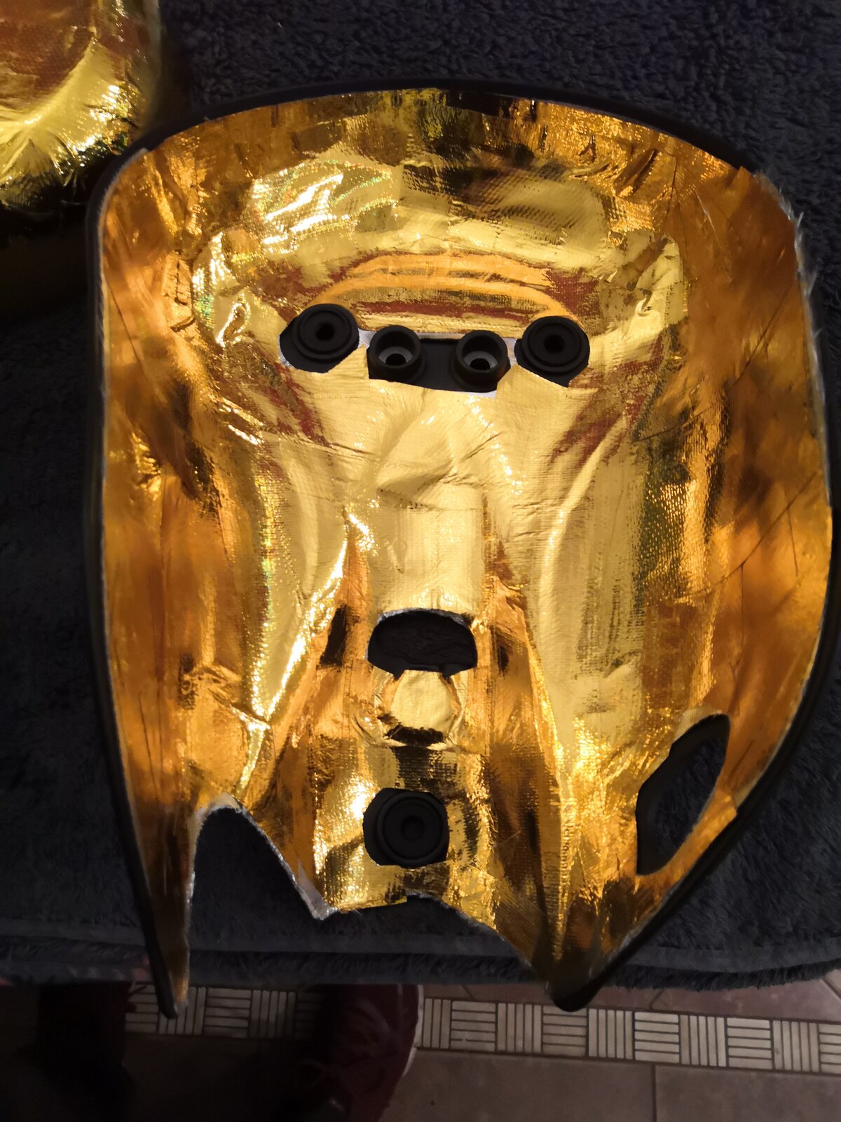

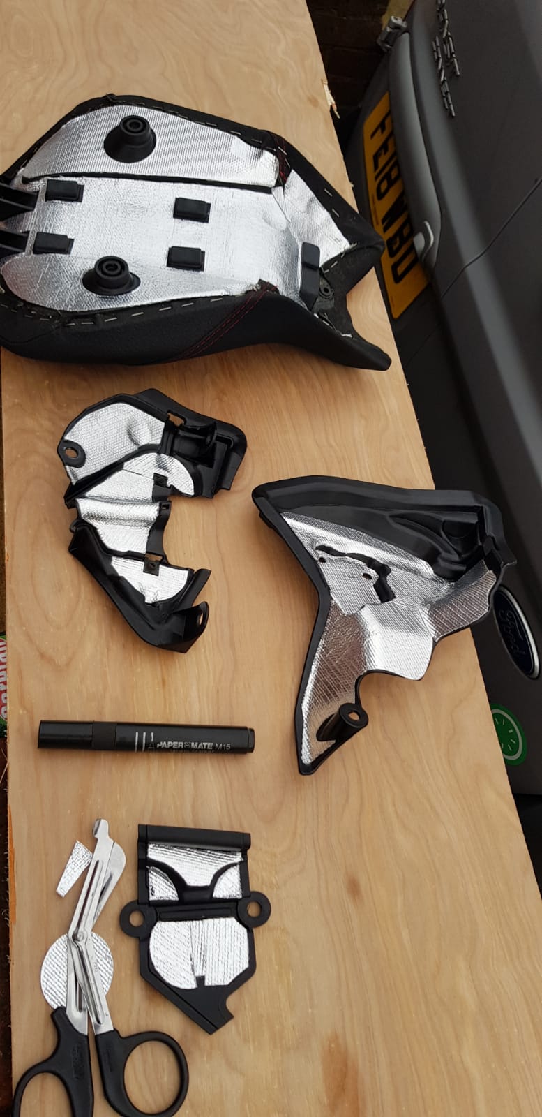

  14. Sorry to breathe life into an old thread! I've recently fitted the Ducati Spacers insulation kit, to my 1299. Sticks to the inside of engine covers, subframe and seat. Whilst she was apart, I removed the exhaust cover, and double layered the metal part with heat reflecting tape, in a gold matching the Ohlins shock. I cut some grooves in the plastic part of the cover purely coz I think the 1199 covers look so much better! IMG-20210118-WA0005.jpg IMG-20210118-WA0006.jpg IMG_20210124_173611.jpg

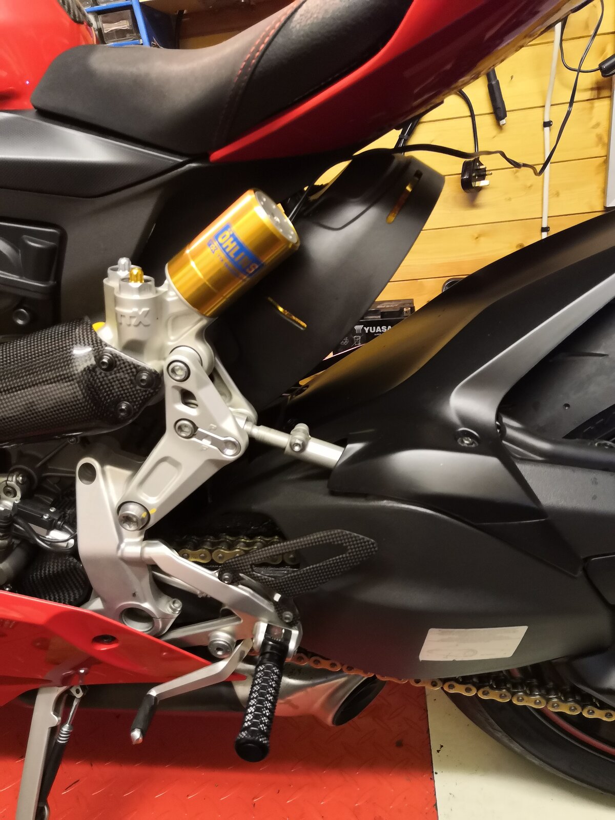

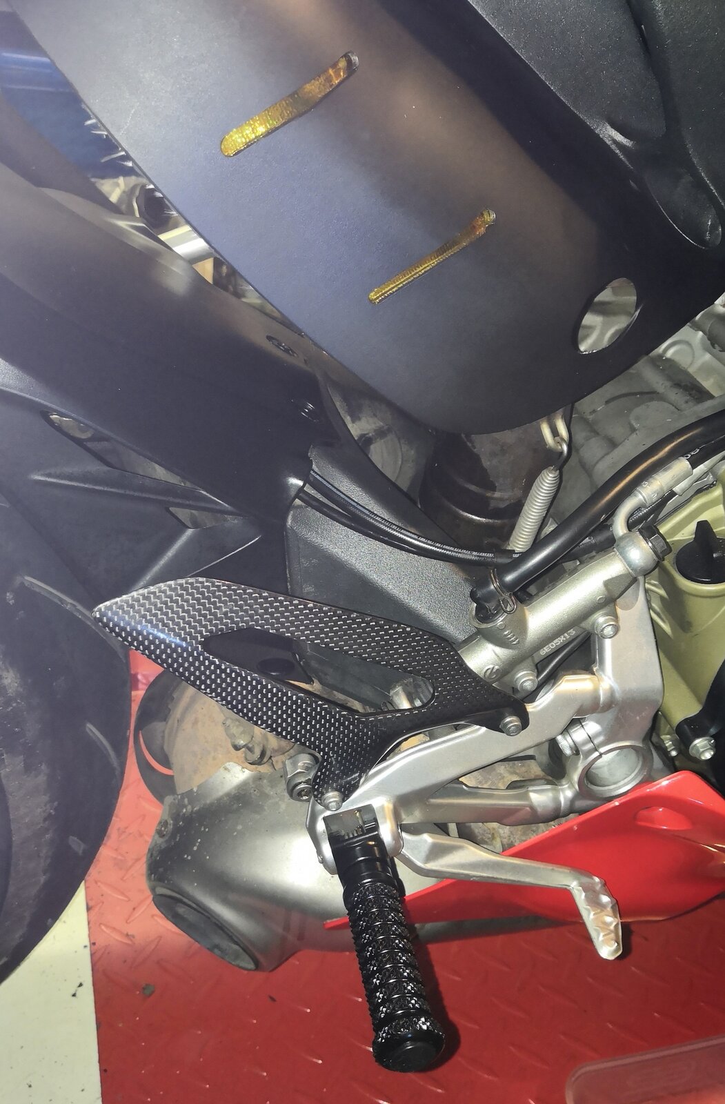

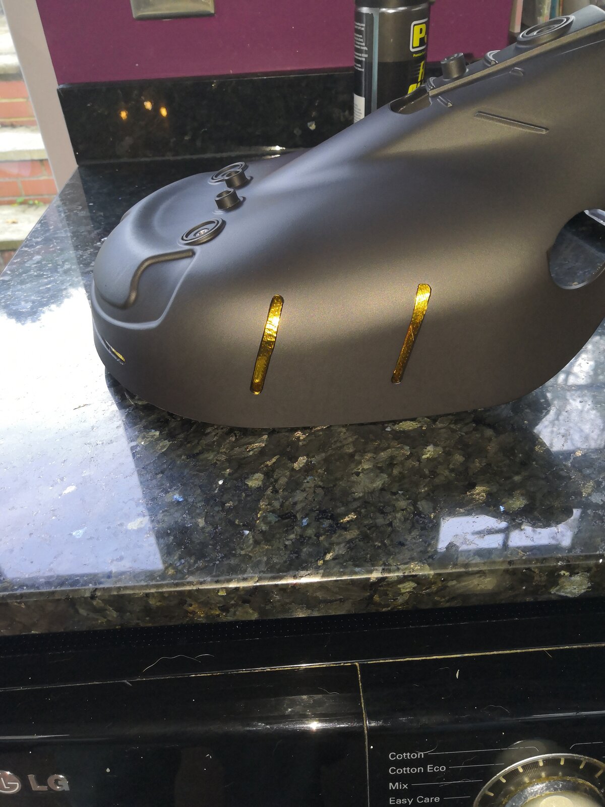

  15. A few shots of the exhaust cover. IMG_20201113_144404.jpg IMG_20201114_181823.jpg It's snowing here in the UK at the mo', so have not tested it yet, or the new footrests.
