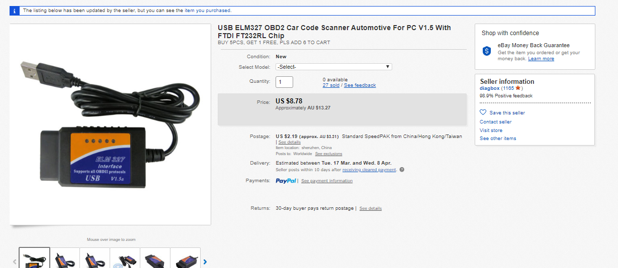

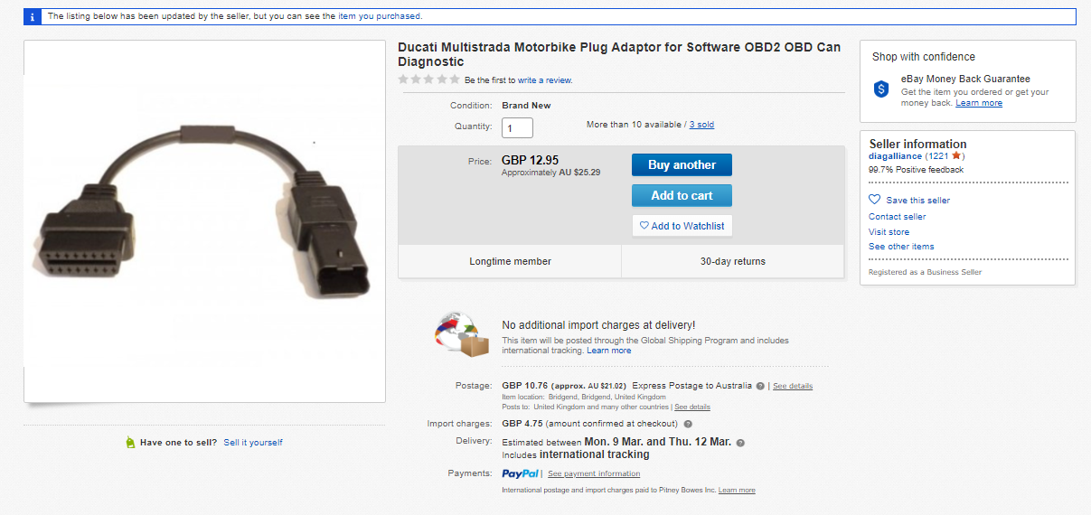

  5. Yes. Please download the freeware Melcodiag (Google it). Buy two cables and you have the ability to read the fault codes.
    I just fixed my lh grip an hour ago. Engine warning came on (lh top of display) when you switched the heated grips on. Goes away when you switch off. Error shown was heated grips connection to earth or open.

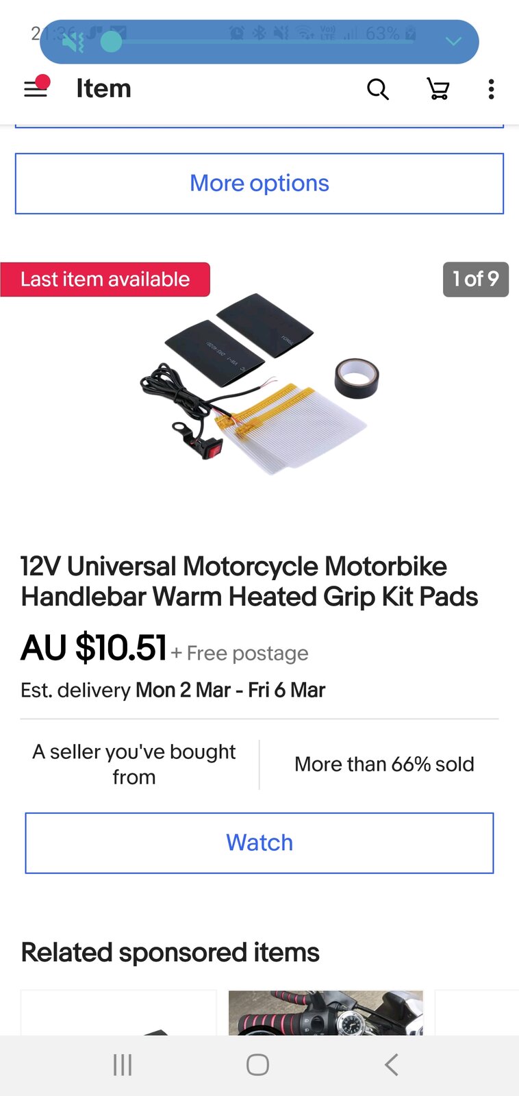

    It's quite easy to replace the heated element underneath the grips if you know how to solder. EBay has a 12v heated grip kit that's perfect.

  10. George what duc model was this repair on, please? Can't find a lead for the duc Multistrada 1200 dvt. Thanks for any advice.
  11. 2015 1200S DVT
    Ebay links to the two cables
    https://www.ebay.com.au/itm/Ducati-...e=STRK:MEBIDX:IT&_trksid=p2057872.m2749.l2649
    https://www.ebay.com.au/itm/USB-ELM...var=553331044502&_trksid=p2057872.m2749.l2649
    Look at the FAQ sesciton on the jpdiag forum - there is a sticky on there on a beginners guide how to use. Will explain also the process of getting the licence key (free)

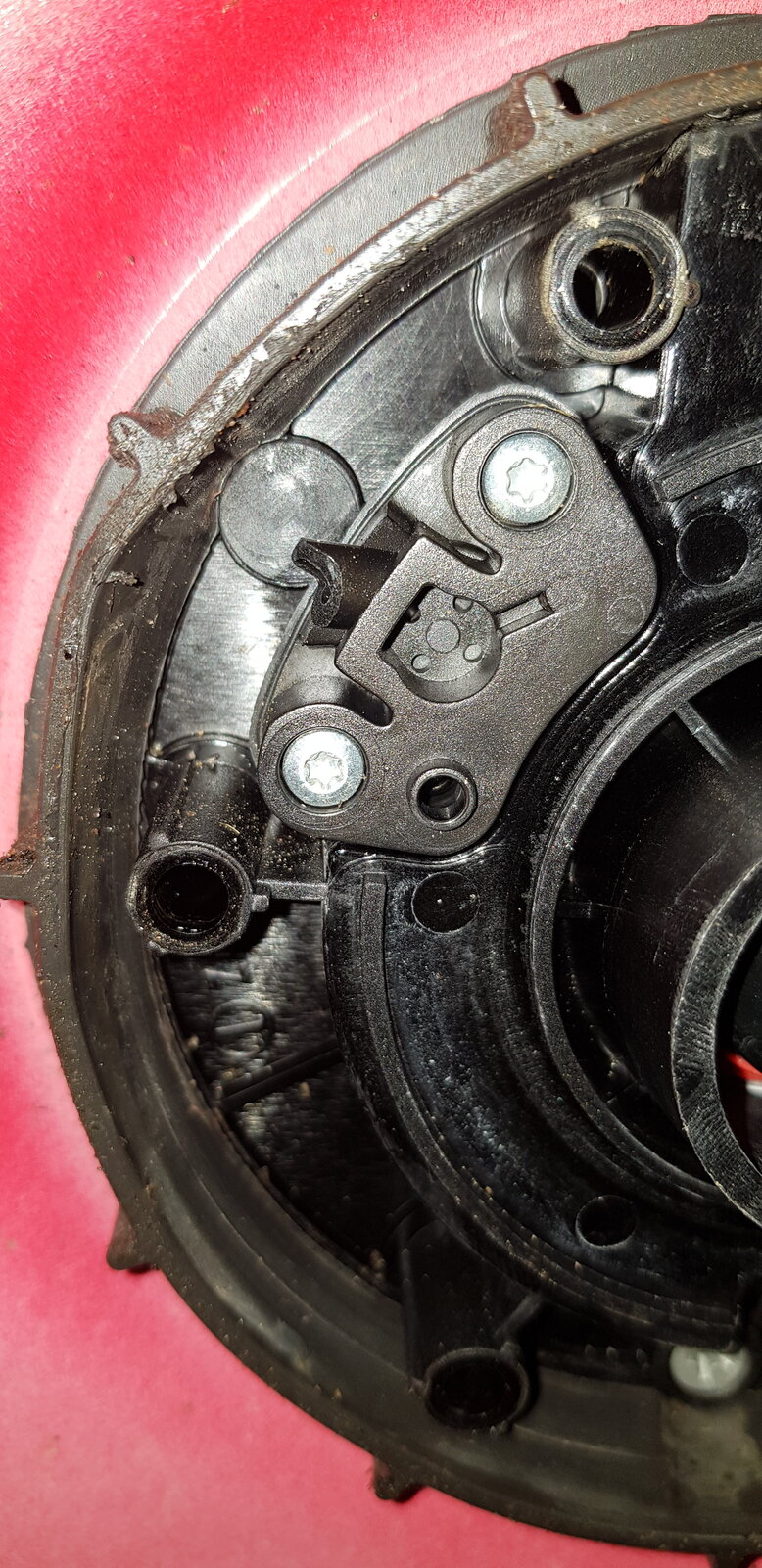

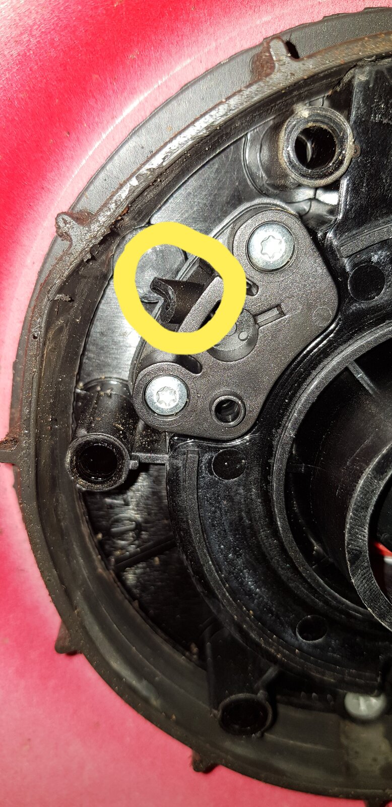

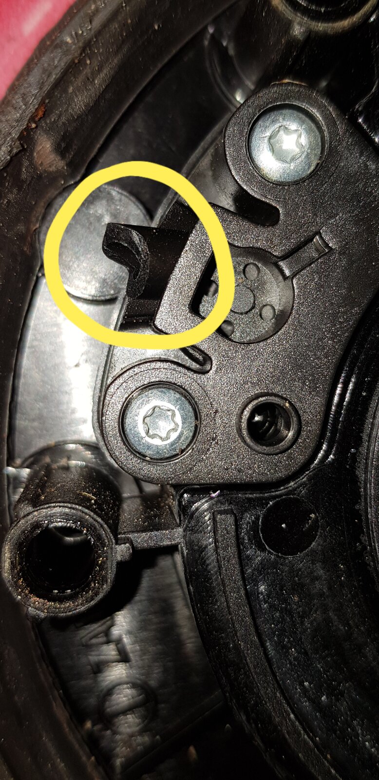

  14. So tank cover/cowl removed last night to get to heated grip wiring. Couldn't find where right hand filler cap breather was (one of two breathers on the filler cap underside). Then once cowl eas removed found the RHS breather taped to the tank! I've not removed it before only the Ducati dealer. Disappointed they didn't tell me. Do I have case to go to them about this?
    #34 Bandit, Mar 16, 2020

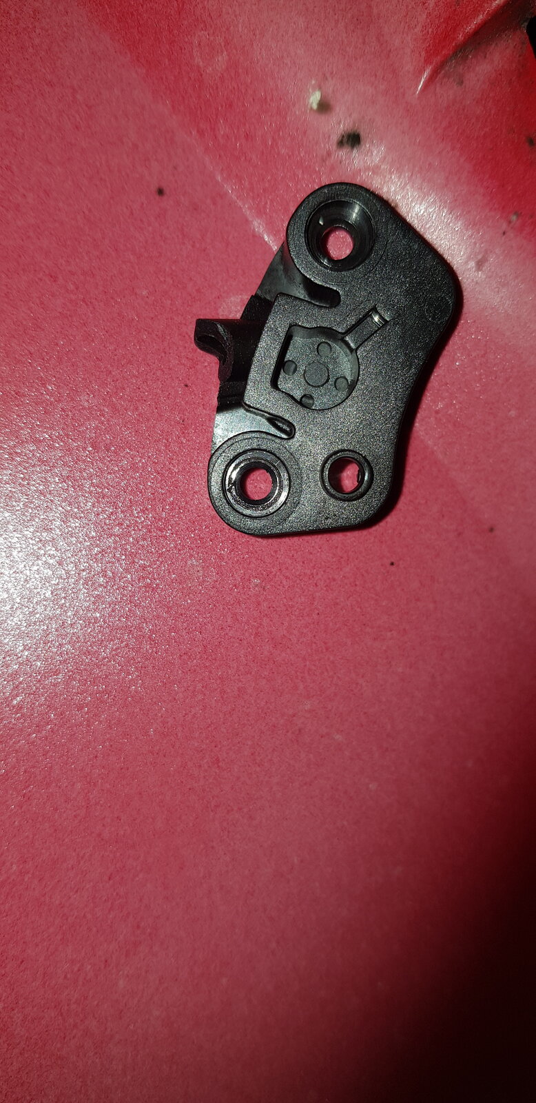

  15. Another photo

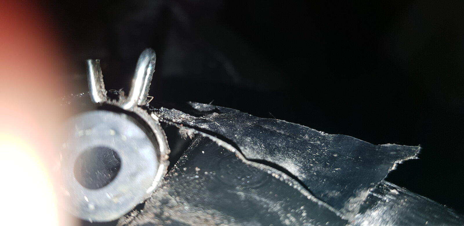

  16. And another (looks like the RHS filler cap breather is a separate component ?)
  17. It's annoying but personally I'd just put it right and wouldn't worry about it, could have been previous owner unless you've had it from new?
  18. had it from new wi cost £££ to put right. Cant see individual parts on the filler cap...comes as one whole unit....

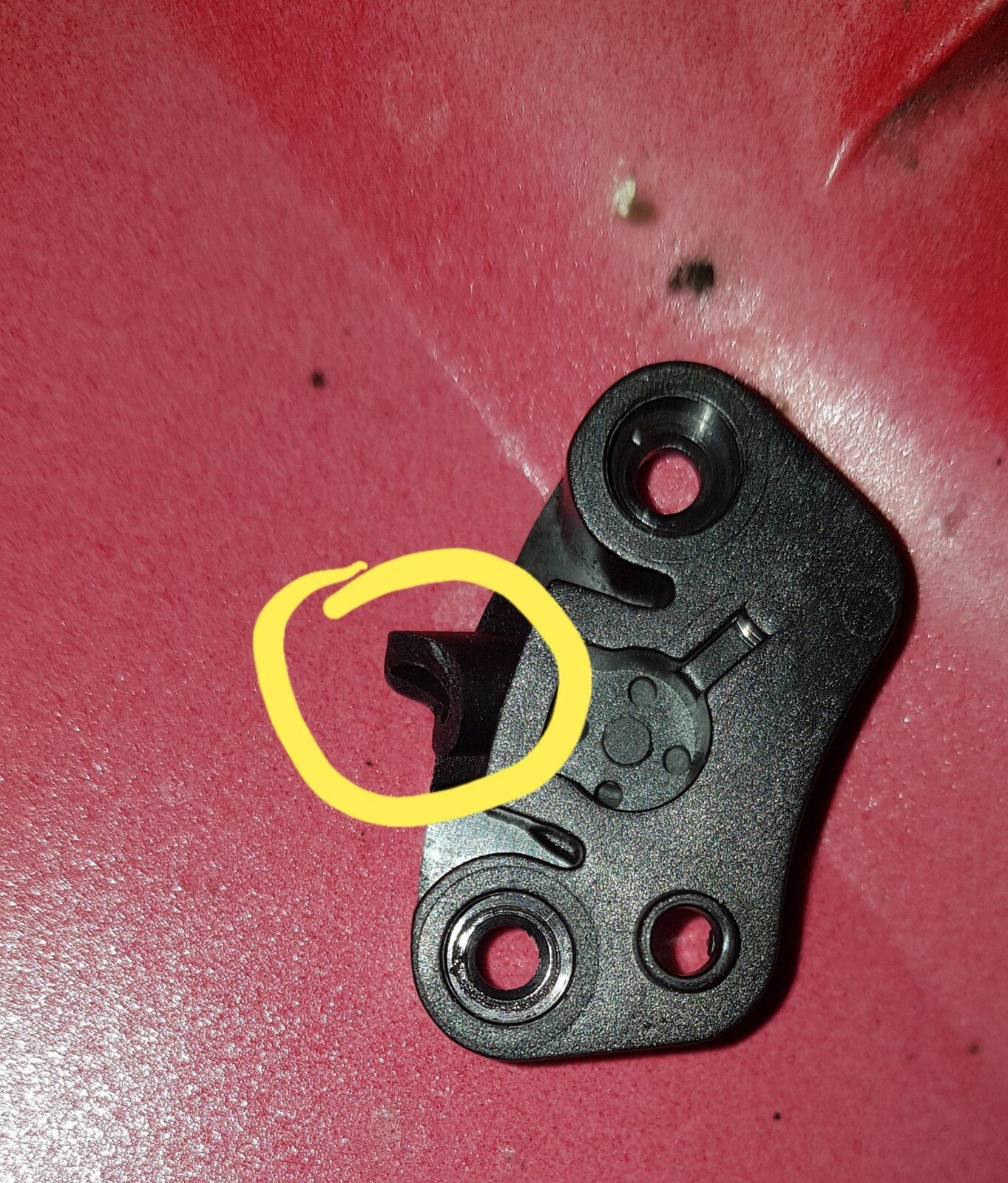

  19. Oh is it snapped off? Couldn't tell from the pictures.
  20. Edward yes its snapped off please see photos. This part can be unscrewed, but can't find it anywhere as a seperate component.
