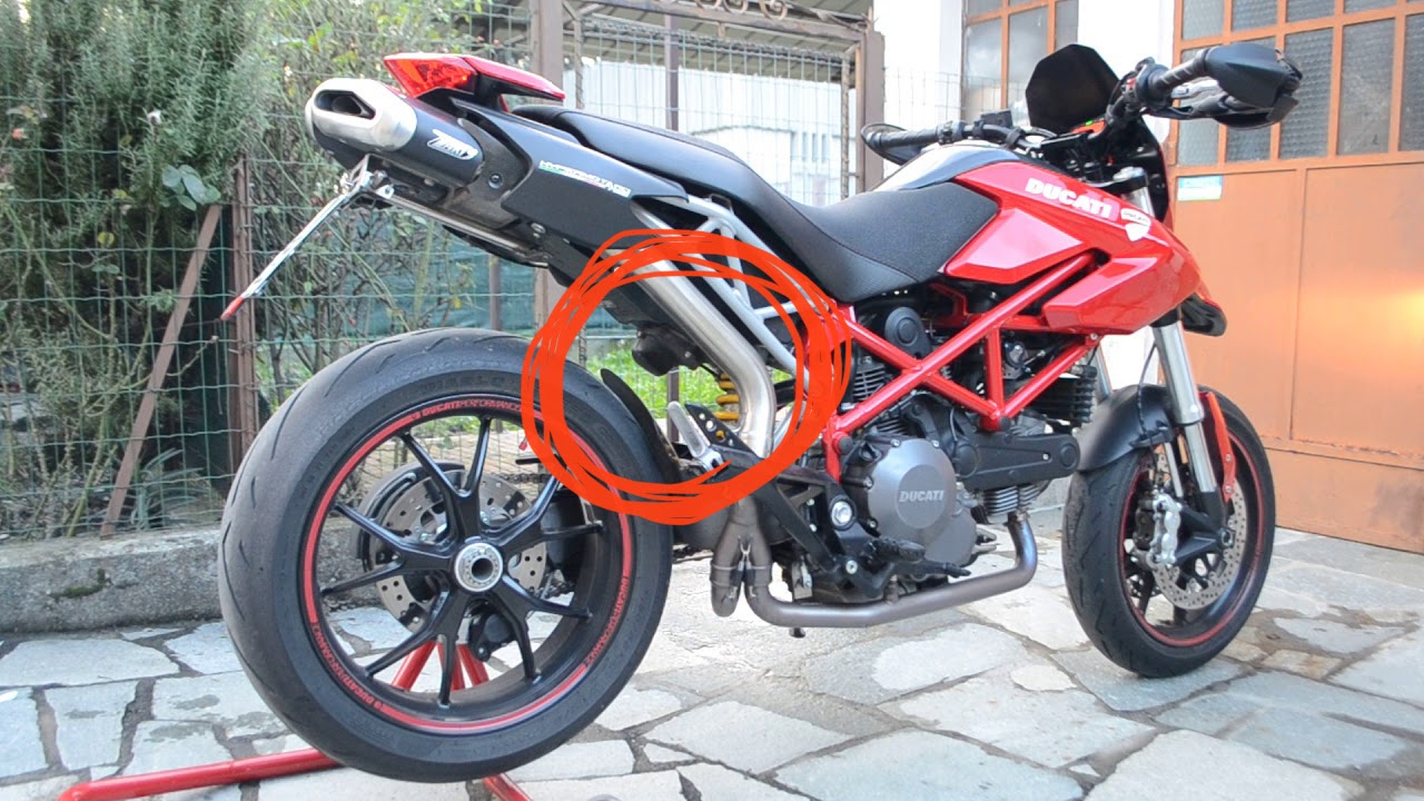

  9. What is this part? What does it do? And why mine seems to be gunky like it’s leaking oil and mixed with dirt?
    what’s a fix?
  10. Do you mean the fuel pump cover? Your circle is rather large, well from memory that's the fuel pump cover if you're referring to the Black item.
  11. Yes that black bulk. It does seem to have a cover on it. How is it sealed up? A gasket of some sort? It seems very accessible, but looks can be deceiving.
    Any tips are appreciated.

    It’s tradition on this forum Sam that when you post a picture of your bike you need to make sure there’s a rubbish bin included in shot, called wheelie bins over here as they have wheels, yours are trash bins yes? These shots are very important unless you wish to annoy @Ducbird our beautiful Monitor, beware though for she has a dark side too...

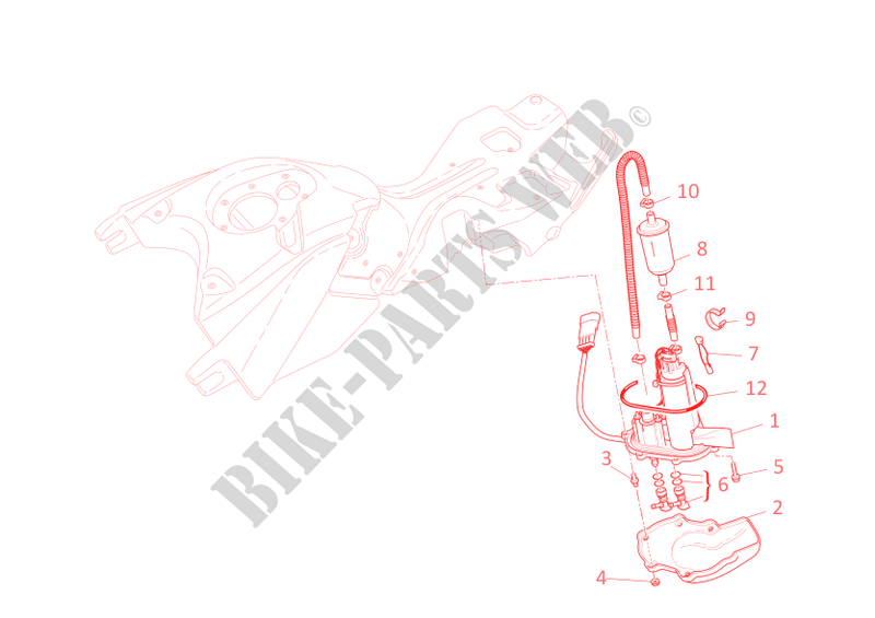

  16. Would the gasket/ring item #12, be the only suspect here? Anyone know the torque specs for the fuel guard bolts? I’m hoping they’re lose and need a squeeze instead of opening the whole thing and dealing with whatever unknown to come.

  19. The black bit is bolted over the fuel pump assembly, there’s no gasket between that and the bottom of the tank. It’s there to keep the shite from the road and/or heat of the exhaust away from the fuel pipes that it covers. It’s held in place by the 4 nuts #4 in your diagram.
    suspect for what? #12 is the fuel pump sealing o-ring which seals the fuel pump assembly against the base of the tank and stops fuel leaking out. Whilst easy enough to get out it can be a bit tricky to reseat and there’s a knack to it using over size bolts.
    The nuts to the fuel pump assembly guard, part #2 in the diagram, should come undone easy enough but have probably been loctited. When redoing them up I don’t use a torque wrench just do them until they’re tight ie resistance us felt then a 1/4 turn more. The loctite holds them in place and they’re not structural.
