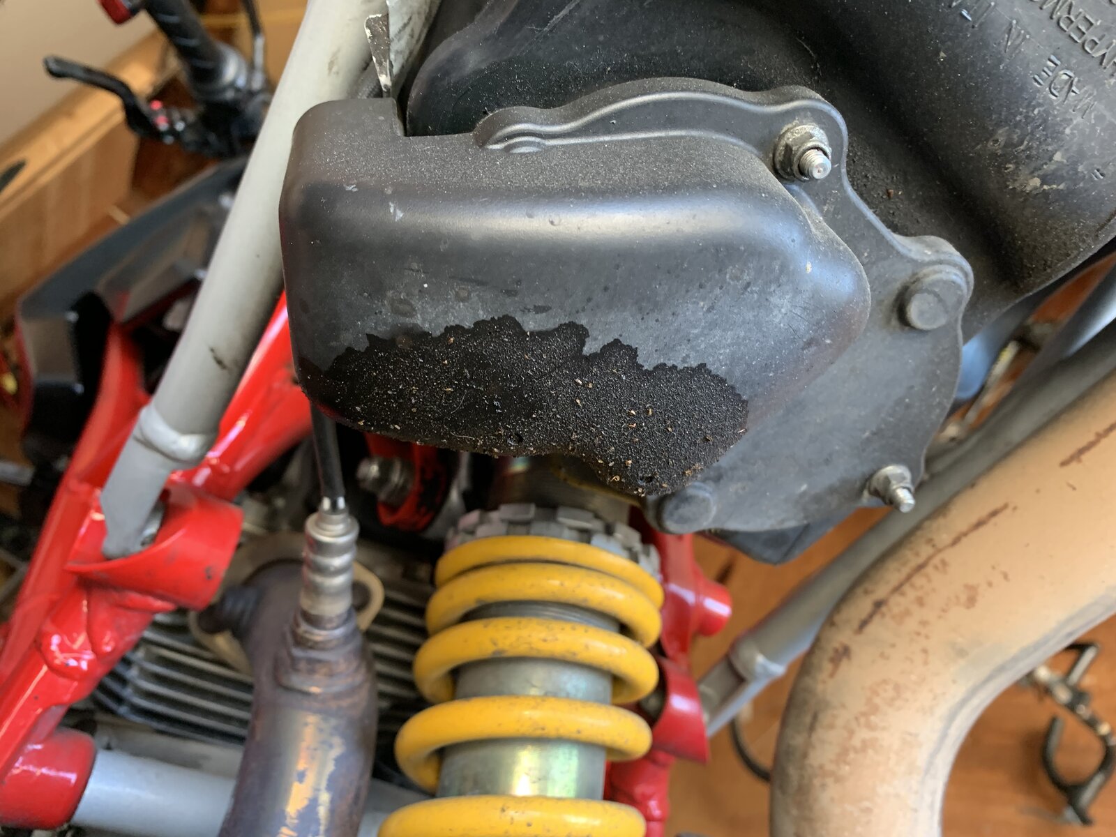

  1. Thank you for your explanation and help. I went to take a photo of the fuel pump leak.
  2. Samzero - did you realise that the black plastic part (all gunky) is just a cover? Removing the nuts that hold it in place and taking the cover off will reveal the fuel line & electrical connections so you'll be able to see where your fuel leak is coming from. The pump/tank-seal/etc is secured by further parts.
  3. Yep, deffo a leak there. You need to sort that pronto IMO, fuel leaks in the vicinity of hot exhausts are not a good combination.
    On the bright side, I’d wager it’s one of the small o-rings on the fuel pipes that’s leaking and not the big green o-ring that seals the fuel pump assembly. Thus an easy fix.
    My wager is that a previous owner or mechanic has either nicked the o-ring when reinserting the fuel pipe or used a non-petrol resistant o-ring which has since deteriorated in the petrol and is beginning to break down. You need viton o-rings, petrol resistant synthetic rubber, but cheap enough.
  4. Yes now I do. I’ll open it up once I get back to it. I hope it isn’t something big nor costly. Fingers crossed
  5. I’ll definitely look into that. I’m hoping it’s something that would be done easily and inexpensively. Do you know the specs of those rings by any chance?
  6. Thank You so much for the source. Now I gotta figure out size to match and purchase. Of course gotta confirm first so I can’t wait to get home and do that.

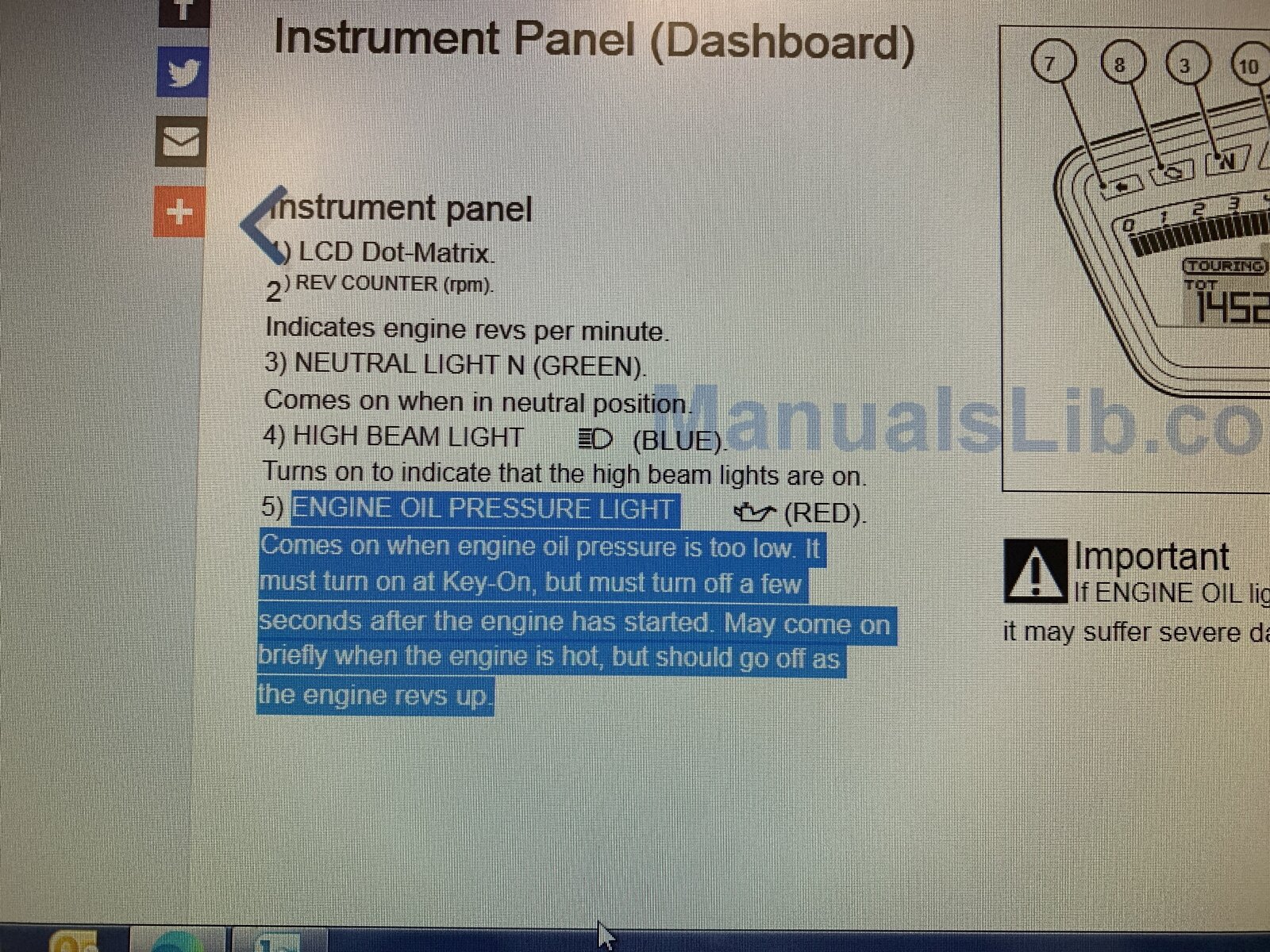

  7. Hmm so I just stumbled across this..
  8. Same as any 4-stroke engine ever to have an oil-pressure switch/light....

  10. It may well be the O ring, it could have been damaged on installation, with O-rings on fuel couplings I squirt a little White grease before press fitting on the coupling so as not to snag the O-ring.
  11. One size only. Just ask CA Cycleworks for fuel pipe o-rings, they'll know what they are.
