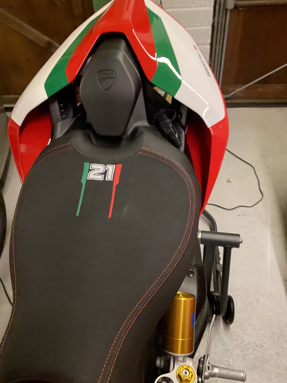

  1. Yes - the optimate lead plugs into the Euro 5 socket under the seat. you can buy the complete lead ready made for about £12 IIRC so I didn't bother making one. You can find the Euro5 pin out online quite easily if you want to make your own. I just brought the lead out under the seat to the rear cowl and used some velcro to keep it in place (in one of the vent holes) when I'm riding it.

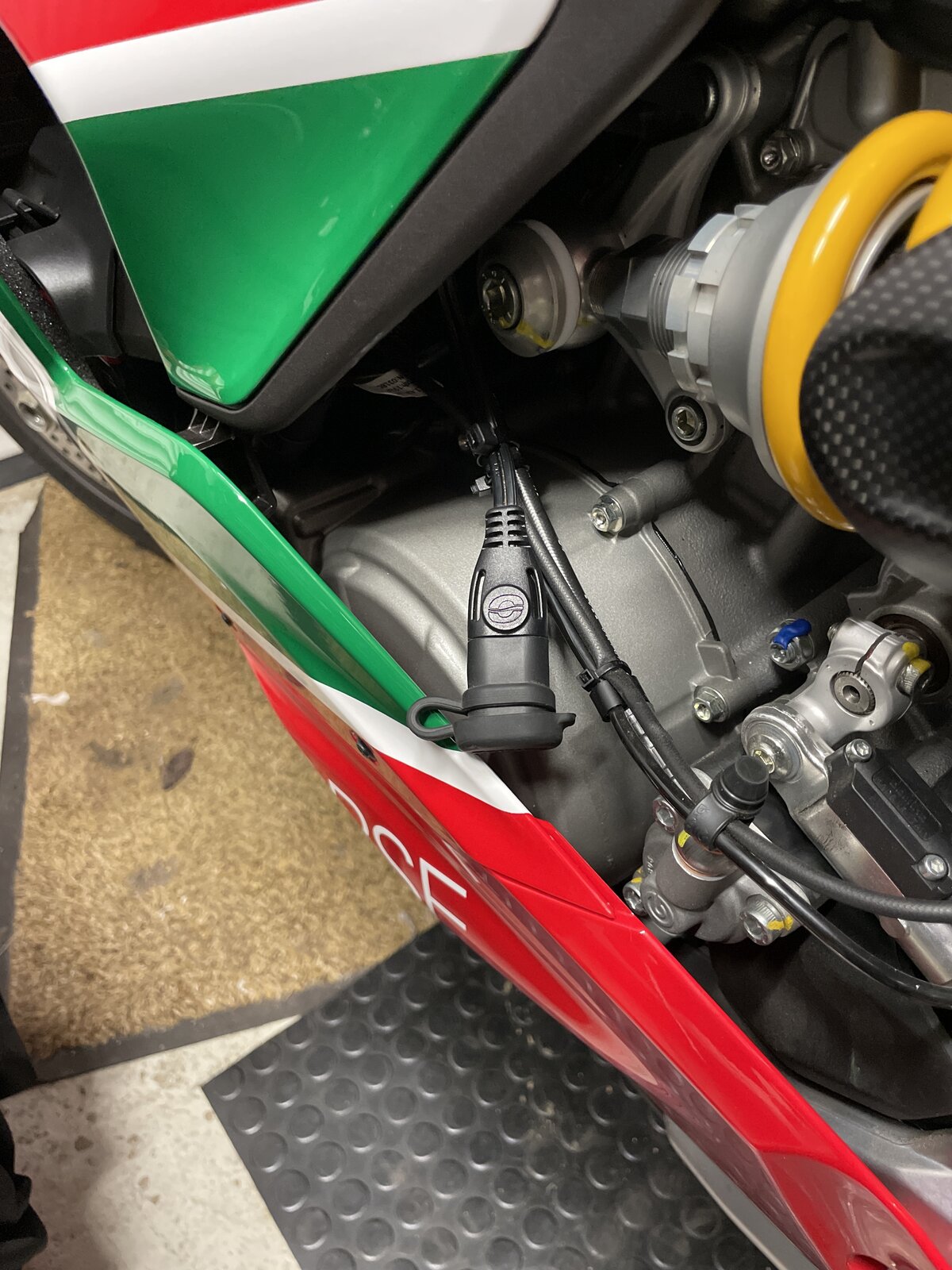

    Respectfully disagree with Jack about the neatness and convenience of running a fly lead off the battery - I'll take a pic of my installation 'cos I reckon it's pretty neat and I didn't have to remove any of the fairing panels to fit it.
  5. Looking forward to the pic. I did have it on my V4s and agree it’s obviously no hassle to fit. But it’s only the Lower fairing panel so not really difficult. I did mine in about 10 minutes. I will post a pic too and then there is a comparison.

  6. Image uploaded. Nice thing about this is I just connect the optimate to the rear so no cables to the side or around front of the bike - less to trip over in the garage!
  7. Nice bike :heart_eyes:

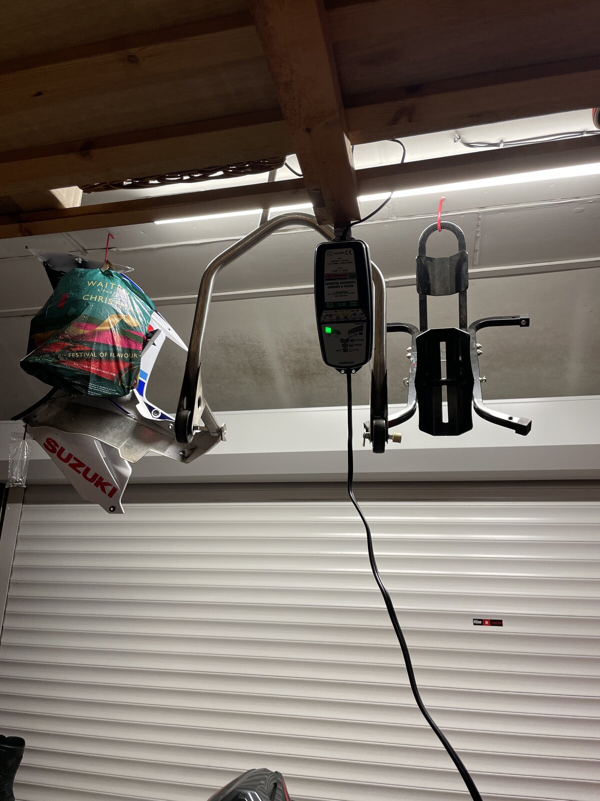

    Optimates up by the roof to avoid cables ;)
    I will stick with my setup I think.
  9. Yours looks fine as well - to each their own I think.
