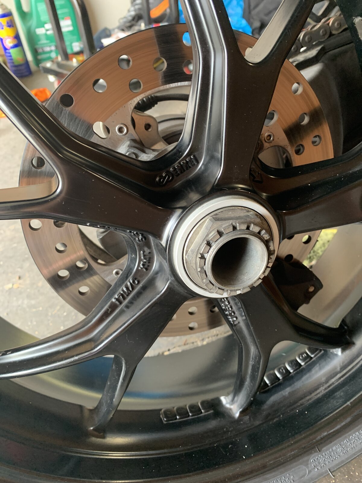

  13. Hello again. I’ve decided to replace the cushions. Now I’m curious for torque specs for 3 things.
    1. The cushion nuts
    2. The axle nut (left side)
    3. The wheel nut (right side)
    I couldn’t find anything online and I’ve been looking for manuals for the Hypermotard with no luck.
    literally last 3 things got to tighten and that part shall be done
    Thank you
  14. I believe the 41mm rear sprocket nut is 156nm the 46mm hub nut 176nm and the sprocket nuts 43nm. That’s what I’ve got written down for my Hyper 939 and 950, yours should be the same I would think.
