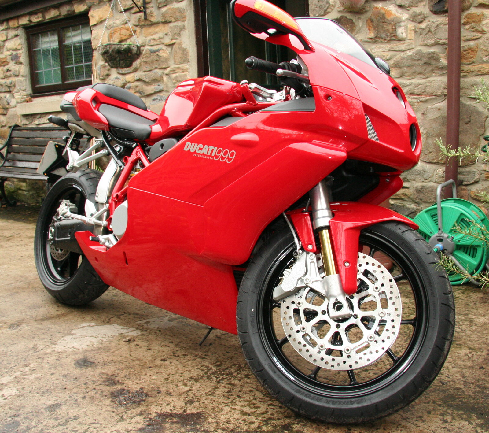

    If you have some extra pictures close to the wheel / discs / would be very handy..
    I see you have the 749/999 mudguard and callipers fitted..

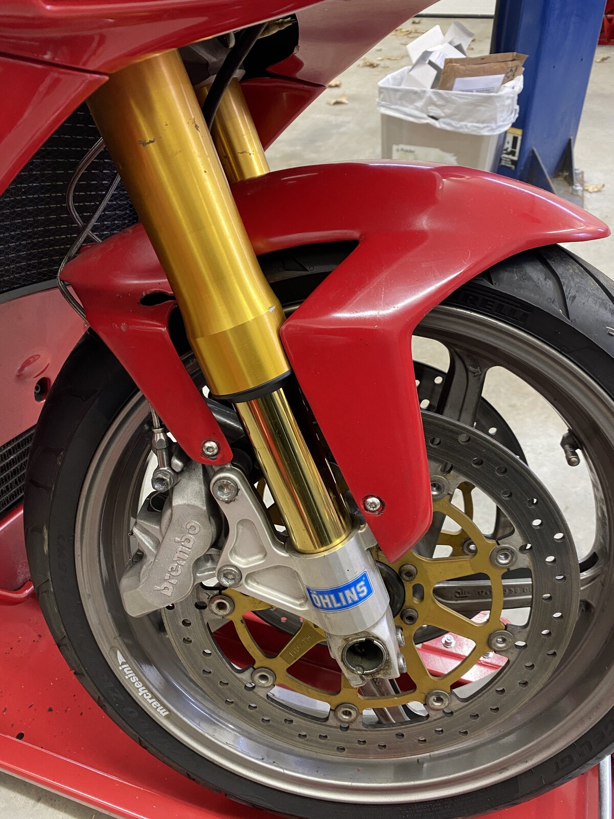

  2. Bringing this back... is this a standard 999/999S front fender (sorry, "mudguard")?
    The reasons I ask are twofold:
    1. It doesn't fit well (this is true of other stuff on the bike too); it's clearly been rubbing on the stanchion in a couple of areas
    2. I'm going to replace it with a CF jobbie at some point but would prefer the 916/996/998 shape. Can you fit a 998 fender on a 999 fork?
  3. The leak on my 1198S Ohlins was cured by using a seal mate.

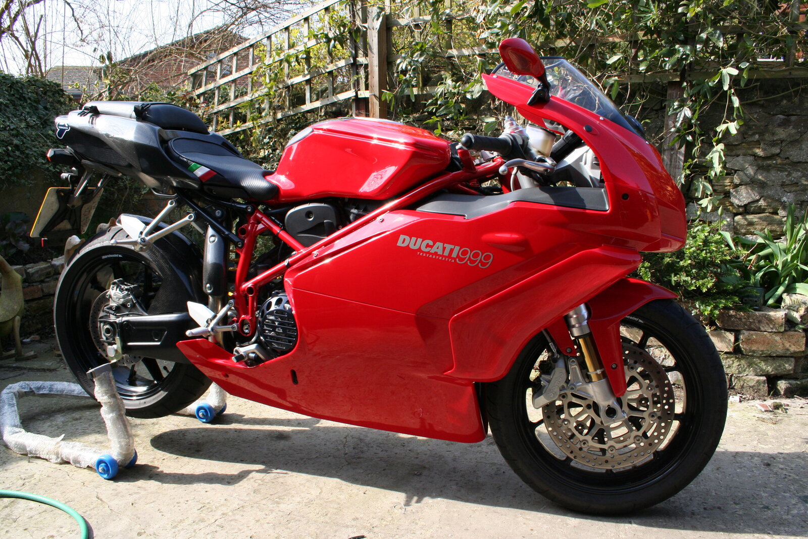

  4. It looks like a bit of a gash copy. Heres a pic of my 999 look how close tge mudguard is to the tyre compared to your pic?
  5. That's the standard 'guard for the gen 1 749/999. Gen 2 is the one in Macca's pic. Either will fit either bike.
    But yours looks like it could be an aftermarket one which is a poor fit.
    I think the mounting points are different on the 916 etc.
  6. The bike has an aftermarket tail fairing so it's possible it has an aftermarket front fender too.

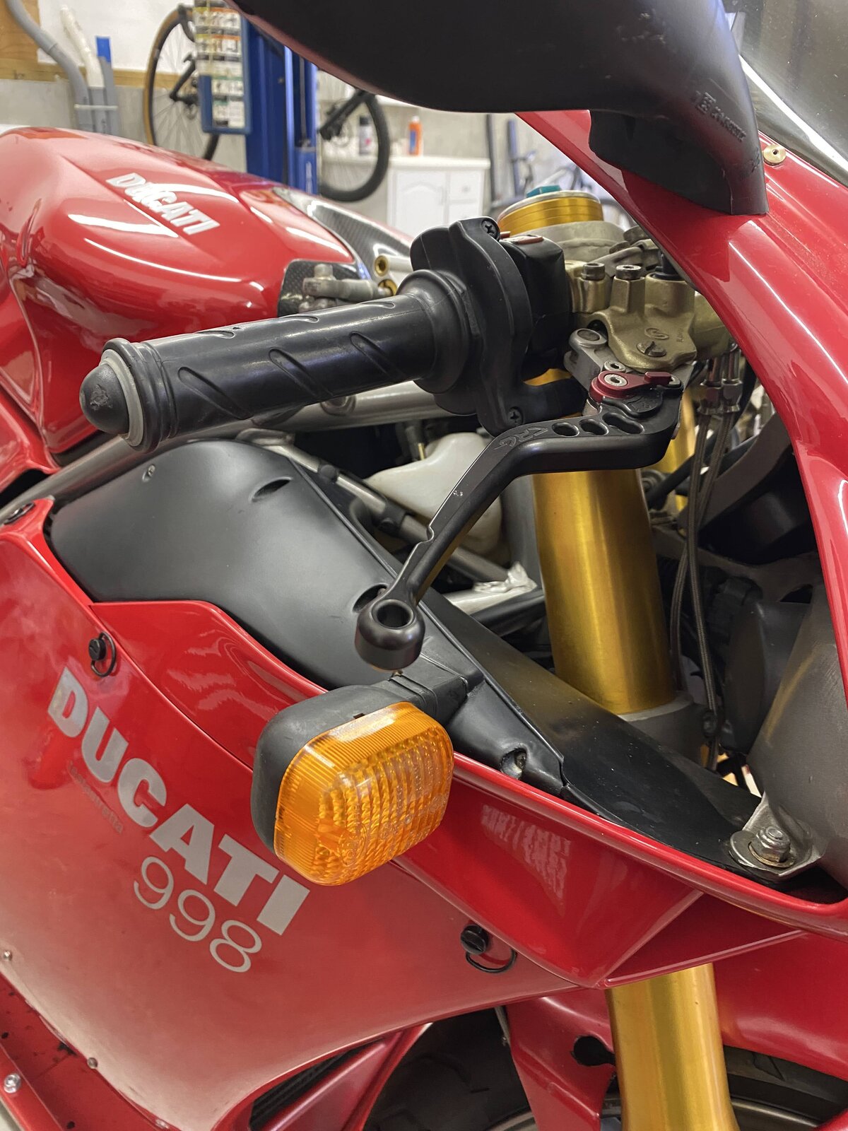

    Last questions in this thread, hopefully:
    Is this the factory 999 master cylinder? I couldn't find good eBay photos to compare against:
    Are these the factory 999 calipers? They certainly appear to be:
    The brakes are quite spongy. I'm sure they need to be bled, but before I start I want to make sure I have the right parts on there.
    #28 number9, Apr 5, 2021
  9. I recall 999 M/Cs being silver in colour Radial M/Cs IMG_0699.JPG with a coffinesque fluid pot (not remote). Or those on my Mk11 were.
  10. Not 999 brake master. Callipers look 999.
  11. Thanks Macca; I thought they were an updated style compared to 916/998. Is this what you were thinking of? eBay link.
    My goal isn't to to take the 998 back to stock. But if the 998 and 999 master cylinders have different pushrod lengths or ratios (because the calipers are different), I do need to use the correct MC for the application.
  12. Yup that looks to be a 999 m/c .
    • Disagree Disagree x 1
  13. no its an earlier 996/ 998 axial master, 999 masters are radial and silver
    caliper are 749/999 but that model were also fitted to the 998s albeit in gold
    the 998s uses that combination of the same axial master and P4 calipers
    iirc the axial master is 15/16mm the radials are 18mm
