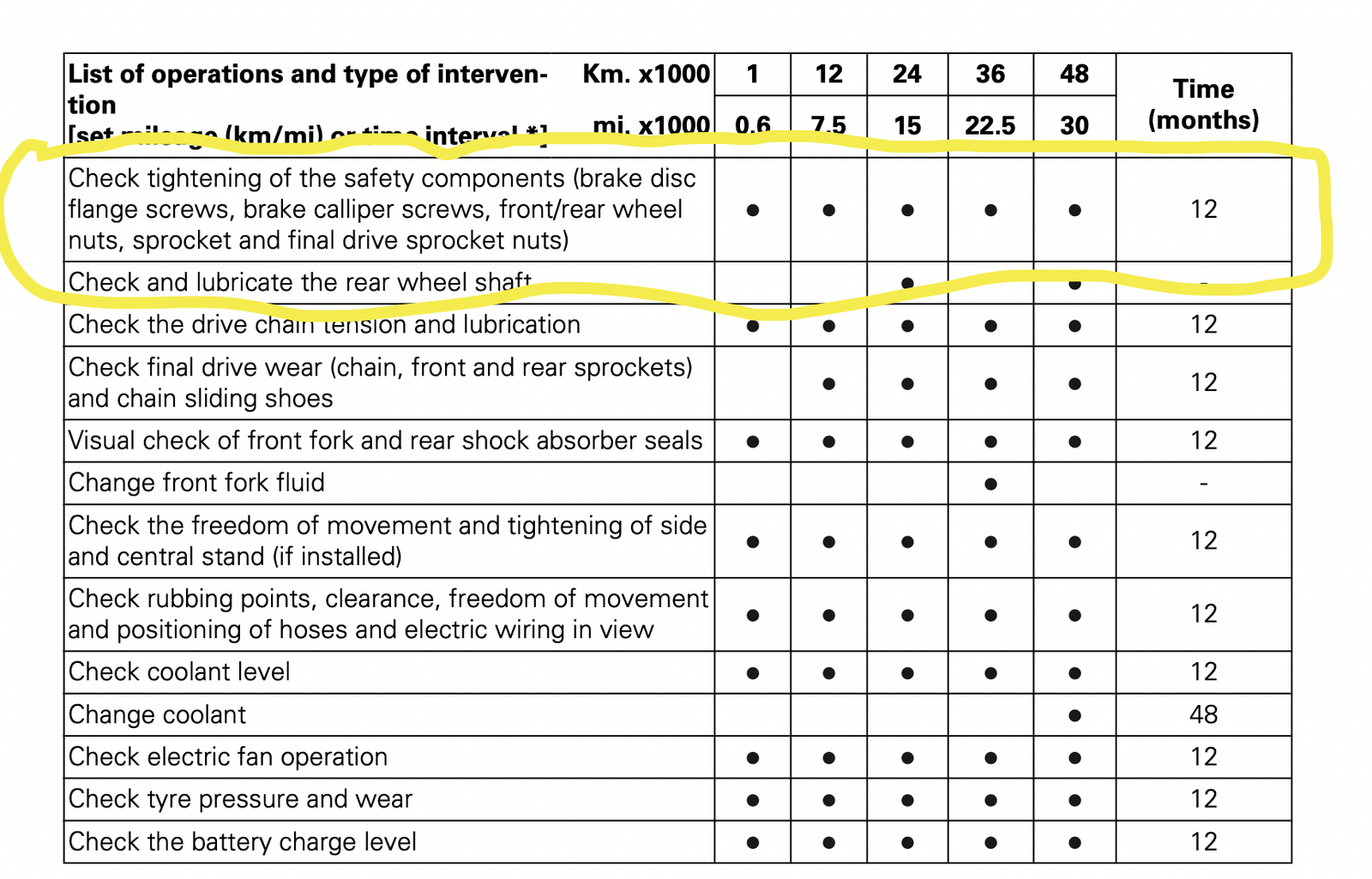

  3. Am I alone in thinking that Ducati should have informed all owners that the disc bolts should be checked?
  4. Its an owners responsibility to ensure his bike is roadworthy. Any bolt has the ability to unwind itself in the wrong circumstances.
  5. Yes.
    :joy::joy::joy::joy::joy::joy::joy::joy::joy::joy::upyeah:
  6. You’re right, never have I owned a bike where the disc bolts need checking. In fact when I’ve changed discs on any other bike, the fekkin bolts have never wanted to come out without heat & serious effort!

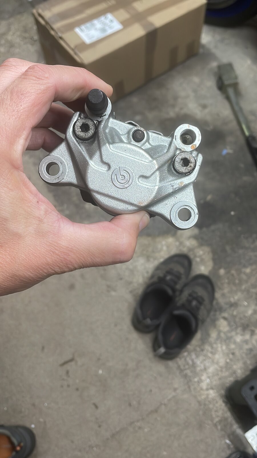

  7. Does anyone know what the difference is between the calipers from the 12 to 14, as there’s one on eBay, but they are different part numbers?
    Looking at discs, is there any other options for the ABS ring to be fitted - all the discs I’ve looked at don’t seem to have the holes for fitment.
  8. I no longer have my 2014 MTS1200GT, but a quick check lists the part number for the rear caliper as: 61140311A, and this seems to be the same for a number of 2012 & 14 Multistrada models.

  9. Thanks all, chap breaking a same year Multi has sorted me a caliper & hanger. :upyeah:
    Andy, thanks for the offer of the disc, but I will get a brand new - I’m assuming your track disc didn’t support the ABS ring?

  14. It is in the owners handbook in the service schedule- basically every service
  15. OK, you got me. The point I’m making is that if they felt the need to send out a service bulletin due to failures (which there’s been a few) why not send it out to owners?

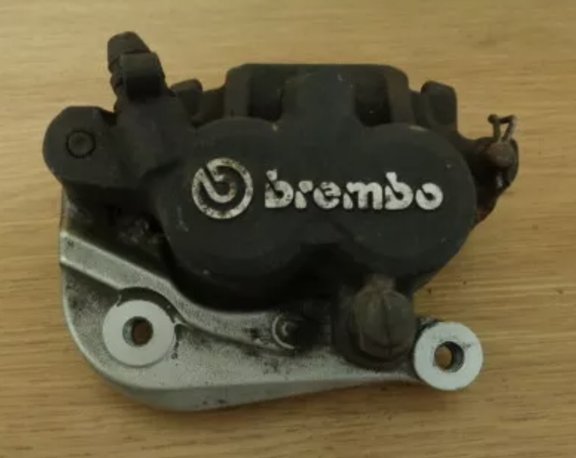

  16. I’ve just received an axle complete with disc, but the disc is the later 165 dia item. I’m assuming the later caliper (black caliper) has an adaptor to give the clearance as the caliper bracket is the same part number for all years?
    I know the calipers themselves are different!…… handy as I’ve just bought this one :confounded:
