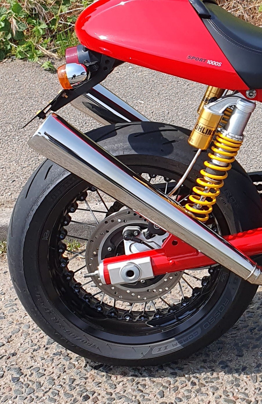

  8. I was looking on their website and I believe they are supposed to be designated ‘TT’ (for tubed tyres rather than TL for tubeless).
    All the recommended tyres for this bike on the Pirelli website say TL… The Roso IV Corsa would probably be a good tyre for spirited road use.
    Metzeler Racetec and Sportec have been mentioned by others.
  9. If your on standard wheels then you need tubed tyres , there are kits that seal the spokes that penetrate the rim but I'm not sure if this allows the use of tubeless tyres. Kineo build spoked wheels that allow tubeless tyres but at a high price.
    Beautiful bike by the way, enjoy yourself.
  10. Thanks, I can’t wait to get it. Alpina are decent value.
    The tires people seem to be using are not listed as tires for tubes, but the tyre manufacturer’s websites recommend those tires when you select this bike.
    :confused:
  11. As I understand it you can put tubes in tubeless tyres but it can be an absolute bugger to do due to the much stiffer side walls.
    They had this issue on the Darmah front wheel with a Conti Road Attack 3.
  12. Ask Fraser for some detailed pics of his kineo wheels.
  13. I bought a nipple sealing kit from Japan for these rims. Allows tubeless tires to be fitted. (Or the Heath Robinson method is DIY sealant on each nipple on the backside of the rim.)
    Kit here: ebay listing
    (you will need to search for your specific size rims)

  15. And what exhausts are those? they look like the contis of old.
  16. Those are exactly what I have on the old Darmah which fitted to it when I bought it in the early 80s. Stainless too.
    Nice...
    Real contis, if you can find them, go for ludicrous amounts.
