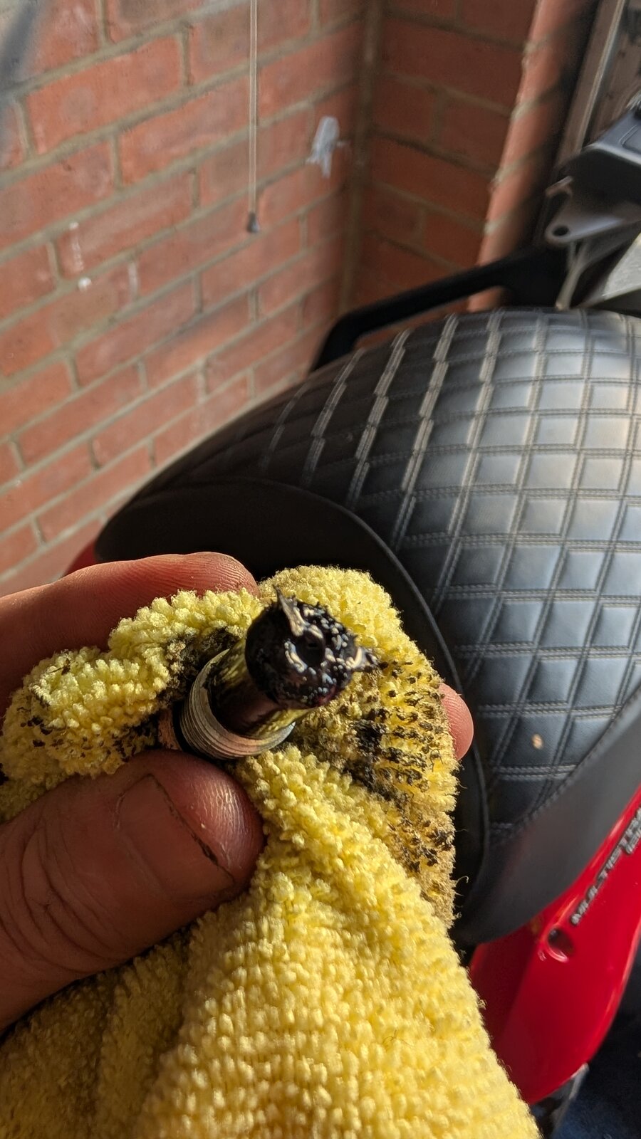

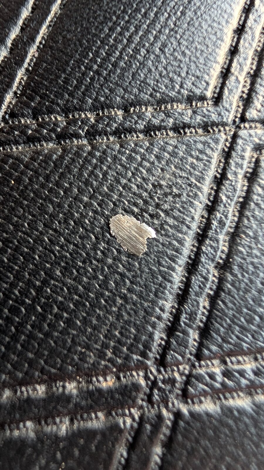

    How do you say "oh bugger" in Italian?
    Loads of shavings round the plug.... I've cleaned one of the bigger pieces up (pic 2)
  18. oh cavolo..
    Have you stripped an engine before?
  19. I think your bike needs major surgery. Like a new engine or major bottom end works.
    Shame.
  20. As I feared unfortunately, looks likely crank/ bottom end/ shells.
    Get it apart, it may not be too bad.
