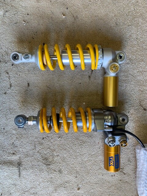

  7. If it helps i own a 2020 V4.... and have swapped the std shock for a ohlins GP, and the forks for FGRT 214 .....apart from that....
  8. Nevermind all that, what does the internet say?
  9. Heres the std sachs shock i took out versus the ohlins gp fitted.
  10. I took all the measurements of the sachs and copied it over to the ohlins..
  11. So if you could share the eye to eye lengths we can get an accurate measure to help the OP?
    And have a correct record to clear up the discrepancies in the reported measurements.....
    Then others searching the internet to find the answer would have at least one source with corroborated evidence.
