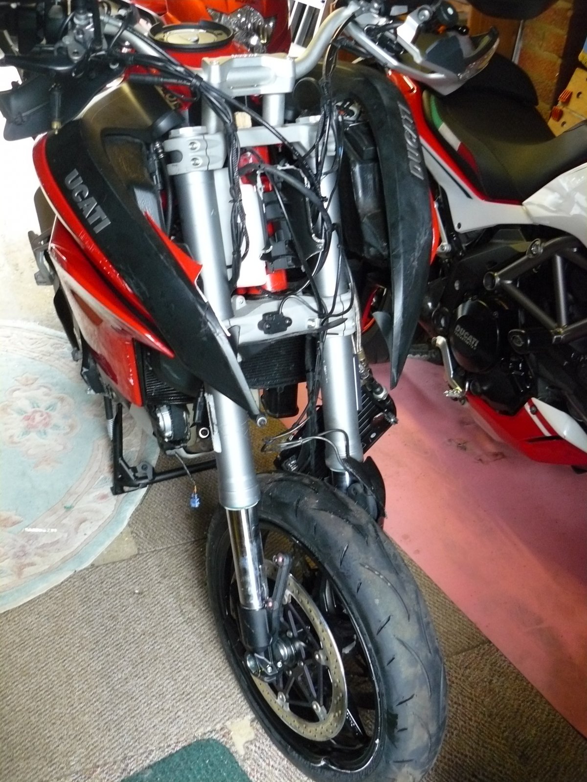

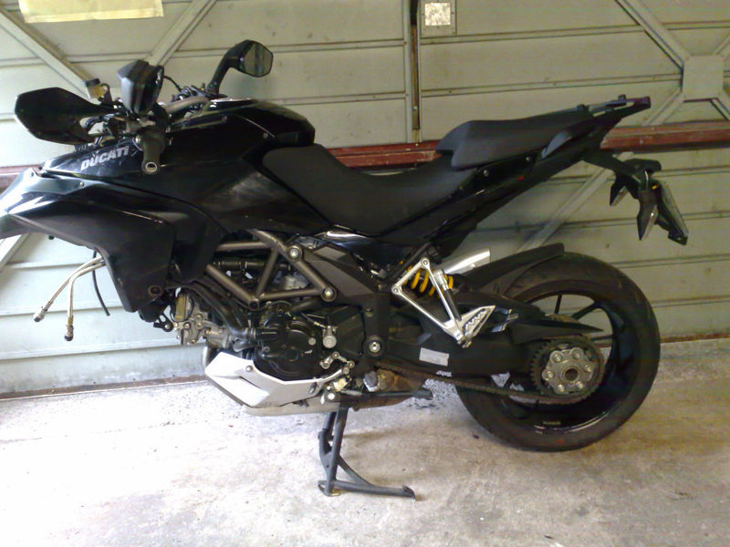

    Just to show as well I have worked on two other multis and a pic of this one I have now. The DVT forks yokes and wheel, although looking ok there, were all smashed. Its a repaired rolling chassis now, and brand new panels have all gone into be sprayed tri color again similar to my previous 2010 bike. Bit more swirly and fancy this time though. The black one was totally smashed, a real pain! The black is actually a Kawasaki blue that looks black, but in the sunlight really pops blue metallic!
    Ha! If only it would start!!!!
