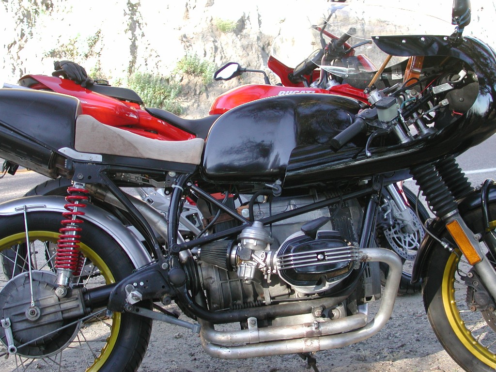

  2. Thanks for the continued help. I feel I'm getting somewhere, now.
    This morning I went out and measured what I have in the way of a fork/hub setup. Let me know if there's an important measurement needed.
    Axle diameter: 30mm
    Fork leg dia. at top yoke: 50mm
    Fork leg dia. at lower yoke 54mm
    Center to center of fork legs: 207mm
    From inside plane of axle hole to inside plane of caliper mount 11.6mm
    This is the offset, presumably not the same for cast wheels as spoked.
    Overall length needed from center of axle to top of leg 30-32" or 762-813mm
    Thanks again.
