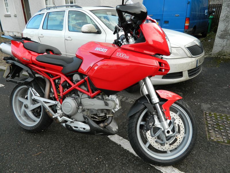

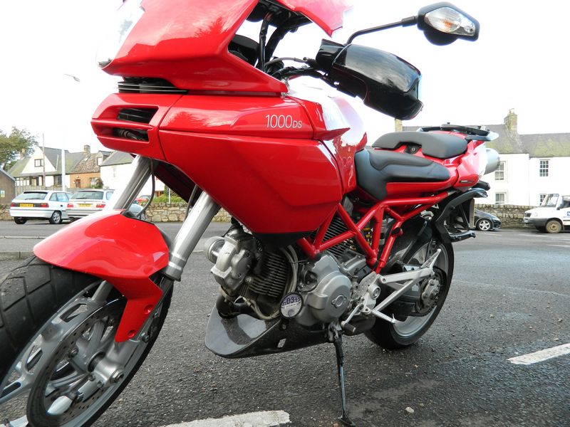

  5. My bike
  6. Same as mine:upyeah:

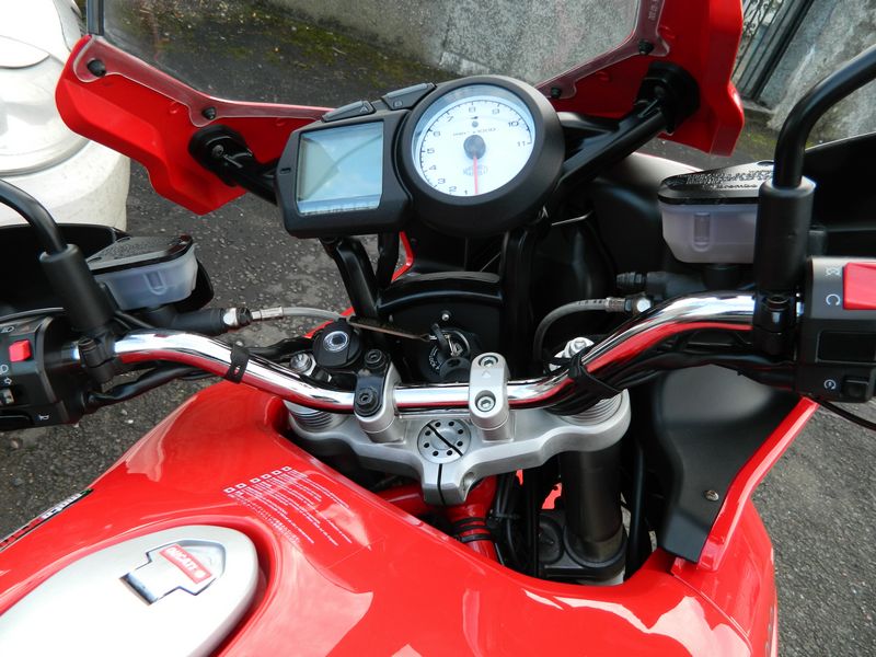

  7. Went out today for a wee ride and was crapping myself to be honest, but after 15 miles or so I started to settle in to the ride. Very happy the only thing is there's no gear indicator or am I not looking in the right place ?

  8. No gear indicator, you'll soon get used to the engine noise and know instinctively what gear you're in and when to change up/down. Big V-twins are never the easiest bikes to master, but the day you do get it you'll struggle to wipe the grin from your face.
  9. Gear indicator? What that?
    Pah. Another new-fangled widget.
  10. You have a gear indicator - it's called the rev counter - keep it on 3K and above and hide your smile or you'll look a little bit deranged ;)

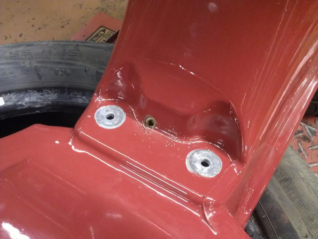

  12. Well here's the story, when the bike was delivered I thought I smelled fuel but couldn't see a leak and thought maybe it was just the delivery van. Took it out and all OK but could smell fuel in the morning, took it over to a mate of mines and the tank was showing empty! so filled her up. At my mates i could smell fuel but he said he couldn't!
    Anyhoo went home and had a good look and feel and there was petrol under near the seat, put a tray under the bike and waited till morning, and yes there was fuel in the tray called the dealer I bought it from and they said to book it into the nearest dealer which is in Glasgow, didn't want to ride it that far so this afternoon took it into Cupar motorcycles, they need to take the tank off etc but reckon there's some corrosion under the tank somewhere (I thought it was an O ring)

  15. Well the garage stripped the tank off and where you can see the small threaded hole is where the leak is. They took it to a shop which repairs such things but they weren't will to touch it.
    So the garage in Exeter have been informed, I wait and see ....
  16. The gear indicator is displayed on the lower left hand side of your primary instrument panel. If you can't see it then dont ride-you are technically blind :)

  18. Slickmouse - let me know how you get on. I've got a spare tank down the garage. It had warped so I coated it with Caswell (see multistrada.net for more details on this) - I've not put it back on as I bought a spare tank on German ebay for £200. The warping's caused by alcohol in petrol - most super unleaded fuels don't have alcohol, although Sainsbury's Super Unleaded and Shell V-Power do.
    How much did you pay for the bike?

  20. based on the front of the engine block that looks very tidy and not seen much salt.
    ds1000 is a brilliant engine, pulls and pulls. quirky looking beastie but the handling of multi is really something even fully loaded and 2 up
    reckon thats a great buy apart from your little tank issue
