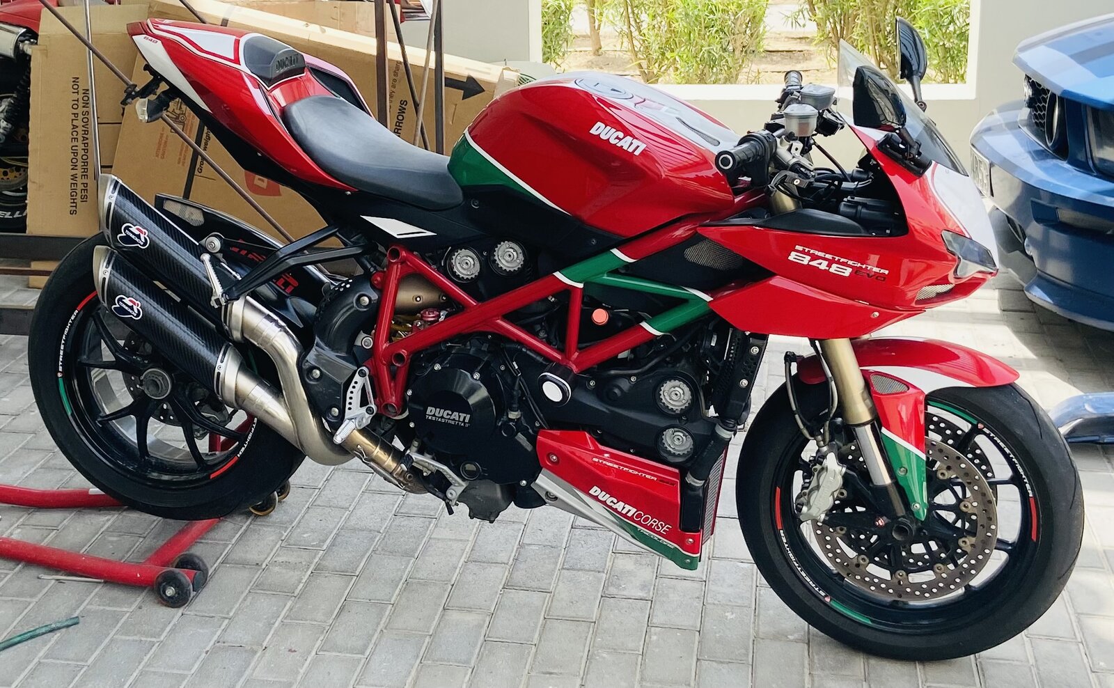

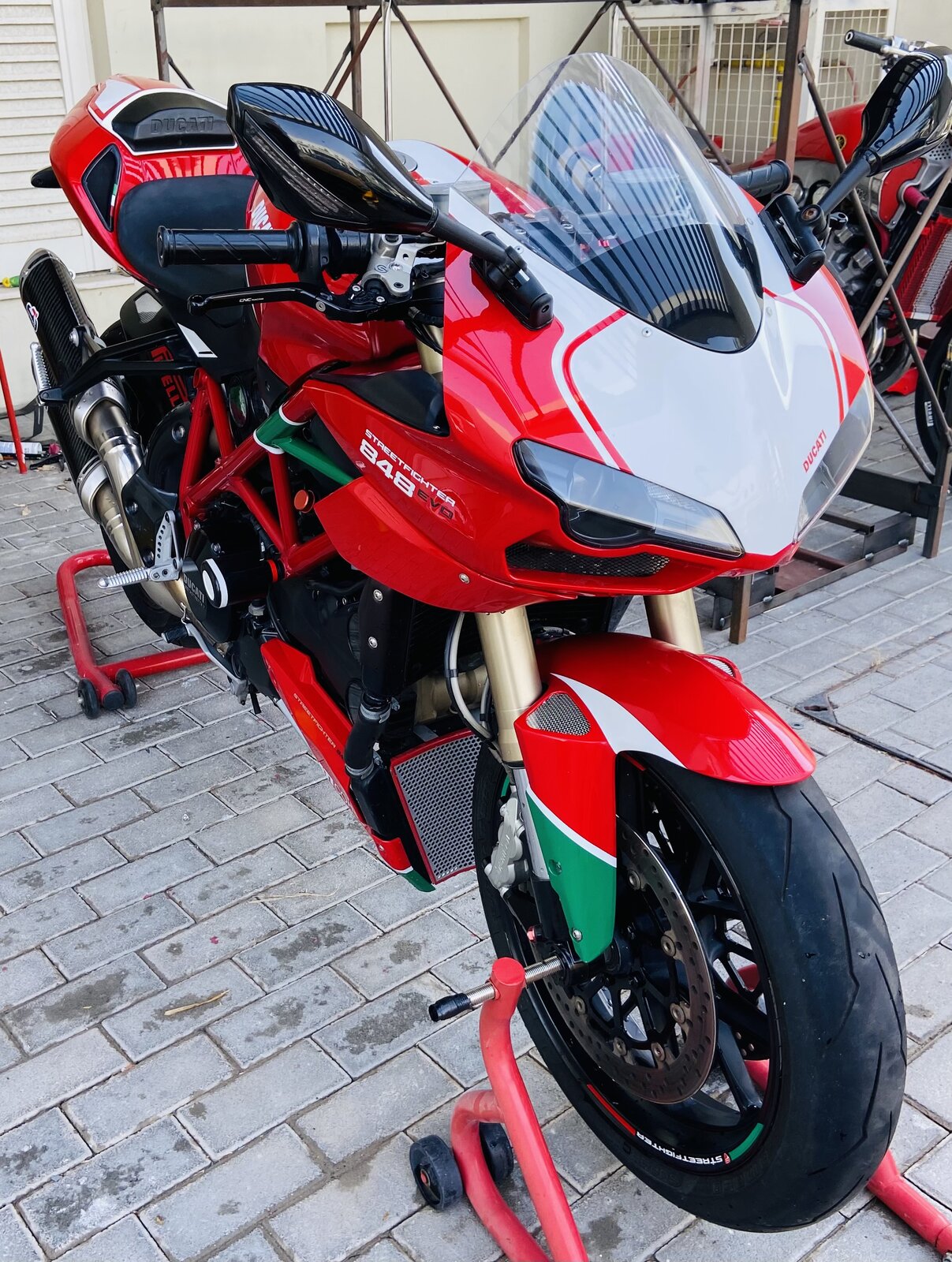

  4. It wasn’t easy, the Streetfighter frame doesn’t have the fairing stay mounting bracket welded on the 848 frame, so rather than welding one on and risking damaging the bearings I made up a U bracket that wraps around the headstock and bolts to the support. Very secure and means it can go back to stock.
    Headlight wiring is different, 848 fairing/screen is chopped back and infills cut/modified, flat bars needed to clear the fairing, fairing stay modified, lower fairings I fabbed from damaged 848 side panels off Fleabay.
